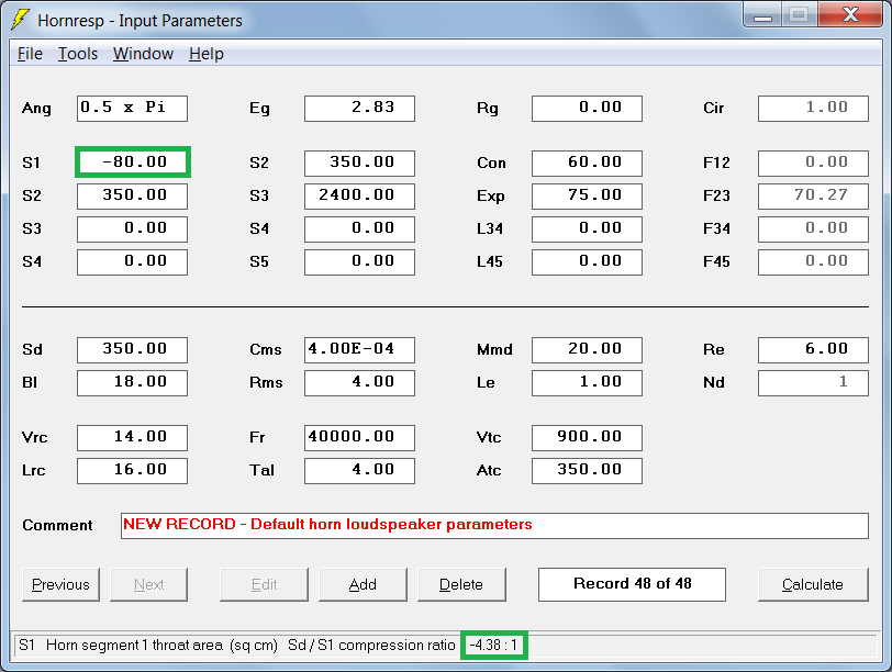

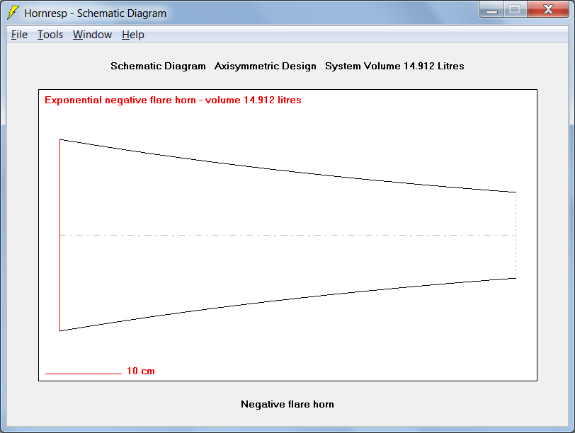

Negative flare is not an option! Awe man!!!!!
I guess if it was we might be able to find out if a horn could work as a vacuum?
Hi Mark,
"Negative" negative flare is not an option, but "positive" negative flare still is, of course 🙂.
Just set S2 < S1.

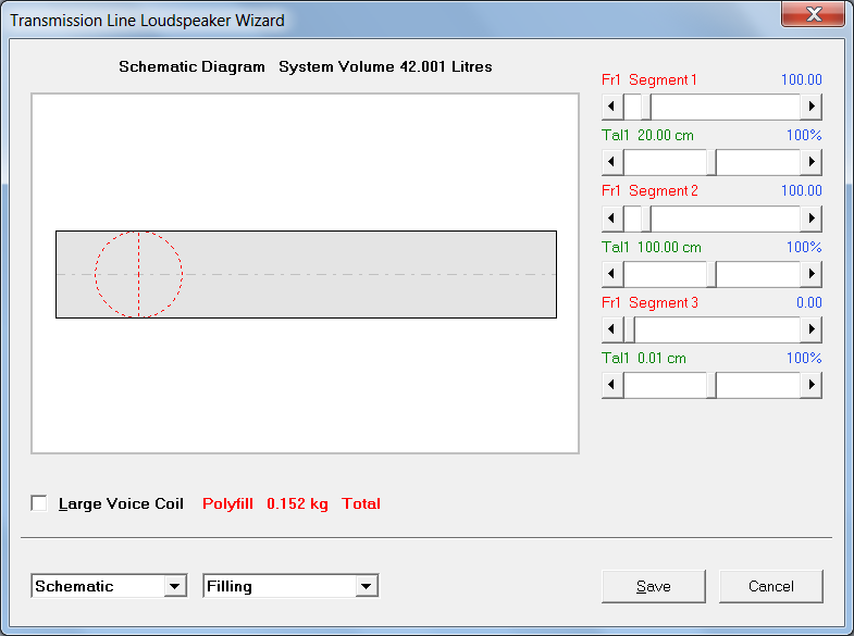

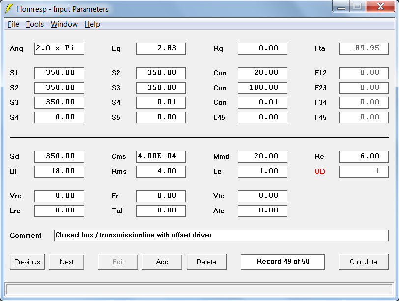

My dear friends, how to simulate the closed box with the driver offset, or closed transmission line with offset?
Hi mV8,
The arrangement shown below should get you reasonably close.
Use the Loudspeaker Wizard if you want to add absorbent filling material, and only consider the direct radiator output.
Kind regards,
David

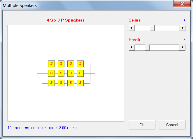

Hi SamAnytime,
If you have two identical horns, simply specify a single horn with double the cross-sectional areas and chamber volumes of one of the horns, keeping axial lengths the same.
Use the Multiple Speakers tool to specify the desired array.
Kind regards,
David

Hi SamAnytime,
Kind regards,
David
Thanks, David. Now how to drive the array using a single driver?
