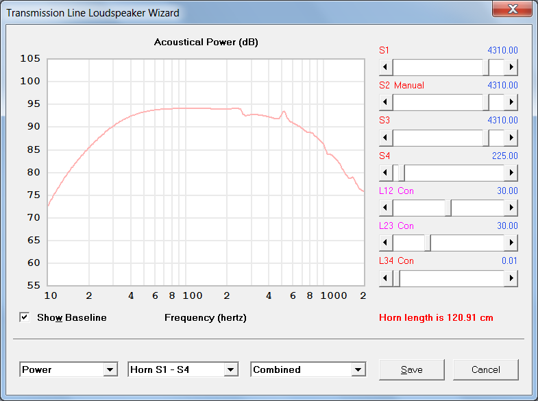

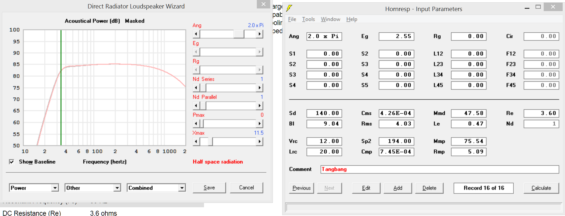

I was also thinking
Vrc = 0.
Lrc = 0.
S1 = box height x box width.
S2 = box height x box width.
L12 = box depth.
S3 = box height x box width.
L23 = 0.01
S4 = port height x port width.
L34 = port length.

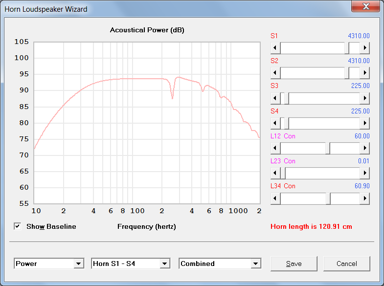

Hi BP1Fanatic,
Just to clarify - for the above model S3 = port height x port width.
Note that the results will be slightly different to those calculated using GM's OD model.
Attachment 1 = GM's OD model
Attachment 2 = your Nd model (with S3 = port height x port width)

Hi BP1Fanatic,
Kind regards,
David
Thank you for correcting S3 for me!
GM's graph definitely looks a lot better than mine.

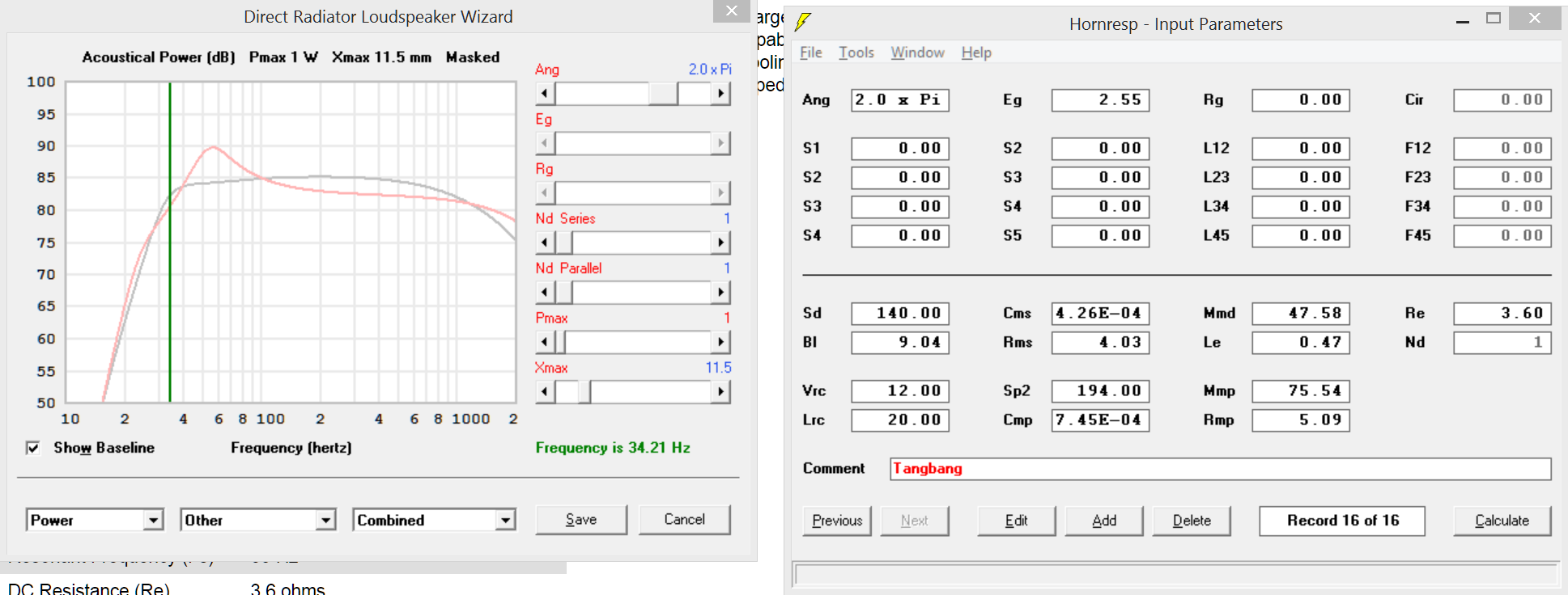

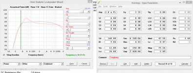

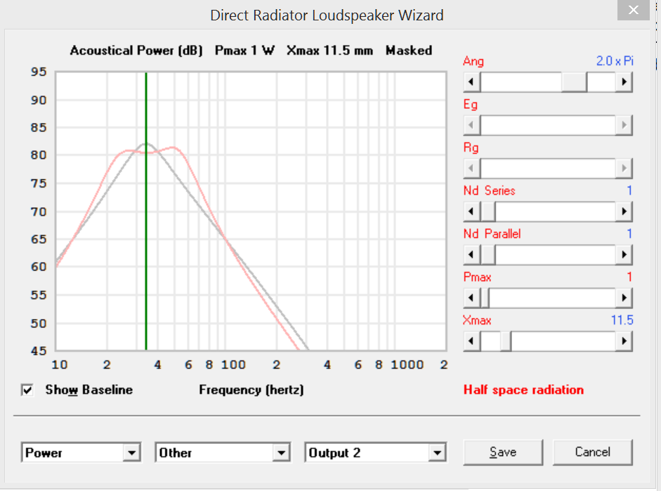

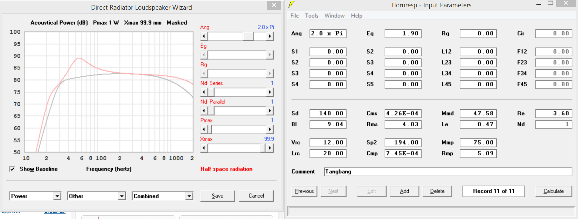

speaking of PRs, it seems to behave oddly when you vary the power applied, output2 seems to deform completely.
Hi 3ll3d00d,

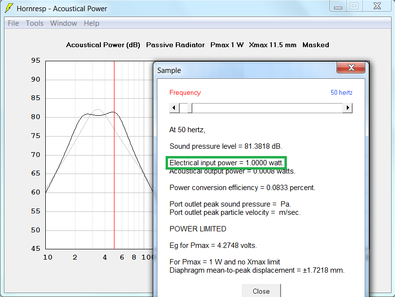

That's because when Pmax = 1 watt, and assuming that the system is not displacement-limited, the input power is 1 watt at all frequencies. When the Maximum SPL tool is not activated, and assuming that Rg = 0, the input voltage Eg is 2.55 volts at all frequencies, with the input power varying depending upon the electrical input impedance.
Attachment 1 shows the input power at 50Hz when the Maximum SPL tool is not activated, and the input voltage is 2.55 volts.
Attachment 2 shows the input power at 50Hz when the Maximum SPL tool is activated, and the input power is 1 watt.

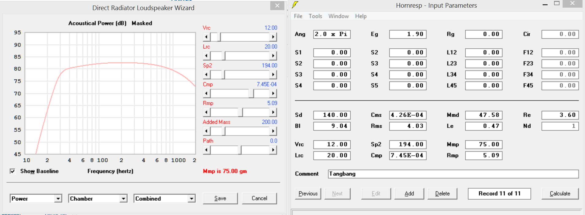

Is there a way to vary power applied (in the "not maximum spl mode" style) in the loudspeaker wizard? I was trying to look at the displacement of a PR with weight applied. It seems the only way to add weight is via the loudspeaker wizard but that's the only power slider available. Should I experiment with weights in the filter wizard and then add the final value to Mmp in the main screen in order to then look at PR excursion?
Is there a way to do excursion plots at maximum SPL after you have set up a filter in the filter wizard?
Hi Mark,
Not that I am aware of.
Kind regards,
David

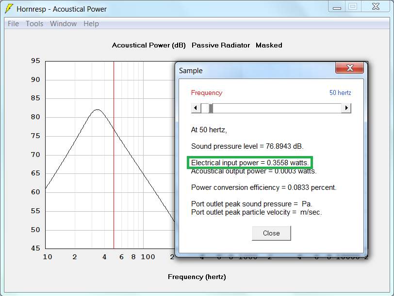

Hi 3ll3d00d,
Set the Xmax slider to 99.9 to prevent the results from being displacement-limited, and then vary Pmax as desired.
(Click on the Xmax slider, type 99.9 and then press the Enter key to set the slider value to 99.9).
Kind regards,
David

Thanks. I suspect there is something I'm fundamentally misunderstanding about the effect of this control. Is this the behaviour you'd expect from applying this to a PR system? If this is the expected behaviour, what does one use this functionality for? Does the discussion that starts around http://www.diyaudio.com/forums/subwoofers/119854-hornresp-33.html#post2464513 cover it?Hi 3ll3d00d,
Kind regards,
David
PR with some mass added in the loudspeaker wizard.
Now set xmax to 99, double click pmax and set to 1W
Hi 3ll3d00d,
See the Maximum SPL section in the Hornresp Help file for further information.
Yes.
People use it to get a sense of the overall maximum performance envelope of a given system (as limited by Pmax and Xmax). The feature was specifically requested and included way back in Version 13.00.
Yes.
