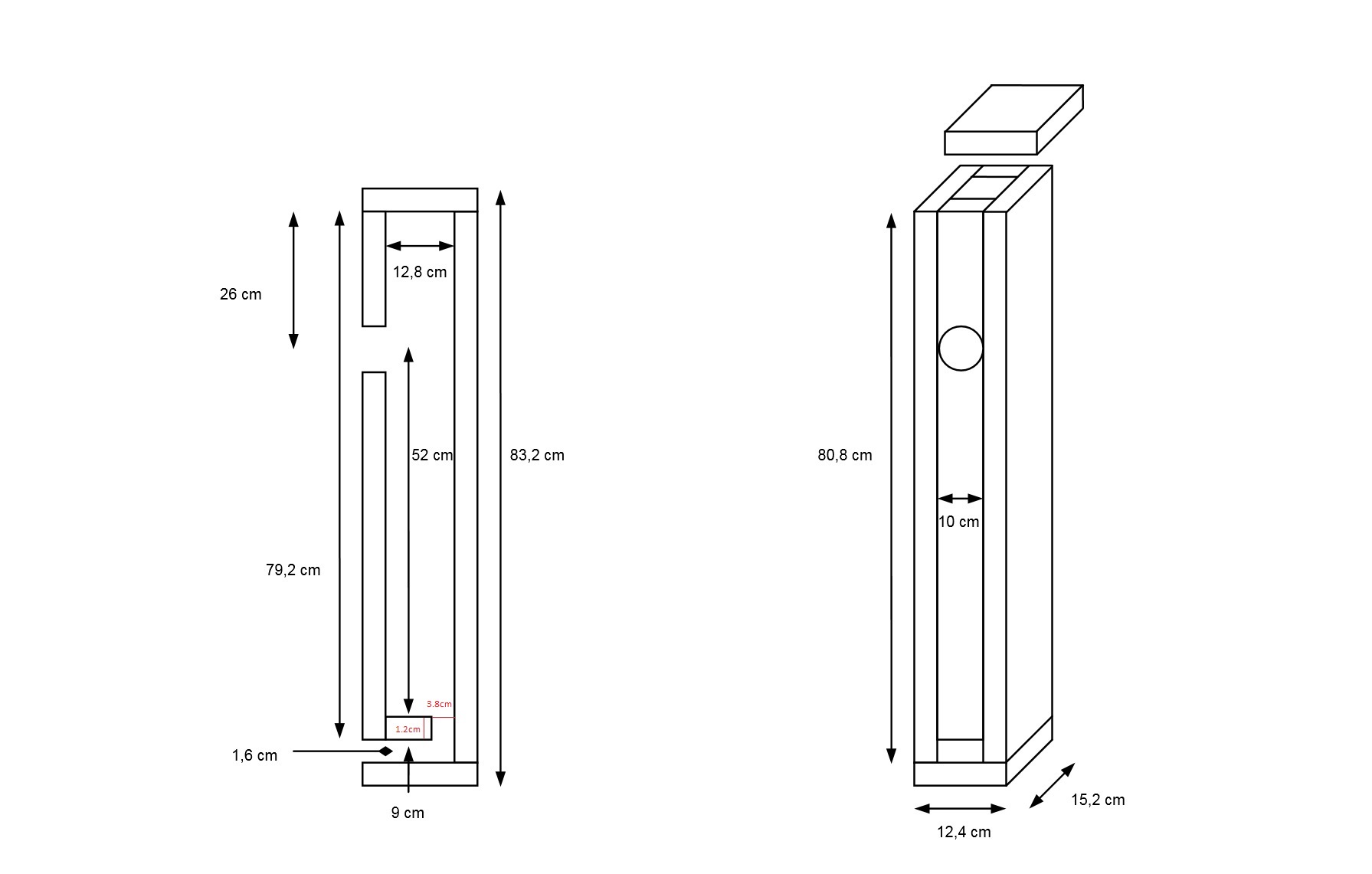

Thanks for the links, the latter I have viewed. From looking at the various horn configurations, I thought the design was most closely represented by the offset horn. But as your first link defines trapped horn as those that have the driver part way along a horn segment I guess this also applies to the design.
Hi CUTTING EDGE CNC,
A possible alternative model could be as shown in the attachments.
Kind regards,
David
EDIT - Use the Loudspeaker Wizard to add the necessary absorbent filling material to the transmission line.
Thanks very much David. I have attached an edited drawing showing the dimensions of a section 3.8cmx10cm and 1.2cm long. Could you please let me know if this should be represented as a horn segment or not. and if so, if there are more than 4 segments, how is the data entered?
Ideally the 3.8cm x 10cm x 1.2cm duct volume should be modelled as a separate segment, however because Hornresp is limited to four segments it is necessary to make a simplifying assumption, as bjorno has done.
In my example I simply used your 10.2cm figure for the final segment length without checking the dimensions on the drawing. Somewhere around 14 cm would appear to be a more accurate figure to use, as shown by bjorno.
Kind regards,
David
Just to clarify, the design in question is a mass-loaded transmission line loudspeaker, and should be modelled in Hornresp as an offset driver (OD) system, not a tapped horn (TH or TH1) system.

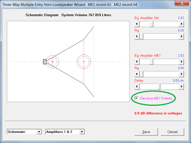

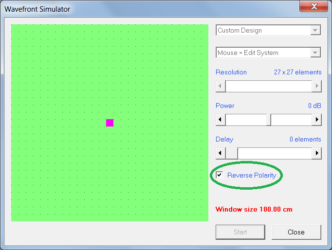

Hi, even with the latest version i've searched right through the HLP file, & cannot find how to reverse the polarity of a driver ! Apart from where it mentions it in the Wavefront Simulator, but i want to be able to do it generally.
Hi Zero D,
The polarity of a source / driver can be reversed in the Wavefront Simulator tool and in the Multiple Entry Horn Wizard, but not generally.
If you are seeking to reverse the polarity of selected drivers in either a multiple driver or a multiple speaker array, then for the results to be meaningful it would be necessary for the Hornresp simulation model to take into account the relative geometric positions of each of the multiple drivers or speakers in the array. This would require additional input data values, and would complicate things enormously.

OH, that's a pity ! Well can we reverse the polarity of Just one source/driver then, if not multiples, & if so how ?
What surprises me is, if it can be done for a Multiple Entry Horn, then that surely means it is Actually possible to do !
If you figure out how to include a reverse polarity option/s, this would be VERY useful to not only me, i'm Convinced of it. Please have a good think about it, @ your convenience of course ;)

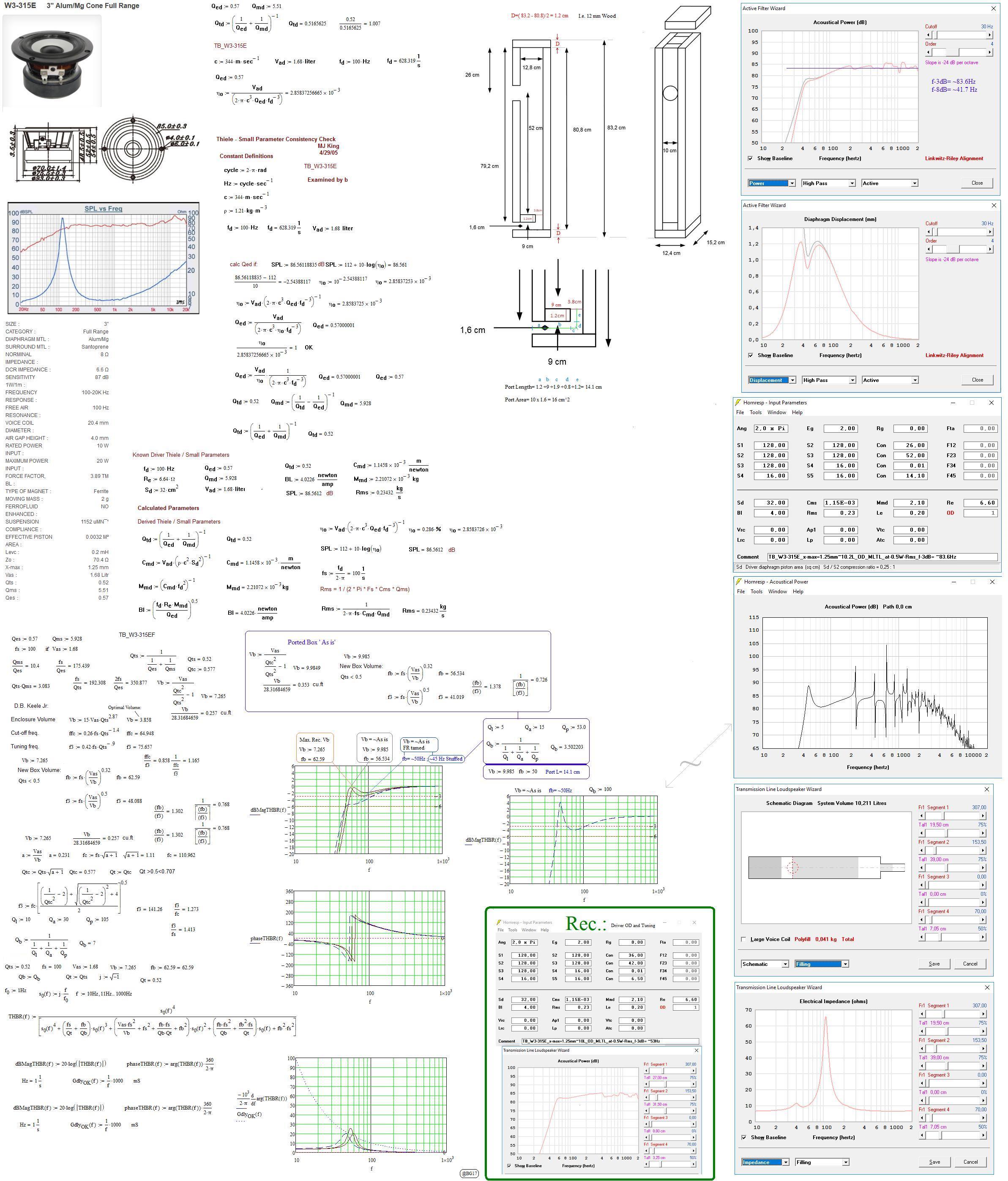

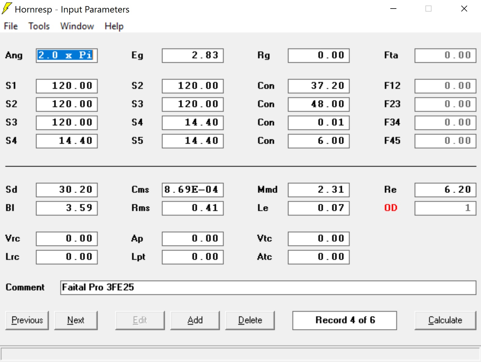

Hi Mark,
From your drawing I get a total center line length of 83.3cm. And a port length again by center line of 6.4 cm
I get a slightly longer length for L45.
To two decimal places, the drawing centre line lengths taken from the given drawing dimensions are:
L12 = 23.20 + 7.85 + 6.20 = 37.25 cm
L23 = 29.40 + 7.85 + 8.80 = 46.05 cm
L34 = 0.01 cm
L45 = 1.80 + 3.40 + 1.80 = 7.00 cm

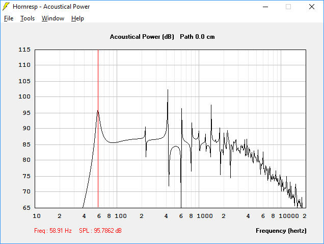

Have you looked at the response of the simulation?
As bjorno has shown in Post #6963, acoustical filling material / filtering will be required to achieve an acceptable performance.
Kind regards,
David
Your simulation as setup is a length of 85.2 cm and a port length of 6 cm.

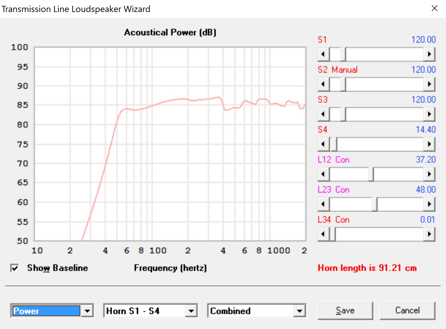

Thanks for looking at this, I thought the the transmission line wizard response with the filler dampening was the relevant graph in this situation.
I'll take another look at the dims of my diagram.

Hi Mark,
L34 = 0.01 cm
Kind regards,
David
David, thanks for pointing out these late night/hasty mistakes. I should really do this in the day!
Can I just check that the graphs generated by pressing calculate in the data input window do not take account of any of the filling used in the t/l wizard? If this is the case are the wizard graphs a more realistic response for a MLTL?

Hi Mark,
L34 = 0.01 cm
Serves me right. I looked at the port numbers I wrote down and sure enough made a mistake. Thanks for looking at it.
The stuffing issue is a given as it is a transmission line. The response question was rhetorical. I'm dumb, but not that dumb.;)
