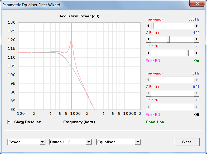

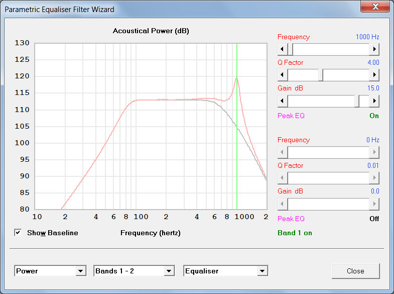

Previously in the Filter Wizard tool, when the green equaliser frequency marker was visible and the chart frequency range was changed, the frequency marker would become invisible even if the equaliser frequency was still in the newly-displayed range. The frequency marker now remains visible when the equaliser frequency is in the newly-displayed range, as shown in Attachments 1 and 2.

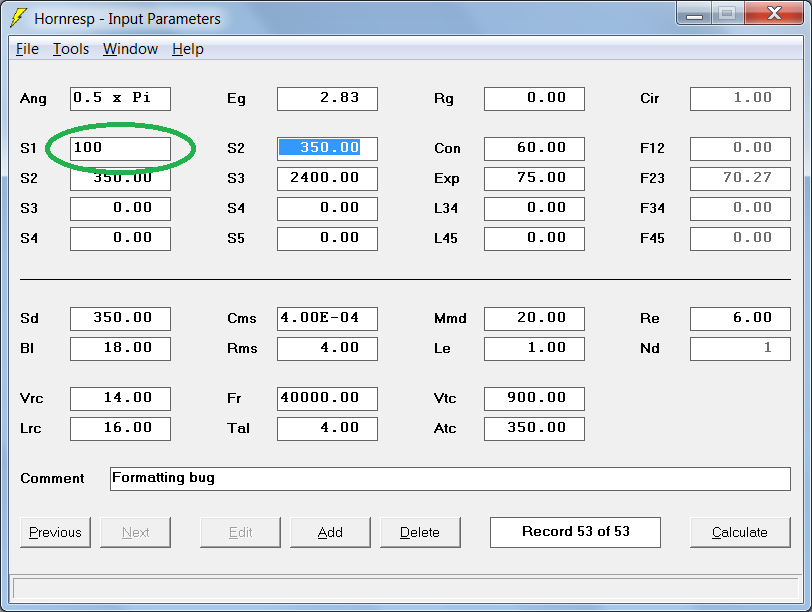

It seems that the second bug described in Post #5308 (Hornresp Update 3700-150309) was not completely fixed. Certain sequences of keystrokes could still result in values entered into text boxes on the Input Parameters form being incorrectly formatted - see attached example in Attachment 3. Hopefully the input data formatting problem is now (finally) fixed.
