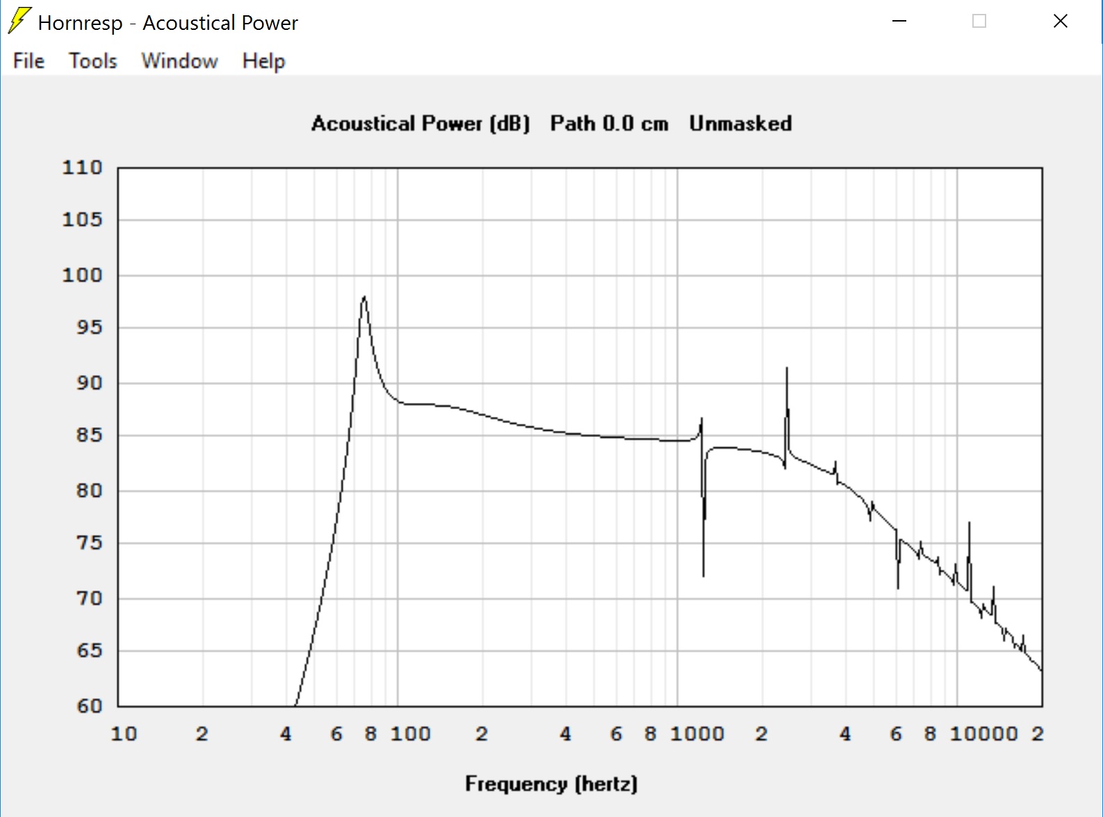

I Have just started playing with Hornresp and I hope to call on the knowledge of more experienced users. I have simulated a single driver in a vented box, and the FR graph is not consistent with the manufactures FR, or the simulation I ran with Bassbox. There is a huge dip in HF response in hornresp which is not present in either the manufacturers graphs or the BB simulation with the same driver and boc parameterd. I have attached screen shots from both.
The box is simulated as unstuffed, so what you are seeing is the result of internal box reflections. Though Hornresp may exaggerate their severity, they are a real thing. A moderate amount of stuffing should be enough to suppress them into irrelevance.
Try playing with the Lrc and Vrc parameters to see how internal dimensions (for the same volume) influence the result.
