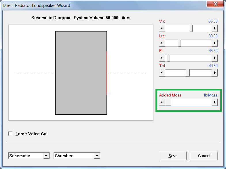

Hornresp Update 3980-160928
Hi Everyone,
BUG FIXES
1. The bug identified in Post #6681 has now been fixed.
2. In some cases the passive radiator mass slider was being shown in the Loudspeaker Wizard even though a passive radiator had not been specified - see attached screenprint example. This problem has now been fixed.
3. A number of other minor operating anomalies have also been rectified.

Wow that was a fast update !
I have been trying the added function of the PR in a couple of small boxes.
This week is a flurry of activity before I'm off to China so I have not been able to have real quality time with Hornresp.
That will be when I'm on the plane. 19 hours of fun in the sun.
I might be able to get to know the new features a little bit better!

Hornresp Update 3980-160929
Hi Everyone,
BUG FIX
The values of Ap1 and Lp (used to specify either a throat chamber port or a throat adaptor) were not being taken into account in the main calculations - only in the Loudspeaker Wizard.
I am quite surprised that no one noticed that the two sets of results were different, as the bug would have been introduced when Version 20.10 was released 🙂.
The bug has now been fixed.
I did, but with some stuff only displaying in the LW or seeming at different scales, just assumed this was just another 'quirk'/programing limitation due to being basically an outdated program/platform/whatever you call it.
Anyway, thanks for the PRs and all the other enhancements you said would either never or very unlikely be added, so now I can finally 'retire' my ancient LspCad program.
