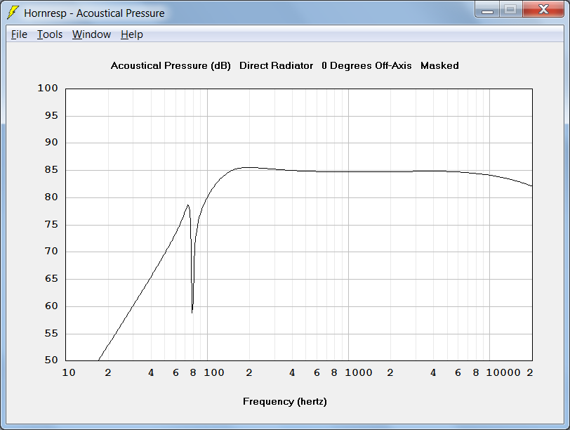

There is a huge dip in HF response in hornresp
Hi CUTTING EDGE CNC,
Hornresp is showing the power response of the direct radiator and port combined, not the pressure response.
The attached chart shows the on-axis pressure response for the direct radiator only, with chamber resonances masked.
Kind regards,
David
Thanks David, the pressure response curve is what I thought I was looking at, thanks for clarifying the difference. Thanks for putting such a great piece of software together.

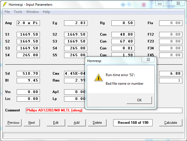

FWIW, even with updates, clearing out all traces [AFAIK] of HR, new installs, I'm still periodically getting the '52' runtime' error 🙁.
This time when I saved this file [created from an existing one by creating it in the LW, then adding a new file without 'saving' what I'd just created], looked up another one, came back to the 'File/Find' to call it up again and got it when I clicked on the 'Tools/LW' link. Clicked on 'Ok', Opened HR again and had no problems doing it.
This new laptop apparently doesn't like this sequence of events in some, but not all, cases...... 🙁 [picky sumbitch]

Hi GM,
Picky indeed. It seems that your computer just doesn't like you 🙂.
All the evidence points to the error being due to a machine problem.
Kind regards,
David
