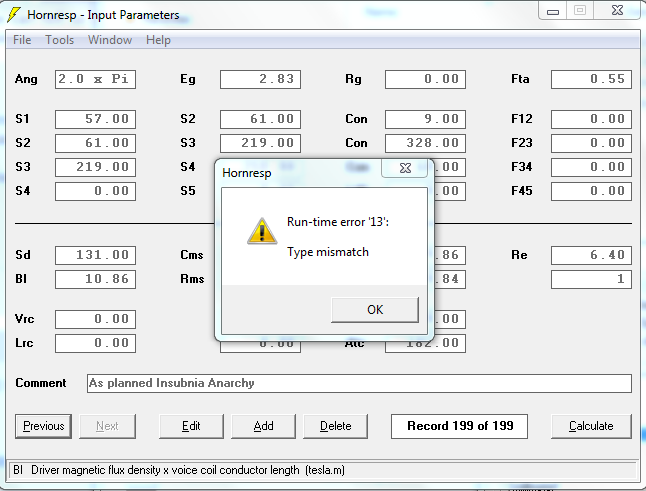

dunno what happened but I had an older version - when opening it today and trying to advance from one record to another, got a '13' runtime error and crash. Same happened when updating to the current version of Hornresp. What might cause it to error and crash ? data corruption ? - Microsoft update ?

Hi freddi,
From the blank input boxes, I suspect that your Hornresp.dat data file has been corrupted in some way. Unfortunately I have no idea how that could have happened. In all the years that I have been using (and deliberately abusing) Hornresp, not once have I experienced such a problem.
If it is not too much trouble for you, I would be very interested in having a look at your Hornresp.dat file to see if it can give me any clues as to what might have occurred.
Unfortunately it was only possible to recover 7 records out of the original 146 in freddi's file.
Me too when I downloaded a .txt file from a 5.4.2010 forum post and tried to open it. Ditto when I tried again on a re-boot.
It shows up in the 'FIND RECORD', but clicking on it just gets another runtime 13 error, so deleted it from the IMPORT folder and tried again with no luck, so now have two data files that need removing from the'FIND RECORD'.
Note that I do a 'sort' each time I add a file.
GM
I opened this anar.txt in hornresp (recent version) and got the some runtime error.
When I export a txt. file, it looks very different from the anar.txt version, instead of "comment" i find "com" and the filter section is not included in the text file. Importing a exported file worls fine.
GM
Hi GM,
Many thanks for this! Imported files should automatically update their formats as required, but when I added the passive radiator option recently I forgot to amend the import update code to take into account the new 'Added Mass' variable. I will fix the problem as soon as I can, but in the meantime I suggest that you do not import any more files - they have the potential to damage your Hornresp.dat file.
I don't think freddi's problem is related, but I cannot be certain any more.
If you care to send me a copy of your Hornresp.dat file, I should be able to fix it for you.
My apologies for any inconvenience caused.
Kind regards,
David
