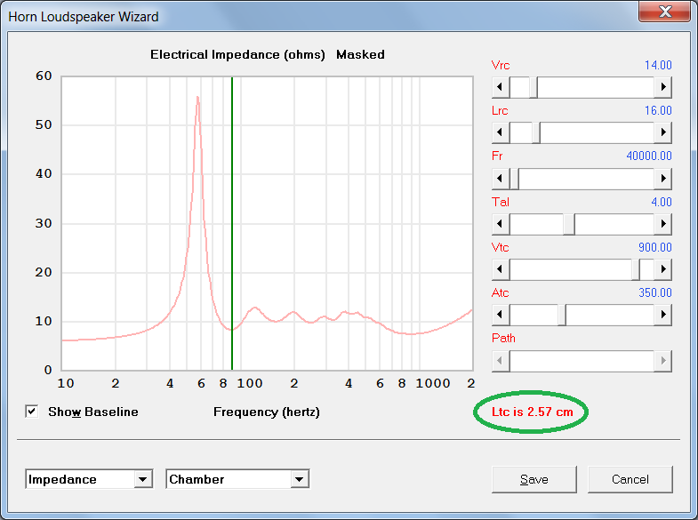

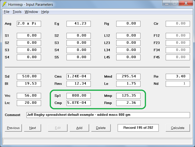

Hornresp Update 3980-160923
Hi Everyone,

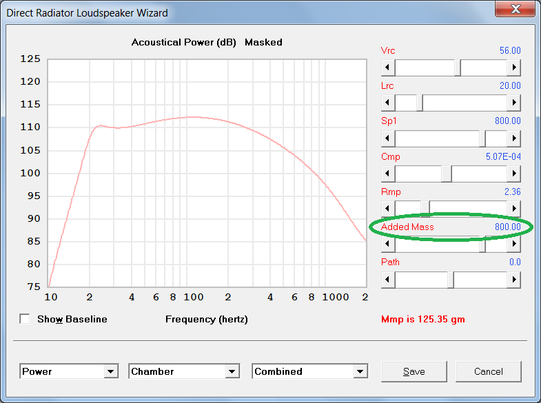

CHANGE 1
Passive radiators can now be specified. This feature was in effect requested by Mark in Post #6626. See the following sections in the Hornresp Help file for details on how to use the new passive radiator feature:
. Chamber Parameters
. Calculate Parameter
. Chamber Type
. Loudspeaker Wizard
. Direct Radiator in a Closed-Box Enclosure With Passive Radiator
The Hornresp Help Find tool in the File menu can be used to quickly locate 'passive radiator' references.
See Attachments 1, 2 and 3.

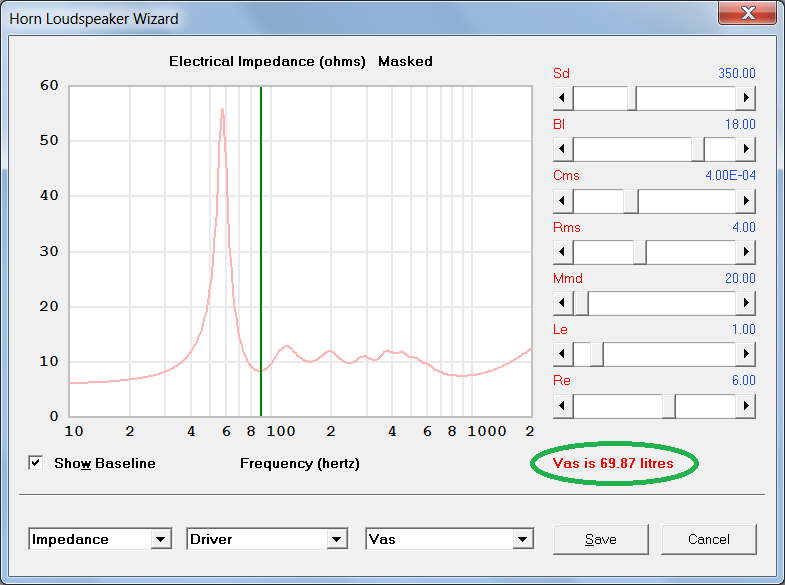

CHANGE 2
Moving the mouse pointer over the green-coloured principal resonance frequency marker line in the Loudspeaker Wizard tool now shows the frequency value. This feature was requested by Brian in Post #6635. The frequency marker line, previously only available on the Power chart, has now also been added to the Impedance and Displacement charts. See Attachment 3.
CHANGE 3
To overcome further issues arising from fixing the problem reported by just a guy in Post #6656, the Hypex Approximator tool can no longer be used when S2 is greater than 99999.99 sq cm (i.e. when the hyperbolic-exponential horn mouth diameter is greater than 3.56 metres).
Could you please report any bugs you may find.

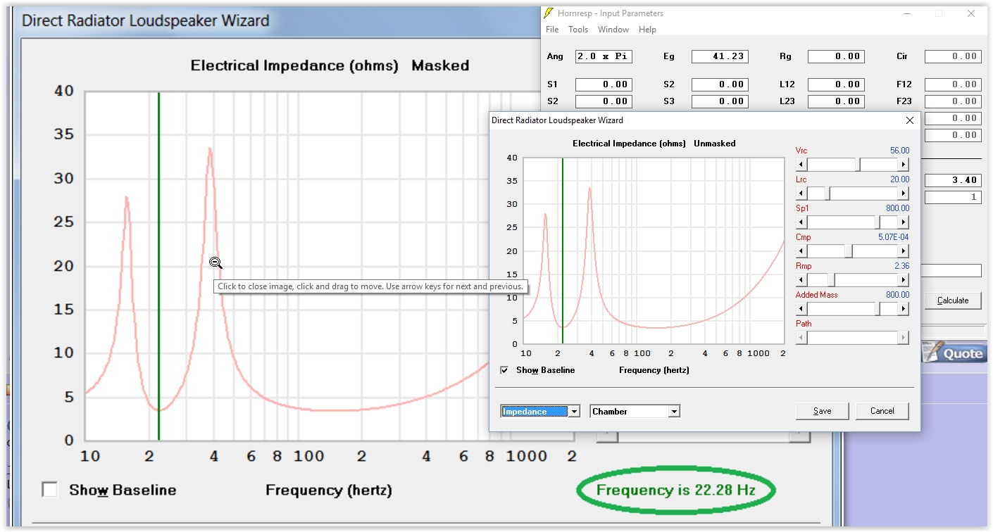

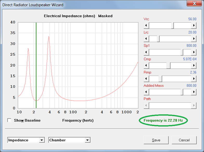

Hi David,
Thanks so much for adding the passive radiator functionality!
I'll attach a screen print: to get the green line to show I had to fiddle w/ the pointer until it finally got captured, and the 'Frequency is 22.28 Hz' only appears when the pointer is on the green line. Obviously workable. I would prefer to see the frequency read-out all the time.
Hi Oliver,
The frequency read-out shares the same location as several other context-sensitive status messages and one horizontal scroll bar, which is why it is not permanently displayed. It is important to me that the Hornresp forms do not become too cluttered - I like things to be "neat and tidy".
Yet another example of Hornresp "multi-tasking" 🙂.
Kind regards,
David
