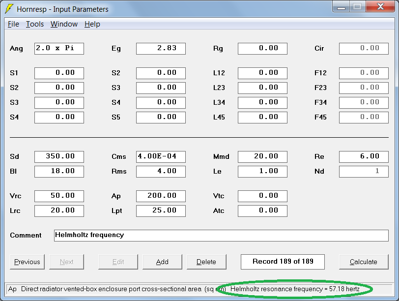

Didn't HornResp show the Helmholtz resonance frequency for vented alignments at one point?
It still does 🙂.

Hi David,
While the topic of computer display is up, just some observations:
I have a very hard time seeing the vertical dividers in the regular graphs for intermediate values, 100, 1000, 10000 are OK (e.g.: SPL or Phase from Calculate). The thin line for the previous graph in 'Compare Previous' is barely visible (maybe some color would help-as in the Wizard w/ and w/O the 'Large Voice Coil' ?).
The 'Loudspeaker Wizard' graphs don't seem to have any vertical or horizontal lines.
Filling only becomes visible around ~175 in the 'Schematic Diagram' (Wizard).
Anyway, just stuff like that 🙂. Not that big a deal to me. Also, could well be just me, as my eyes have been deteriorating rapidly lately.
Hi Oliver,
The Loudspeaker Wizard chart lines are definitely there - I can see them on screenprints you have posted 🙂.
The absorbent filling material starts to appear once any Fr1 slider control moves off zero.
It might be time for a new pair of spectacles 🙂.
