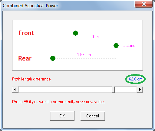

What does the program require us to enter as the Path value?
Hi Andrew,
For the 1 metre diameter baffle example I quoted, the theoretical path length difference value to use would be 62 cm, as calculated. A word of warning though - Hornresp assumes that the driver is mounted at the centre of a circular baffle, which is not a particularly practical design for the reasons outlined in my earlier post.

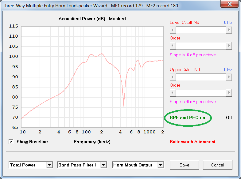

In the absence of any further feedback from 'papasteack' on whether or not to allow band pass filters and parametric equalisers to be used simultaneously in the Multiple Entry Horn Loudspeaker Wizard, I have decided to go ahead anyway and remove the restriction on dual operation. To reduce the potential for confusion an appropriate status message will be displayed when any of the band pass filters or parametric equalisers are being used - see Attachment 1.
CHANGE 2
In conjunction with the above change, pressing the F5 function key when the Multiple Entry Horn Loudspeaker Wizard is being used will now restore all band pass filters and parametric equalisers to their default settings.
CHANGE 3

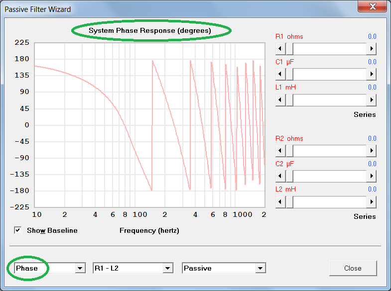

As requested by CRESCENDO, the Filter Wizard can now show the phase response of the specified passive or active filter and loudspeaker system - see Attachment 2.
