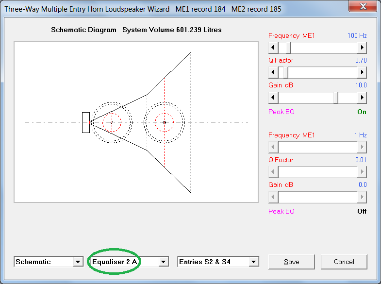

Hornresp Update 3970-160829
Hi Everyone,
CHANGE 1
The Multiple Entry Horn Loudspeaker Wizard offset ME1 and ME2 drivers can now be time-delayed relative to the horn throat HF driver. By default the delay is expressed as an equivalent distance in centimetres. Double-clicking the delay caption automatically sets the slider to the actual physical path length difference - see Attachment 1. Double-clicking the delay value changes distance to time, in milliseconds - see Attachment 2.
CHANGE 2
The Multiple Entry Horn Wizard Nd, ME1 and ME2 driver systems can now have up to four parametric equaliser filter bands each - see Attachment 3.
My thanks to 'papasteack' for originally suggesting the Multiple Entry Horn Wizard delay feature in Post #6029, and to Jack ('nc535') for more recently also suggesting the delay feature, together with the equaliser feature.
Extensive coding changes were required to accommodate the new features. Please let me know if you find any bugs.

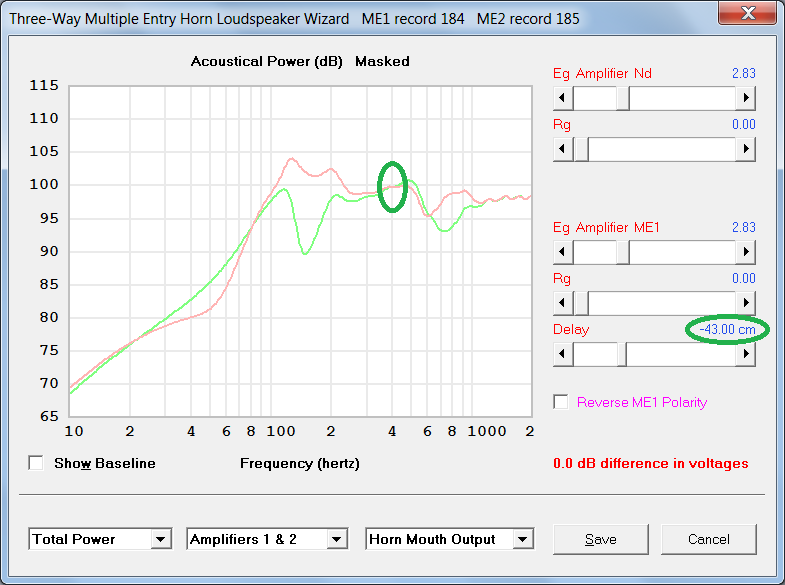

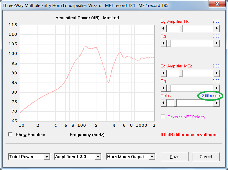

Hornresp Update 3970-160831
Hi Everyone,
BUG FIX
The bug reported in Post #6572 has been fixed.
CHANGE

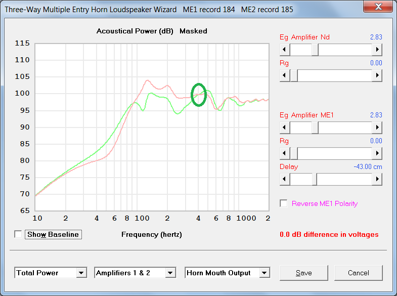

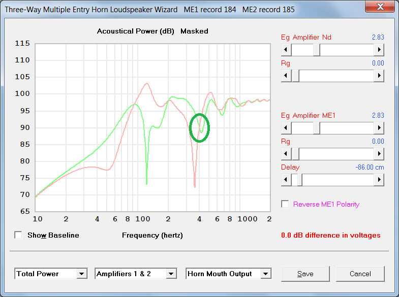

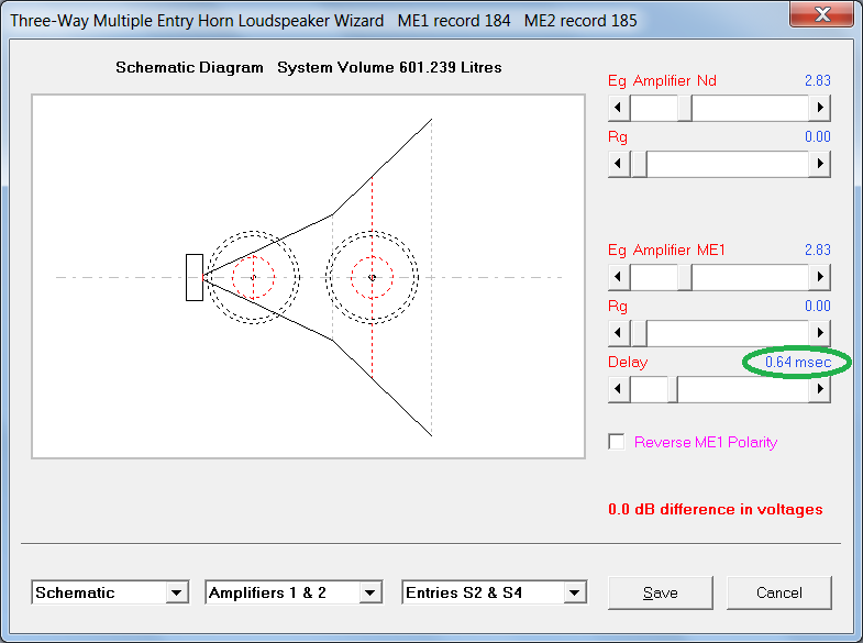

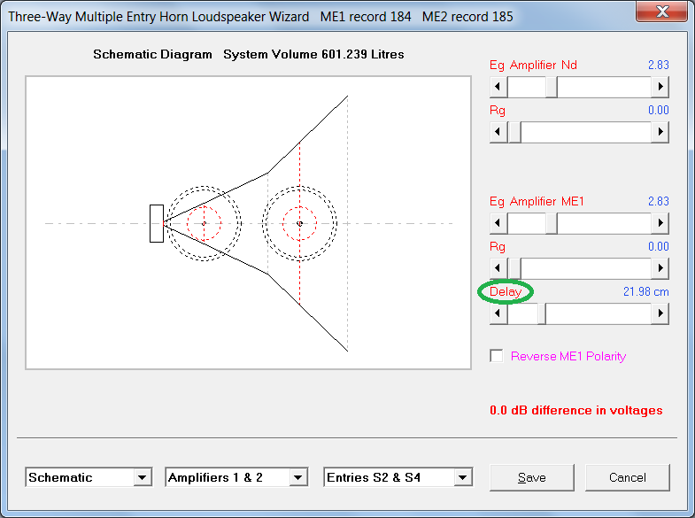

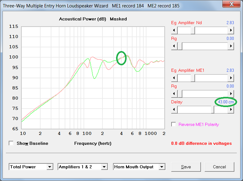

The offset ME1 and ME2 drivers in the Multiple Entry Horn Loudspeaker Wizard can now be time-delayed (positive delay slider value) or time-advanced (negative delay slider value) relative to the horn throat HF driver - see Attachment 1.
Sanity checks:
In Attachment 2 the green trace shows the response with zero ME1 delay and polarity reversed, which means that the phase at all frequencies is shifted by 180 degrees or half a wavelength. At 400 Hz the half-wavelength is 43 cm, assuming a sound velocity of 344 metres per second. The red trace shows the response with 43 cm ME1 delay (equal to half a wavelength at 400 Hz) and normal polarity. At 400 Hz the responses for the two traces are identical, as expected.
In Attachment 3 the ME1 delay has been changed from 43 cm to -43 cm. At 400 Hz the responses for the green and red traces are still identical, as expected.
In Attachment 4 the green trace shows the response with 43 cm ME1 delay and normal polarity, and the red trace shows the response with -43 cm ME1 delay. At 400 Hz the half-wavelength is 43 cm and the responses are identical, as expected.
In Attachment 5 the green trace shows the response with 86 cm ME1 delay and normal polarity, and the red trace shows the response with -86 cm ME1 delay. At 400 Hz the wavelength is 86 cm and the responses are identical, as expected.

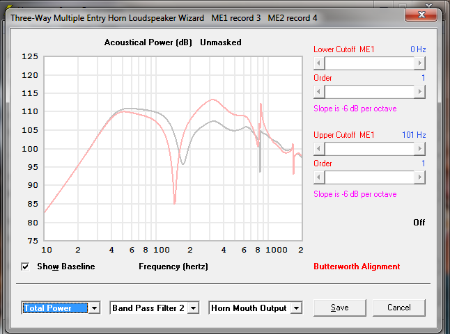

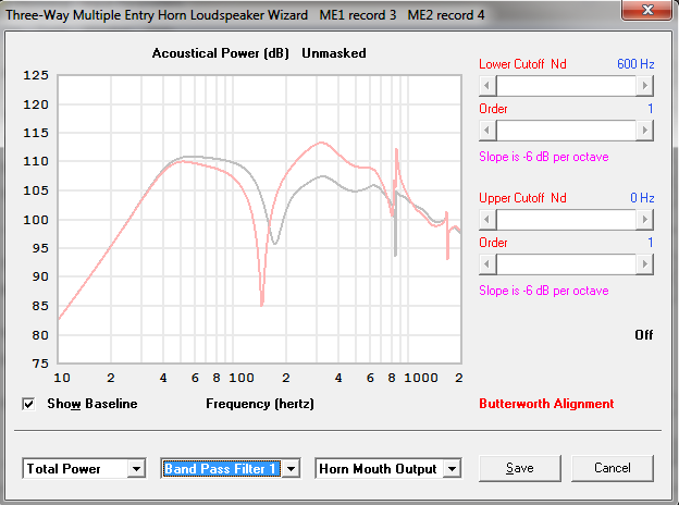

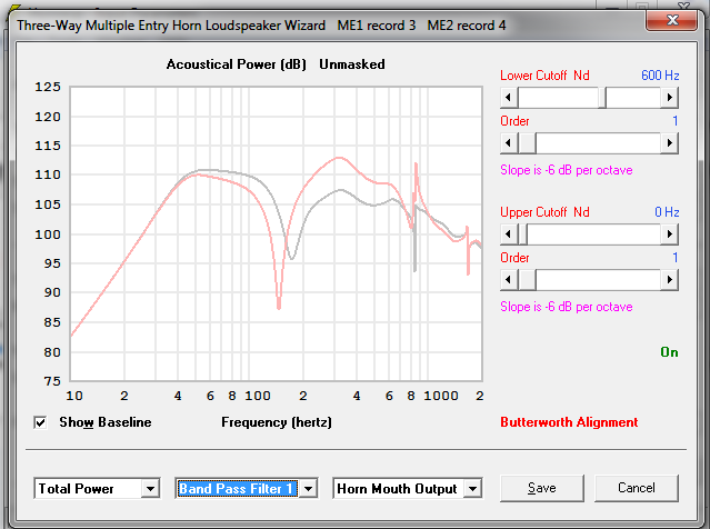

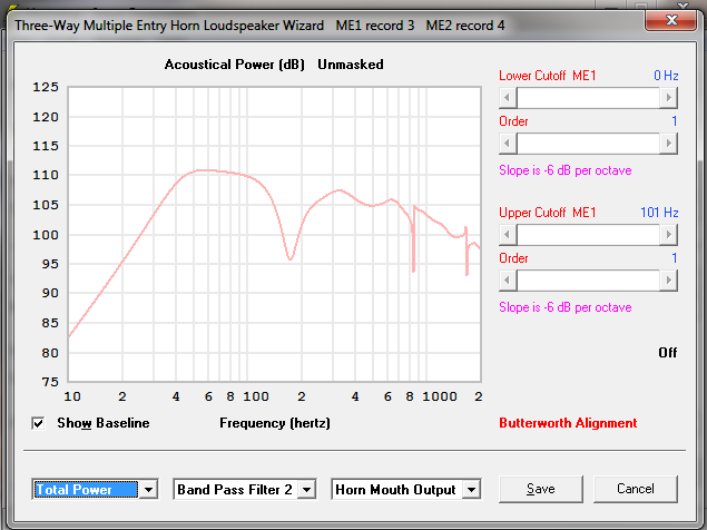

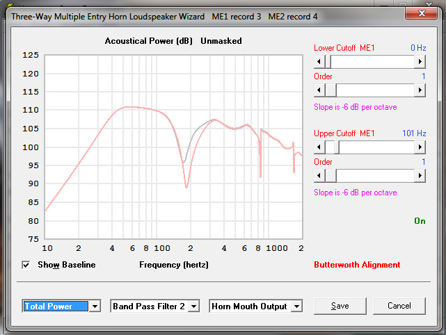

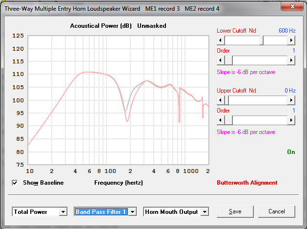

Bug report ! Sorry...🙄
I identifyed something that i was previously not sure in previous versions. I already had view this bug before, but it was less impressive than with this record, and though it was probably me having moved a bit some sliders...
So, without use of the new delay feature, on a ME wizard, there is a problem with bandpass filter if initially at OFF, giving different response than after switching on and again off.
Here what i did at starting hornresp, with screenshot of each steps, with Nd' & Me1' BPF initially off, and Me2 BPF on :
=>initial total response= screenshot 1
=> switching bandpass filter on = screenshot 2
=> switching again bandpass filter off= screenshot 3
=> bandpass filter 2 (on) = screenshot 4
=> switching bandpass filter 2 off = screenshot5
=> switching bandpass filter 2 on = screenshot6
3and 4 are same of course.
Normally, #1=#3 = #4=#6.
But #1≠#3, 3=4 (off course) and #4≠#6 . Precision as it is hard to see : 4≠5 (slightly)
There is no problem if bandpass filters are initially ON.
Do you want the 3 files ?
