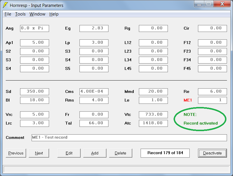

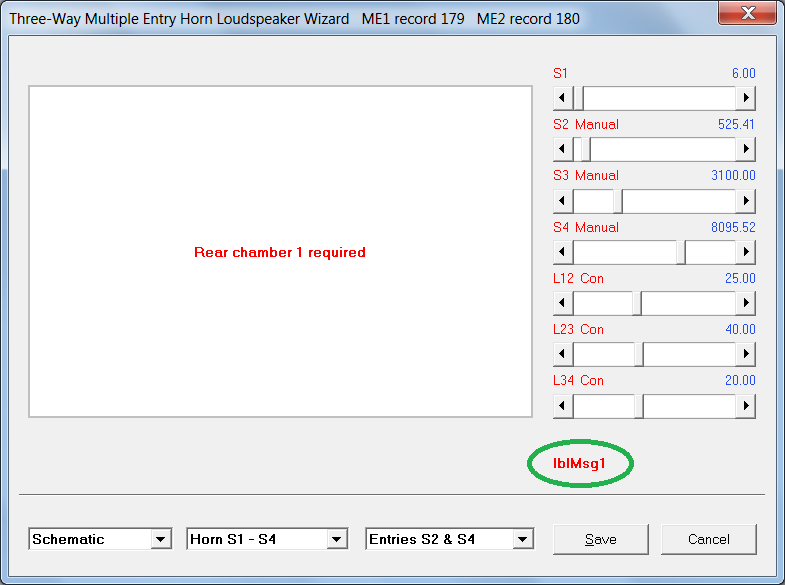

Hi Everyone,
It would seem that there are still some "loose ends" to tidy up in the Multiple Entry Horn Loudspeaker Wizard tool.
BUG 1
If a ME1 record was activated and a Nd multiple segment record then changed to Hyp, the Multiple Entry Horn Wizard could still be selected from the Tools menu, generating the error shown in Attachment 1. This problem has now been fixed.
BUG 2
If a ME1 record was activated, and the Nd record used to specify the HF driver and horn segments of a multiple entry system had Vrc and / or Lrc set to zero, then when the Multiple Entry Horn Wizard tool was opened the horn length message positioned just below the sliders was displayed incorrectly, as shown in Attachment 2. This problem has now been fixed.
CHANGE
When a ME1 or ME2 record is activated, the "Record activated" status message is now shown in green rather than red, as illustrated in Attachment 3. The default "Record not activated" message is still coloured red.

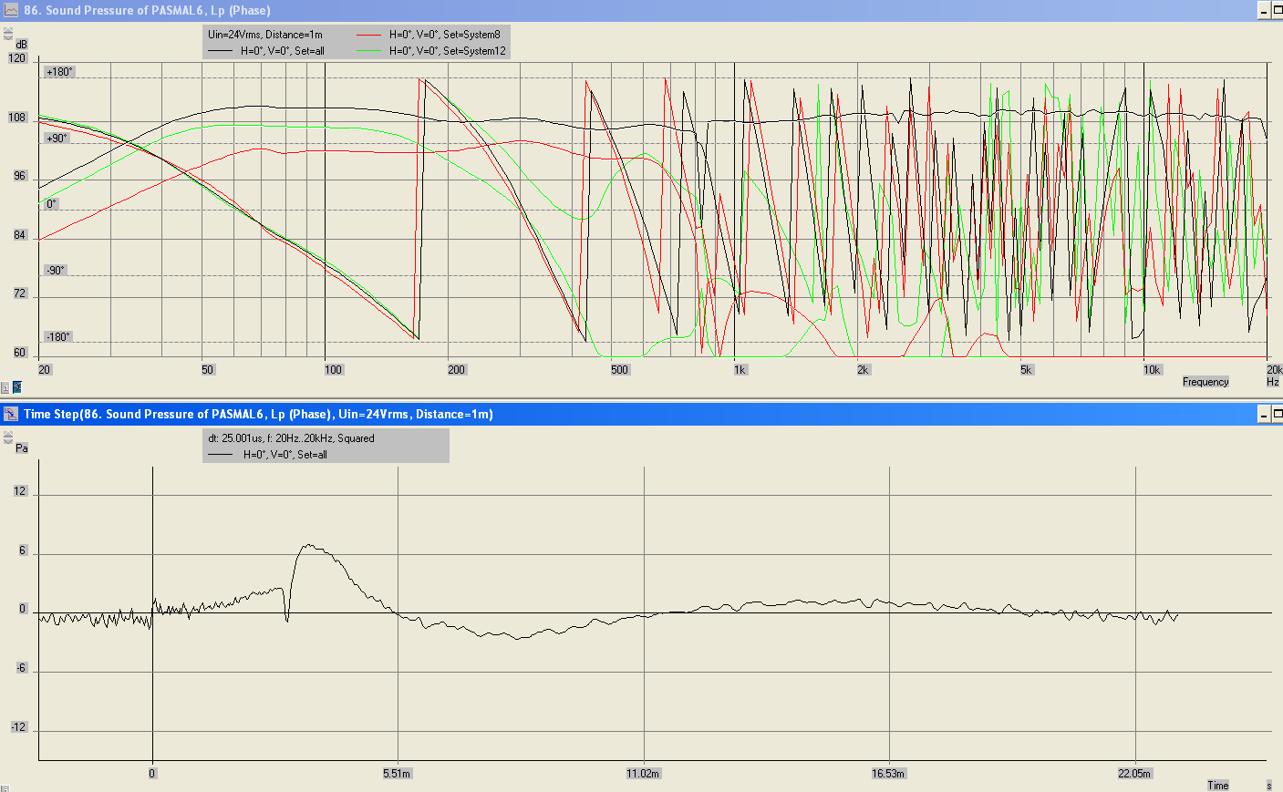

Here is why I asked for delay. In the bottom waveform, the mid's amp polarity has been flipped, changing the dip at XO significantly. With a delay vernier knob, ostensibly the dip could be minimized further. This optimal delay setting might be a good starting point for the real XO.
I had already asked once for this feature, it should be reaaaaally useful. I lost a lot of time playing with delay in akabak
It seems that with any luck, we might be finally getting there 🙂.
If when i add something to my wishlist to Santa David, i finally got it, maybe should i ask a step response simulation (even for multi-entry) ?
I explain : It's a long and hard process with akabak to learn how to play with bandpass box parameters+crossovers+delays to get a 3 ways multi entry like shown below (12"sub + 8"sub + 4"fullrange). Moreover, it allow to see and play with crossover/bandpass ringing.
When time will come to apply things to the real model, it will be a lot harder to change box parameters, so this learning process would be a lot more easy as it has always be with hornresp.
Note about the akabak simulation shown : It started with hornresp of course ^^. The 4" only response is not show in the image because akabak can only show 3 curves at the same time. The 8" comes as "filler driver". I only use 1st order eclectric crossovers, but i'm cheating because the subs got a lot of inductance. From how i understand/interpret things at the moment, the 2 low way bandpass box gives acoustic low pass for driver harmonic reduction, but give some inherent ringing too. With same slope electric crossover would give same ringing, but no driver harmonic reduction.
The step response is probably not the best, but seems not too bad when i compare the few other i see on internet (without convolution of course 😛)
I'll post in a thread every detail when i'll be ready. With work, 2 babies, and garden, it's a reallly long project ^^
