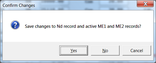

Just to repport a little error (if i'm right ^^). It seems that in 3-way multiple entry horn wizard, it don't save the "bandpass filter 3" parameters, or at least, for me.
Hi papasteack,
It seems to be working correctly for me. I tried changing the 'Band Pass Filter 3' slider settings, then clicked the 'Save' button to close the wizard, and then clicked the 'Previous' button to change to a different record, generating the message shown in the attachment. Clicking the 'Yes' button saved the filter changes.
Please let me know if you still have problems saving filter changes when the above process is followed. Thanks.
Kind regards,
David
Strange, myabe my mistake, with the high temperature. I just tryed at work, and it's working fine here. I'll retry at home and let you now. Yesterday at home it desactivated each time the ME3 filter.
^^ so, sorry ! no problem !
Thanks for letting me know.
That was an easy one to fix 🙂.
