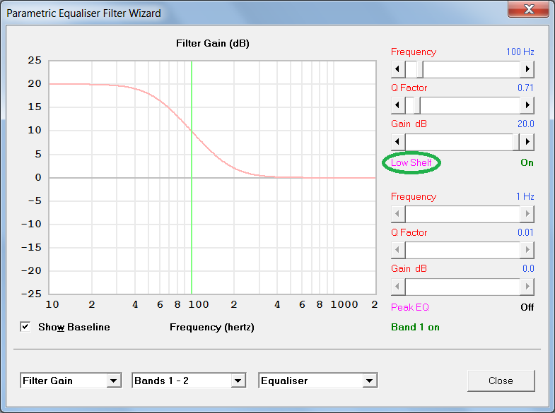

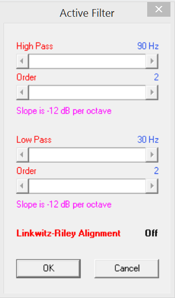

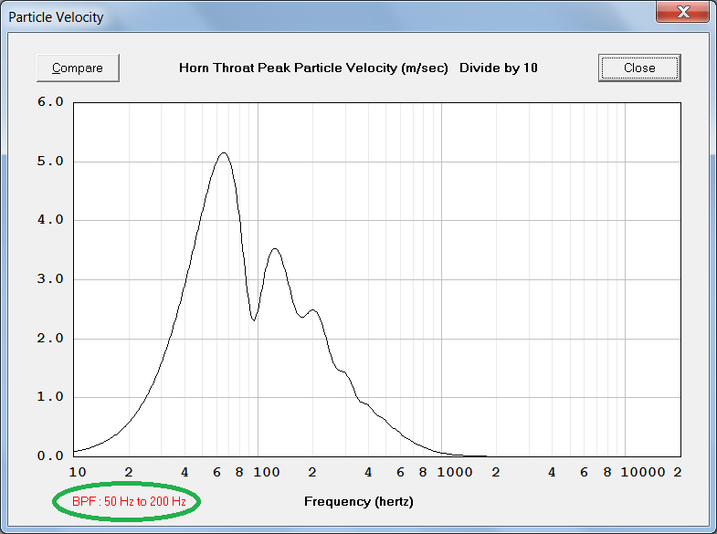

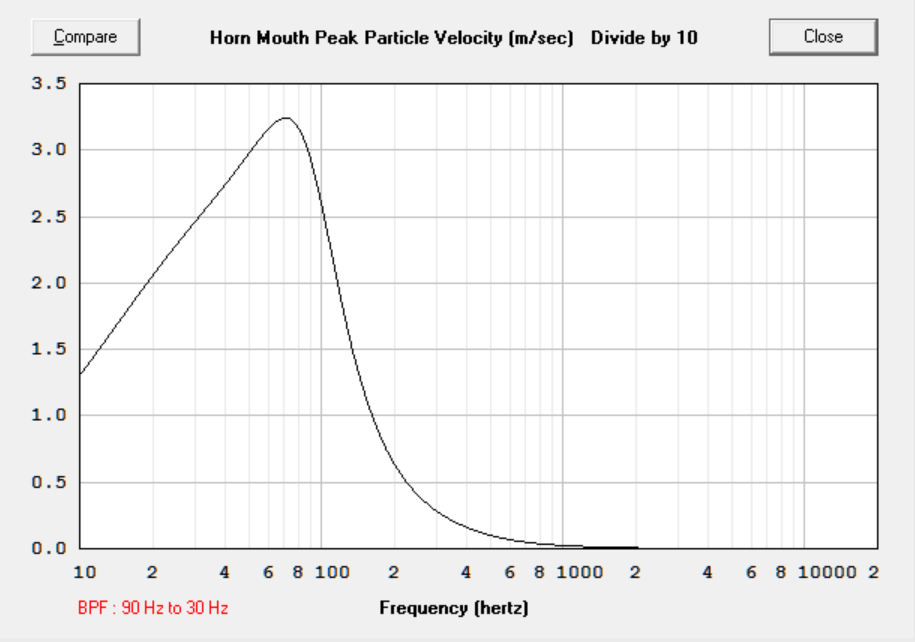

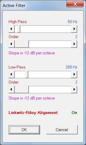

perhaps I'm missing something in the UI but is it possible to get some of the settings applied in the loudspeaker wizard to carry through to the calculated results? e.g. checking large voice coil or adding PEQ filters and then being able to see something only visible in the calculate screens (e.g. particle velocity).
also a feature request, any chance of a linkwitz transform and/or shelf filter option in the filter screen?
Hi 3ll3d00d,
The only filter settings that can be applied to the normal 'calculated' results are those specified using the Filter tool - see Attachments 1 and 2. The tool functionality is limited to an active band pass filter with Butterworth and Linkwitz-Riley alignments.
A peaking EQ filter, a low shelving filter, a high shelving filter, a low pass filter or a high pass filter can be specified for each of the six available bands in the Equaliser option provided in the Filter Wizard - see Attachment 3.

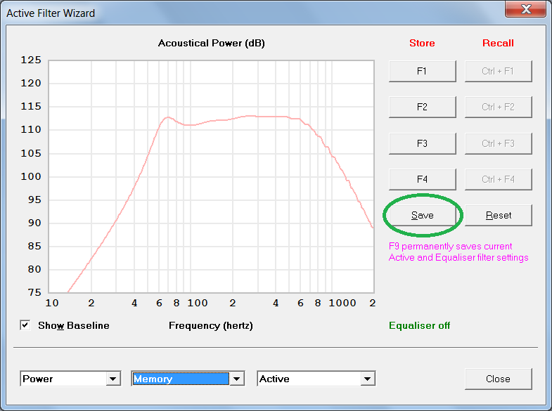

I gather that the 'no save' problem only occurs with the Multiple Entry Horn Wizard filters?
Not having a known repeatable sequence of events to generate the problem makes it more difficult to identify the cause.
I understand the difficulty, thus my earlier implicit apology for not being able to find a pattern to the anomaly with saving filter parameters in the original Filter Wizard, accessible under tools when in the acoustic power window. That you can come back to a record where at some time in the past you carefully equalized and saved filter settings and find those settings changed, best describes the problem. I think its also true that this won't have happened unless you changed EQ settings on another record in the meantime, but I couldn't swear to it. Of course, every time I try to repeat this "unexpected filter change" issue by going back and forth between two records, it doesn't happen.
My original description of the no save problem with the MEHW in my initial post is good, might be irrelevant Either you fixed it or it is indeed intermittent. It seems to work now.
Just to check - I assume you are permanently saving the Filter Wizard changes using the 'Save' button, or by pressing the F9 function key?
I am currently making massive changes to the Multiple Entry Horn Wizard to accommodate the new delay and parametric equaliser features. Hopefully everything will continue to work okay after the changes are implemented 🙂.

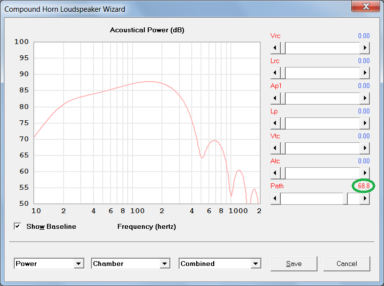

But when I make it a flat baffle (by reducing the depth of the H frame chambers to .01 cm) there is no more correlation. On the left I've shown the flat baffle with .1 cm path length on top (notice sensitivity is absurdly low) and below I've shown it with path length 22.7 cm (notice sensitivity is starting to get better but this path length does not reflect reality and the response curve doesn't match MJK).
On the right is MJK's sim showing no correlation at all with Hornresp.
It would be nice to do all OB sims with Hornresp but I'm not sure what's going on with the flat baffle sims, they don't seem right at all.
Ideas?
Ideas?
Hi just a guy,
The area of the flat baffle is equal to S1, so for your example the baffle radius is Sqrt(3716 / Pi) = 34.4 cm.
The driver is analysed as a point source which means that the path length difference from the front to rear sides of the diaphragm, around the baffle, is 2 times the radius of the baffle, or 68.8 cm. Using that path length difference gives the combined power response result shown in the attachment.

the path length difference to the listener is not twice the half width of the flat baffle.
Can I assume your method is not using listener distance, but how the back and front waves interact and then determines the effect at the listener?
