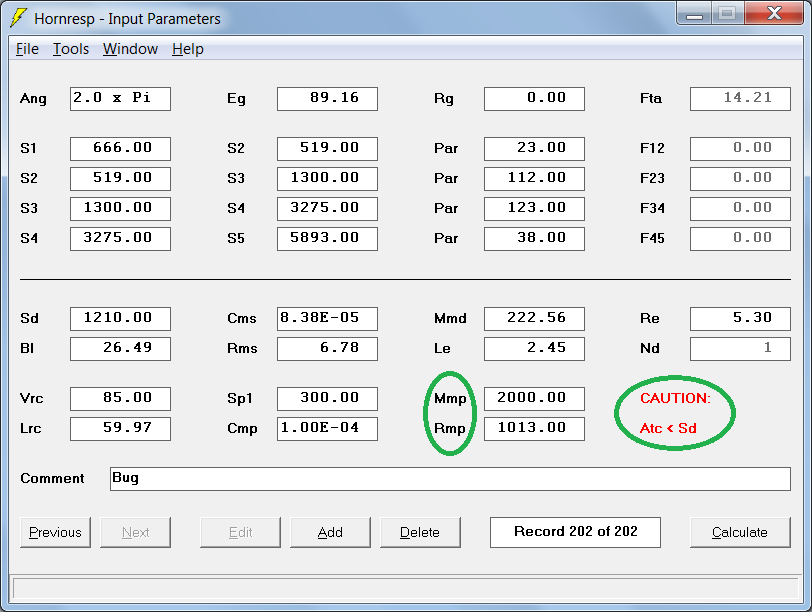

It didn't take long for me to find a bug in the latest release 🙂.
The Atc < Sd cautionary message shown in the attached screenprint should not be there. If a passive radiator is specified it is not possible to also have a throat chamber. The bug will be fixed in the next release, but I will wait a while to see if any more bugs are found before issuing an update .

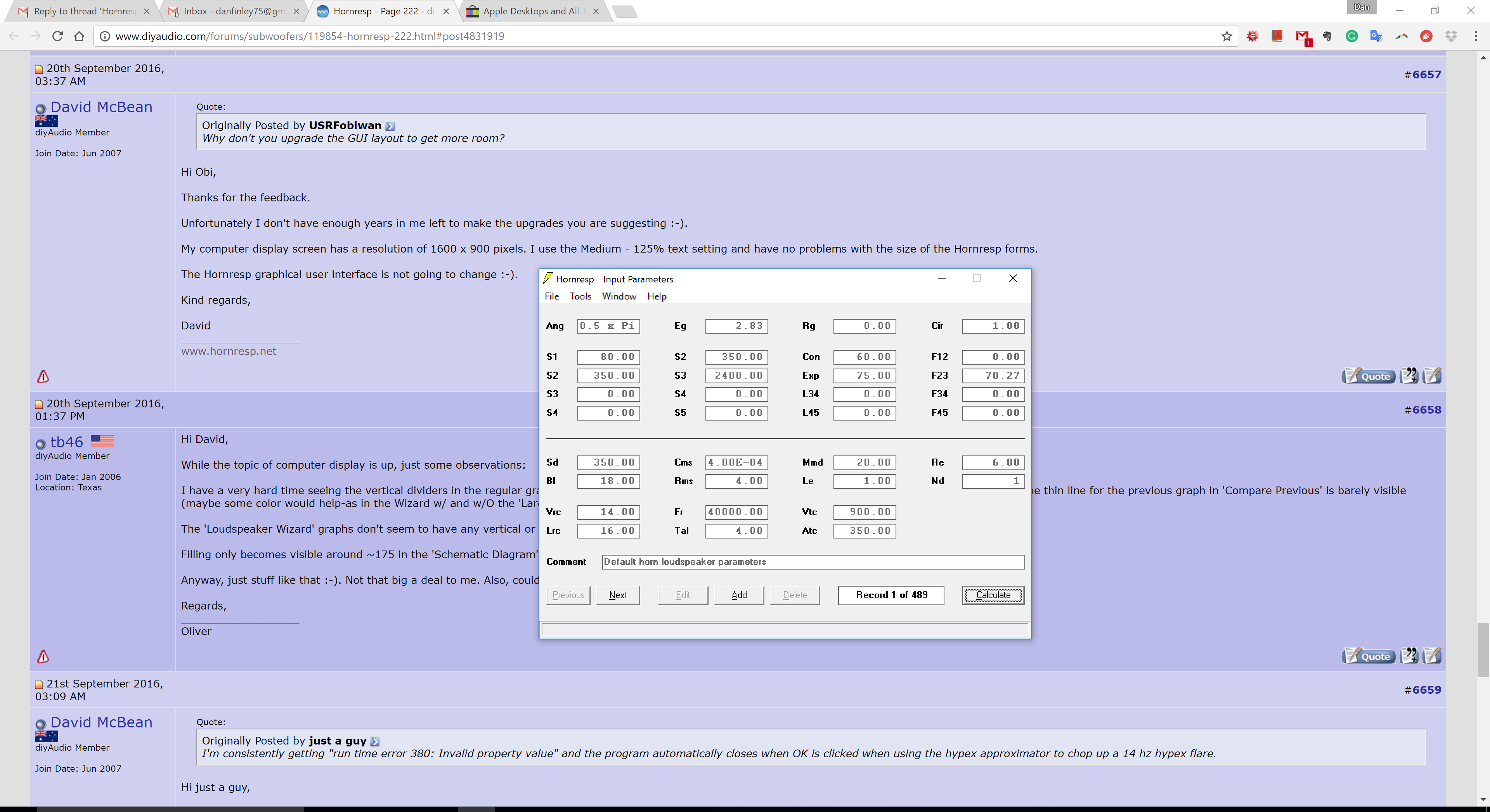

Posts #6668/6672: on graph lines.
No bugs, just a quick update on my video experiences:

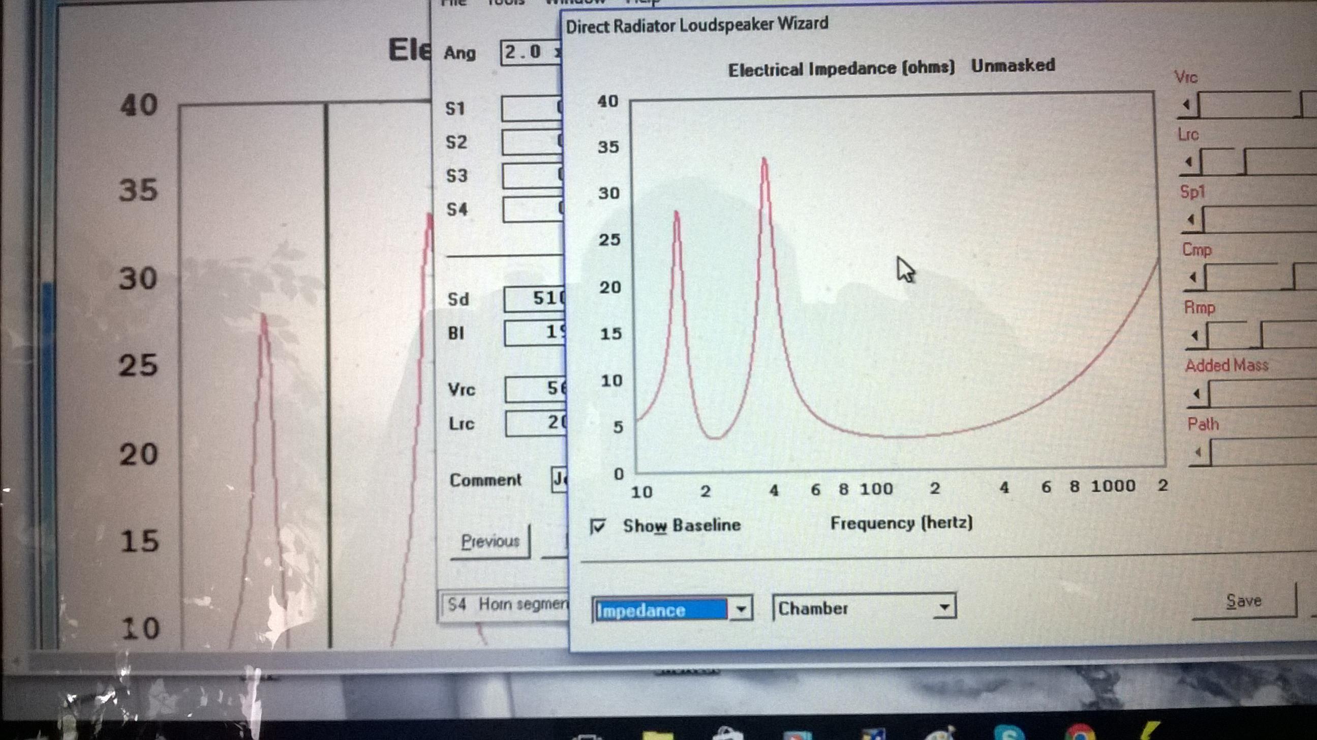

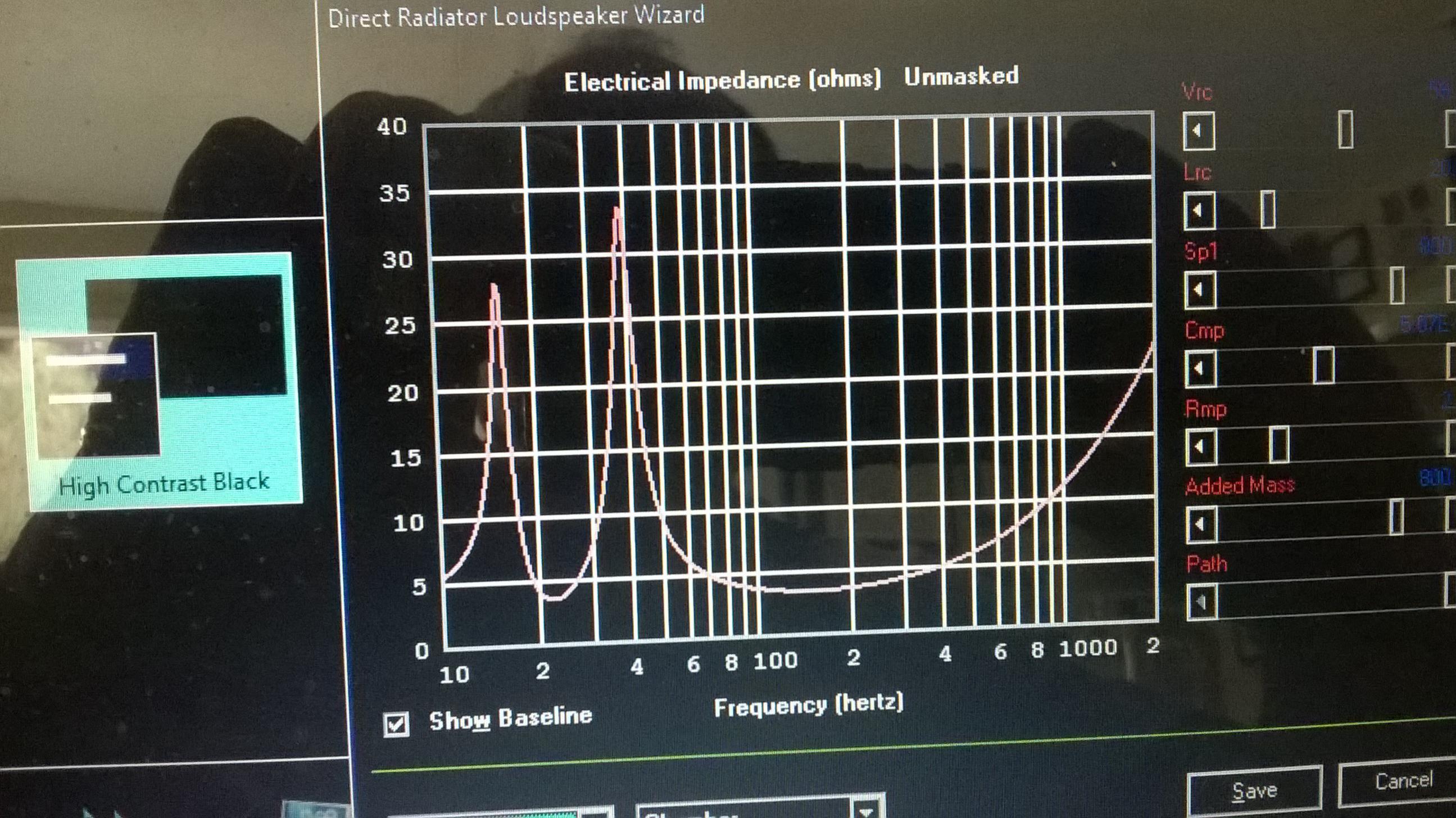

I connected the laptop via HDMI to my old 42" Vizio, and the graph lines that are not visible on my laptop display are clearly there on the TV. I tried (by now for hours) different settings, adjustments (those that are still adjustable by the user) and themes. Themes w/ a black background showed the lines clearly, anything w/ a white background will hide the lines on the laptop display.
This not only affects Hornresp, but programs like Windows Explorer and numerous website forms that have entry boxes which disappear. I'll try some more, but don't have a great deal of hope on the subject. As we all know: "...will make your programs run faster and better..."; or some such statement by MS.

@ tb46
I think there might be an option on your PC, which is "supposed" to optimise settings for LCD screens. If there is, try with it on/off & any other preferences etc that might be applicable with it, in different modes.

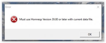

Had a new problem: when trying to open Hornresp I got the error screen attached, and Hornresp would not open. The work-around was to remove the Hornresp.dat file from the Data folder (renamed to Hornresp_dat02.old, and moved to Hornresp folder), then trying again to open Hornresp, which led to the new version download screen. After downloading, saving and installing the new version I replaced the Hornresp.dat file in the Data folder w/ the old version. After running CCleaner, shutting down, and restarting everything (old simulations) seems to be still there , and working. Well, almost: still no graph lines on the laptop. 🙂

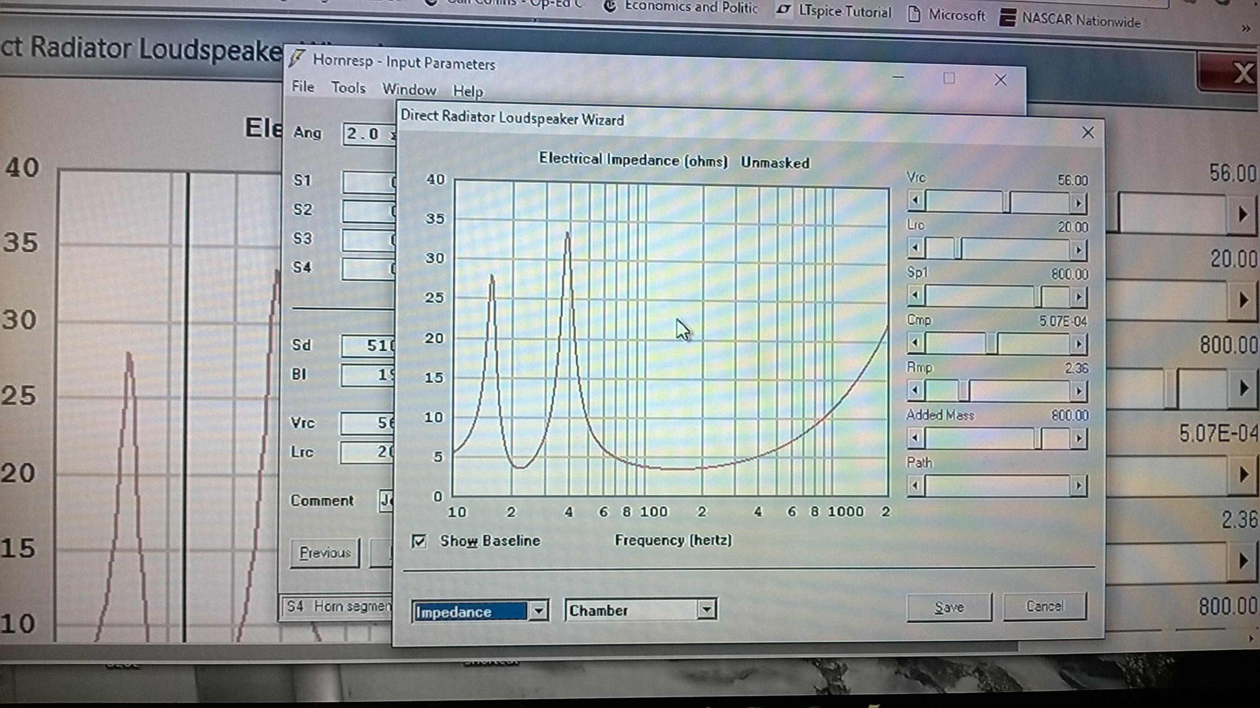

I'm curious, what is making the crosshatch pattern in this HR image? http://www.diyaudio.com/forums/attachments/subwoofers/571235d1474753715-hornresp-lines_laptop.jpg

Hi Y-all,
The battle w/ the display has been won, it finally just came down to finding graphics resolution and color settings that work for my eyes.
Thanks to all for the suggestions, they helped. 🙂

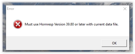

Hi Oliver,
Had your Hornresp.dat file already been opened using Version 38.90 of Hornresp, and were you now trying to open it using an earlier version? This is the only scenario under which the message should appear.
Version 39.80 automatically adds an extra field to each of the data records in the existing Hornresp.dat file to store the passive radiator added mass value. This additional field is not recognised by earlier versions, thus triggering the message.
Aliasing?
Hmm, based on these definitions, seems like he has either a bad monitor or wrong resolution for the size/type if I understand them: https://www.google.com/search?q=Ali...ng&aqs=chrome..69i57&sourceid=chrome&ie=UTF-8

Hi David,
Post #6689: "...Had your Hornresp.dat file already been opened using Version 38.90 of Hornresp, and were you now trying to open it using an earlier version?..."
It had not. I had not downloaded the new version yet. The problem occured when trying to open Hornresp from the desktop icon.
Hi David,

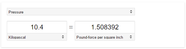

The cone is more than rigid enough, it can handle up to about 2.5 psi before rupturing, the issue I'm trying to understand better is the non-linearity of the air and where I should expect this form of power compression to set in terms of air velocity or pressure (if that is even predictable).

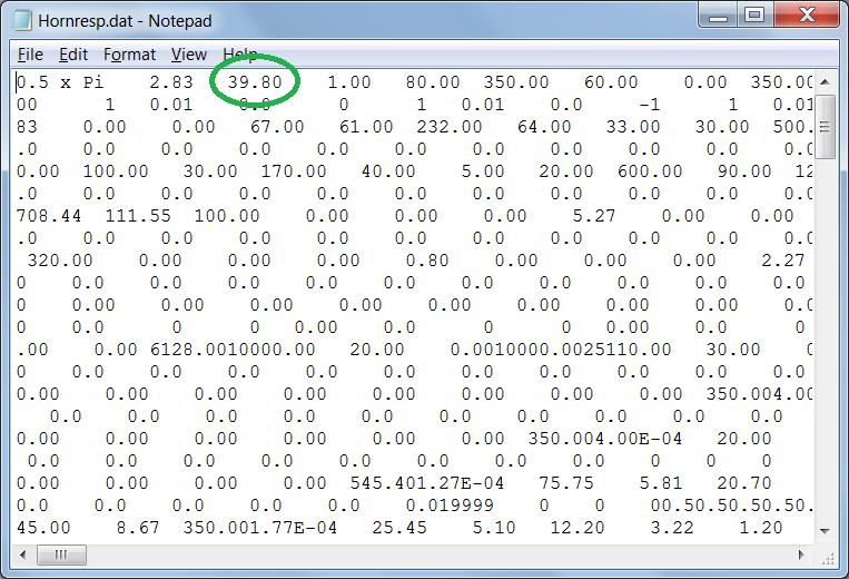

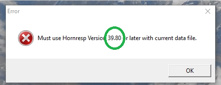

Hi Oliver,
This is very strange indeed. The 39.80 version number shown in the error message is read from the third field in the first (default) record in the Hornresp.dat file, and the only way for the number to get into the Hornresp.dat file in the first place is for the file to have been opened using Hornresp Version 39.80.
Would you by any chance still have a copy of your original Hornresp_dat02.old archive file that I could examine? Thanks.
* Just to clarify, in my Post #6689 I should have said Version 39.80 not Version 38.90 🙂.
