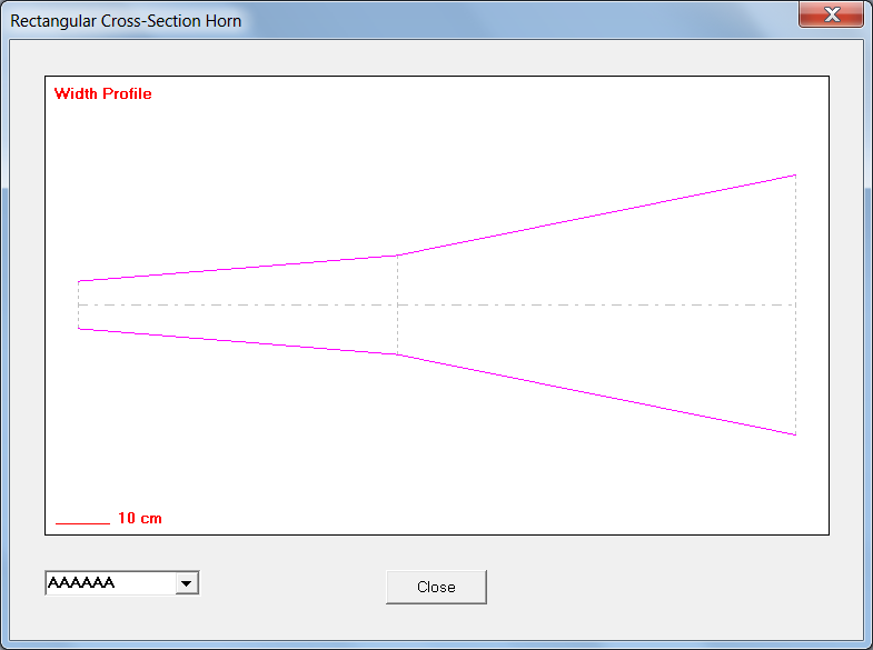

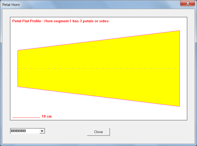

CHANGE 1
Previously it was possible to edit the contents of the dropdown list box on the Rectangular Cross-Section Horn and Petal Horn data export preview forms, as shown in Attachments 1 and 2. This has now been fixed.

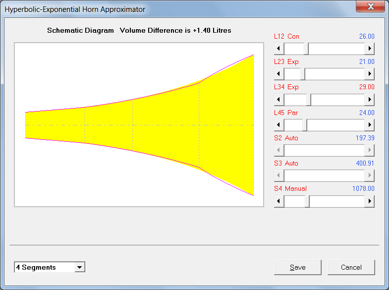

A 'Hypex Approximator' tool has now been added, as shown in Attachment 3. The comment by 'just a guy' linked below was the catalyst for the development of this feature.
http://www.diyaudio.com/forums/subw...ative-stepped-horn-project-4.html#post4607599
Following is a description of the Hypex Approximator functionality, as detailed in the Tools Menu section of the Hornresp Help file.
|Hypex Approximator
Approximates a specified hyperbolic-exponential horn using up to four conical, exponential or parabolic segments.
To change the flare of a horn segment, double-click on the label above the length slider control. If the label is double-clicked while the Ctrl key is pressed, all segments are set to the same flare.
To change the Auto / Manual setting of an area slider control, double-click on the label above the area slider.
To directly set an enabled slider control to a specified value, key in the value and then press Enter while the control has the focus.
The volume difference value is the sum of the segment volumes minus the volume of the specified hyperbolic-exponential horn. The value is positive when the sum of the segment volumes is greater than the hyperbolic-exponential horn volume. The value is negative when the sum of the segment volumes is less than the hyperbolic-exponential horn volume.
The Tools menu command can be accessed when either S1, S2, L12 (Hyp) or T for a hyperbolic-exponential horn has the focus.

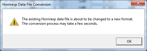

@David, I tried to view a partial database attached to someones post, and in trying this Hornresp wanted to update the database format but the process failed. How long ago did the format change and is it necessary to validate my current database, it is probably a few years old.

Hi AllenB,
Could you please provide a link to the partial database post. I would like to try to establish why the format update did not work as intended.
The format of the record data file has changed a number of times over the life of the program. Hornresp normally automatically updates the data file format as necessary, without the user being aware of it. If the "Hornresp Data File Conversion" message was displayed, then it means that the file you were trying to open was created prior to the release of Version 5.70.
If Hornresp can read the records in your current database, then the file is formatted correctly.

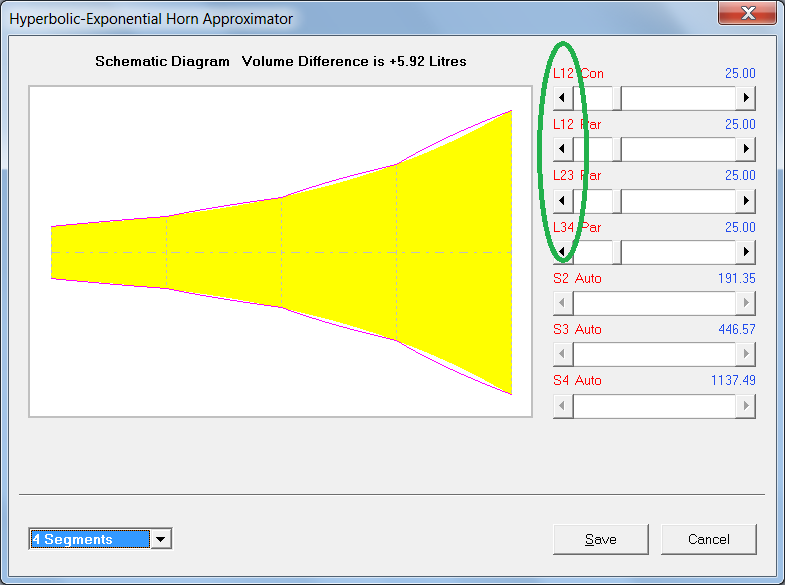

Bug Notice
Hi Everyone,
I have already found a bug in the new Hypex Approximator tool 🙂.
Changing the flare with the Ctrl key pressed generates incorrect length slider labels. The attachment shows the four length sliders as L12, L12, L23 and L34. They should be L12, L23, L34 and L45. This will be fixed in the next release.

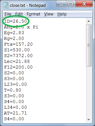

@David sorry, this was a few months ago and I can't find the file. "Hornresp Data File Conversion", that was probably the message. The thread was probably five years old. IIRC the program would appear to hang but after a few minutes I'd be able to use it again even though the issue didn't appear to clear and I couldn't use the record in question.
Hi AllenB,
Just to clarify - was the file in question a complete Hornresp.dat data file containing a number of records, or was it simply a single exported record that you wished to import?

Wait, I found it in ./data (where I had put it). [".txt" extension added for forum compatibility]
Screenshot of the process dialogue.. The error was only generated because I tried to change records while it was working.
Wait, I found it in ./data (where I had put it). [".txt" extension added for forum compatibility].
Excellent - thanks AllenB!
The original file was generated by exporting a single record using a version of Hornresp between 26.50 and 34.00. The file extension would have been .txt, but it seems that somewhere along the line it has been manually changed to .dat. Also for some reason the first line of the file, which would have read ID=26.50, has been manually changed to ID=80.00.
The attached file is identical to your original one except that the ID number has been changed back from 80.00 to 26.50, and the file extension has been changed from .dat back to .txt.
You should now find that the contents of the attached 'close.txt' record file can be successfully imported using File > Import > Hornresp Record. Please let me know if this is not the case.
