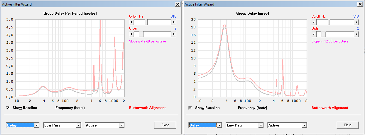

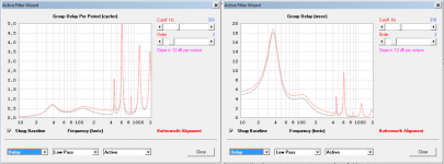

Just to be sure, do we agree calling "normalized" the use of GD/(1/fs) as variable of interest instead of GD for Y axis ?
You're right, there's something to get clear about min/max graph limits requirements : In Akabak, i use custom upper and lower limits. I get in horn designs > 5-6 ratio in the 3000-5000hz range. But i think this "normalised" group delay should be the more of interest in the low rang, where it keep even in bad case below a ratio of 2:1. So [0:2] for Y would be adequate for not loosing too much information/subtilitises in the low range, and keep some in the midrange. The must would be clicking on the Y scale, the possibility to switch for a [0:10] scale.
Maybe can i ask cumulative gift for christmas + birthday ^^
^^ Exactly. I feel stupid complicating things more than what they are...it's of course simplier said like that, and the same as GD / (1/fs).I think he would like to see the group delay normalized by period, to give the delay in cycles instead of seconds. From the explanation, it seems like the value desired is (group delay value)*(frequency).

He "normalizes" Group Delay into cycles of delay calculated by dividing the group delay by the period of the frequency at each point (or the frequency times the number of seconds of delay);

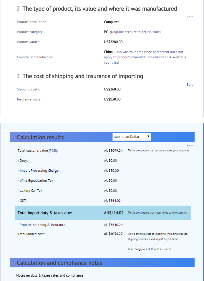

There are a whole bunch of "if's" But a quick calculation of the import costs makes a person think it might simply be easier to Paypal over some funds and let the man do what he thinks best.
The import duty is prohibitive to say the least. And that is an end user cost. As in the person getting the import.
As a normal person you don't usually see these costs. But when importing products from overseas many countries have these costs. And they are many times hidden in the prices we pay retail.

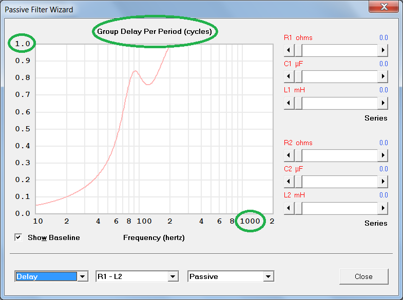

Hornresp Update 3970-160306
Hi Everyone,
The delay per period feature requested by Damien in Post #6072 and further detailed in Post #6076, has now been included in the Filter Wizard tool.
The functionality is documented in the Filter Wizard description included in the Tools Menu section of the Hornresp Help file, and is also provided below.
Select the Delay option to display the group delay or group delay per period of the specified passive or active filter and loudspeaker system. Not applicable when the Filter Wizard is selected from the Loudspeaker Wizard, when room gain is included, or when the Passive or Le Cléac'h filter option is selected and Rg is non-zero.
Double-click anywhere on the group delay chart to switch to the group delay per period chart. Double-click anywhere on the group delay per period chart to switch back to the group delay chart.
Double-click anywhere on the group delay per period chart Y-axis vertical scale to switch the chart range from the default 1 cycle to either 2 cycles, 5 cycles, 10 cycles or 20 cycles.
