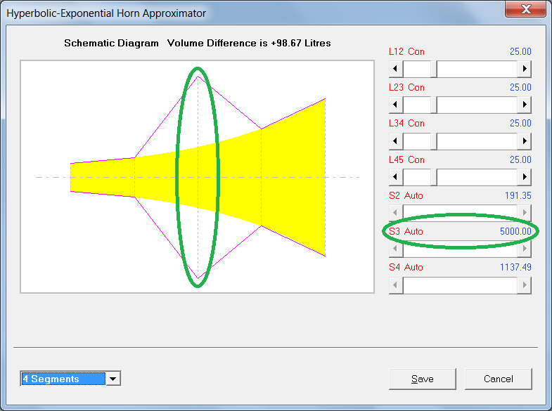

Hi Everyone,
The bug reported in Post #6052 has now been fixed, along with another three I subsequently found. Under some conditions the area slider Auto settings were not resetting properly (see Attachment 1) under other conditions the schematic diagram was not being displayed correctly (see Attachment 2) and under yet other conditions the schematic diagram was wrongly scaled (see Attachment 3).
Hopefully all the Hypex Approximator "loose ends" have now been tidied up, but if you notice anything that doesn't seem right, could you please let me know.

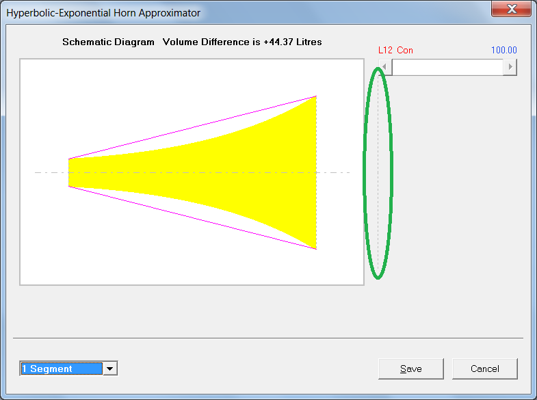

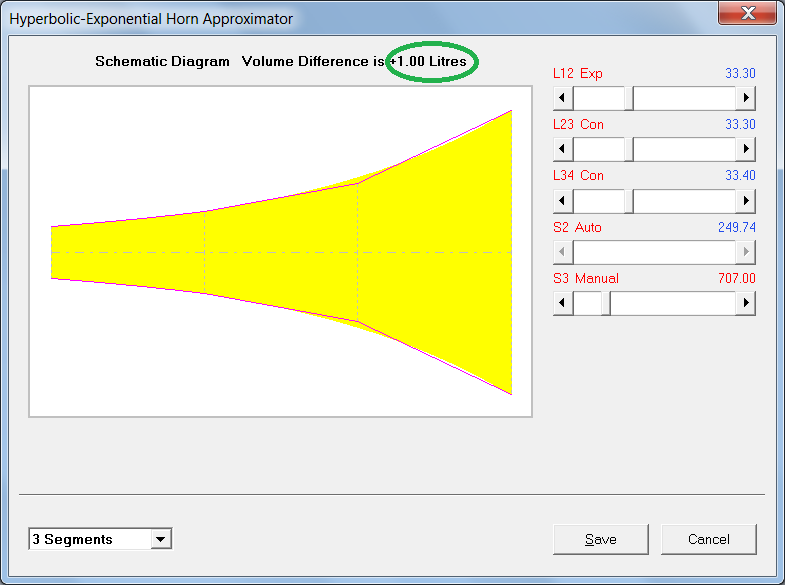

Hornresp Update 3970-160223

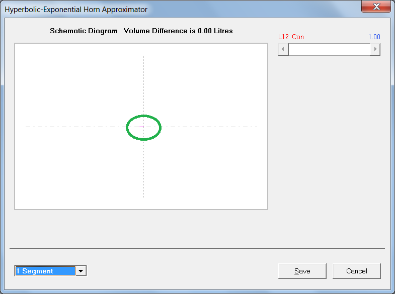

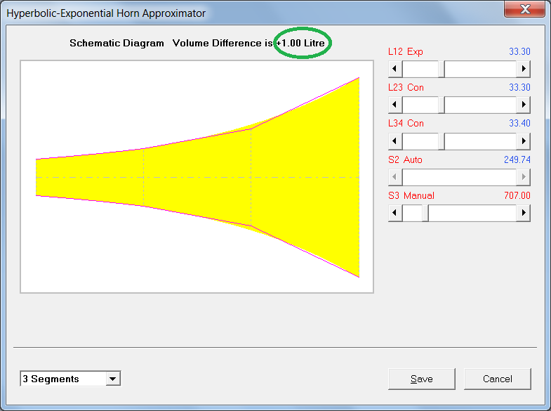

Hi Everyone,
Volume difference was shown as 1 litres rather than 1 litre in the Hypex Approximator tool (see Attachment 1). This error has now been corrected (see Attachments 2 and 3).
Kind regards,
David

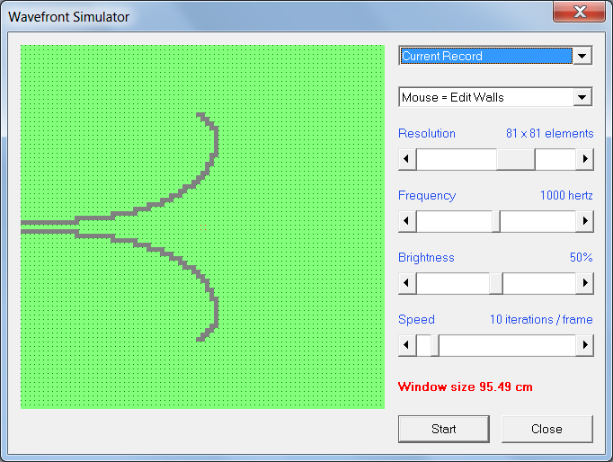

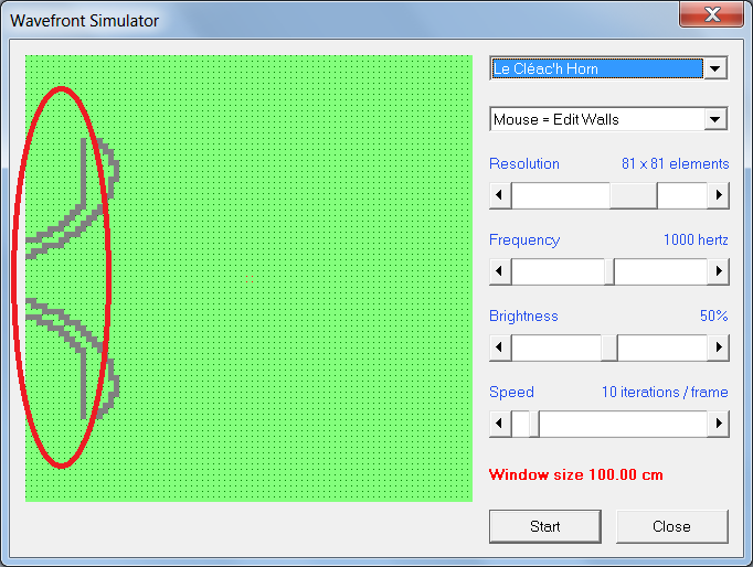

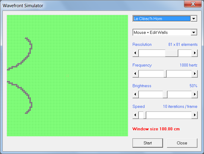

Hornresp Update 3970-160228
Hi Everyone,
BUG FIX

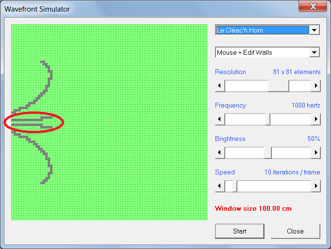

The following bug was found by sheer chance. It applies only to Le Cléac'h horn records.
Sequence of events triggering the bug:

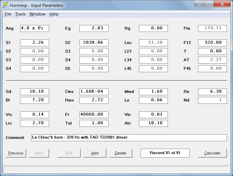

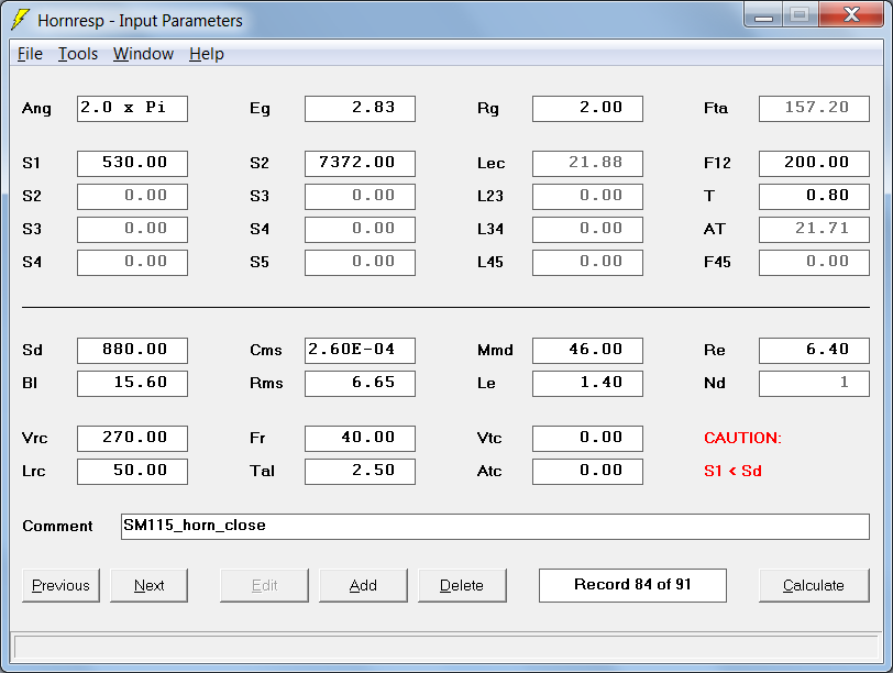

1. Select Le Cléac'h horn record.
2. Select Tools > Wavefront Simulator.
3. Select Le Cléac'h Horn option.
Examples of bug:
For the test record shown in Attachment 1, the result shown in Attachment 2 was being generated. For the test record shown in Attachment 3, the result shown in Attachment 4 was being generated.
The problem has now been fixed. The correct result for both test records is shown in Attachment 5.
Kind regards,
David

Hornresp Update 3970-160229
Hi Everyone,
Unfortunately yesterday's update didn't resolve all the issues.

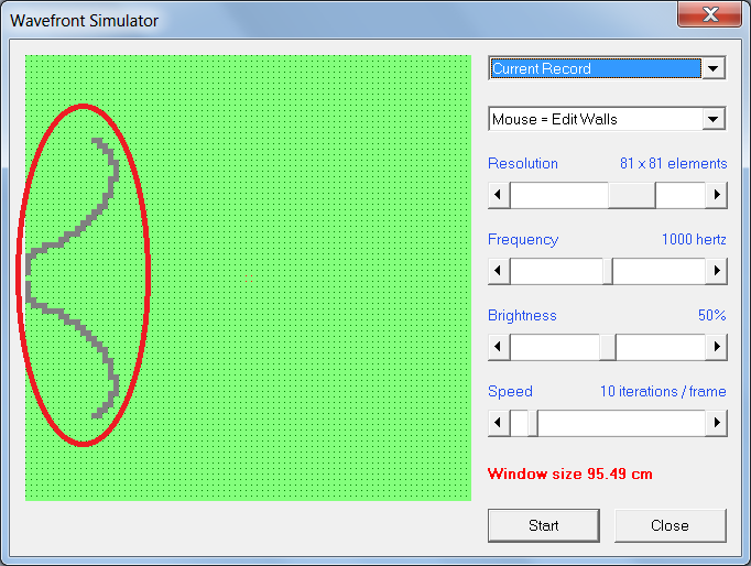

Sequence of events triggering remaining bug:
1. Select Le Cléac'h horn record - see Attachment 1.
3. Select Le Cléac'h Horn option - correct result shown, see Attachment 2.
4. Select Current Record option - incorrect result shown, see Attachment 3.
The Le Cléac'h horn current record problem has now been fixed. Attachment 4 shows the correct result.
Kind regards,
David

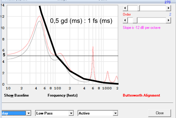

Dear David,
I've been well-behaved this year. Even it's not Christmas, could you at least think a little bit about adding delay per period windows as in akabak ? It's such a help to analyse group delay spike significance, trying to tweak to keep things bellow 1:1, and moreover seeing better crossover slope huge phase effect in mid-low range.
I love hornresp.
Thanks,
Damien
I love hornresp.
Thanks,
Damien
Hi Damien,
Not sure what you mean by "delay per period windows". (Unfortunately I no longer have a computer capable of running AkAbak to allow me to check for myself).
If however you are interested in seeing how the insertion of a filter affects the overall group delay of a system, then this can be done for a standard record by clicking the Calculate button, then selecting the Filter Wizard tool from the Acoustical Power window, and then choosing the Delay option in the tool (after first specifying the filter parameter values). Alternatively, for any standard record in Edit mode, you can insert an active filter using the Tools > Filter menu command before clicking the Calculate button. The effect of the filter on phase and group delay can then be seen in the normal results.
Otherwise, you are going to be out of luck - even at Christmas 🙂.

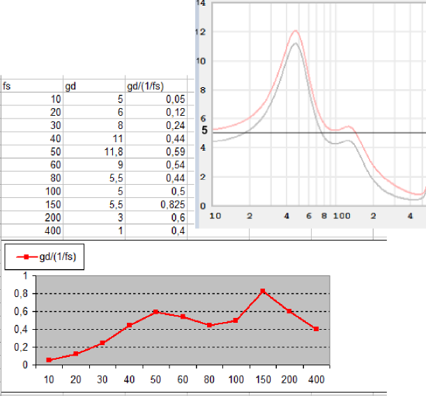

Just as group delay windows, but with X=(group delay in ms)/ (1/fs in ms)Not sure what you mean by "delay per period windows". (Unfortunately I no longer have a computer capable of running AkAbak to allow me to check for myself).
Why ? It is a lot easier to analyse, wanting to keep this X always bellow for example a value of 1. For example, with a arbitrary limit of X=1, it can be easy to see visually where group delay is more or less than 25ms for 40hz, 12,5ms for 80hz, 6,25hz for 160hz.
This graph is a lot flatter than group delay curve, and show group delay importance relative to frequency. It's a way to approximate the variation of our sensibility to group delay to a more linear visual curve.
Another probably a lot simplier feature that would have the same use, would be to simply add the custom "Z" Gd :1 period curve on the actual group delay windows, with "Z", the wanted threashold, beeing for example 0,5 in the really fast pics below (curve is a bit wrong, but gives a idea). But it would not be as subtil.
^^ I already use it a lot before converting to Akabak to control multi-segment directivity, and adjust with non-standard filters. It's really awesome ^^If however you are interested in seeing how the insertion of a filter affects the overall group delay of a system, then this can be done for a standard record by clicking the Calculate button, then selecting the Filter Wizard tool
It allow to compare group delay of different kind of box (OD/TH/BP/BR...), taking account filter needed (sub high pass). Playing with it, i choosed not intuitively, long throat BP for low way of a synergy horn as it do not need high pass, and need lower order low pass, and finally make things simplier, with better low end group delay result with the woofer i got.
But changing the crossover frequency, with only group delay curve, it's hard to realise/interpret if the chosen frequency would give better subjective result taking account our frequency dependant sensitivity to group delay.
Using Akabak's group delay per cycle curve, one can choose the crossover frequency to get the lower lower group delay per cycle ratio, taking account our frequency dependent sensitivity to group delay.
Here is where the idea came me from, post 4# : http://www.diyaudio.com/forums/multi-way/71613-educated-me-phase-plot-group-delay.html
EDIT : just added a example done with excel with the same GD graph restricted on 20-400hz because cannot do better without real numbers. It show well that the visual message in not the same anymore. Now the 150hz spike is more a "problem" than the 40hz one. (numbers are a bit wrong since i did it fast, but that's not the subject here)
(doing so much errors by myself, i really need programs to do works for me ^^)
Hi Damien,
Thanks for the detailed explanation. Just to confirm the requirement, you would like to see a "normalised" group delay chart in the the Filter Wizard tool, with the Y axis having a lower limit of 0 and an upper limit of 1. Is this correct?
Kind regards,
David
