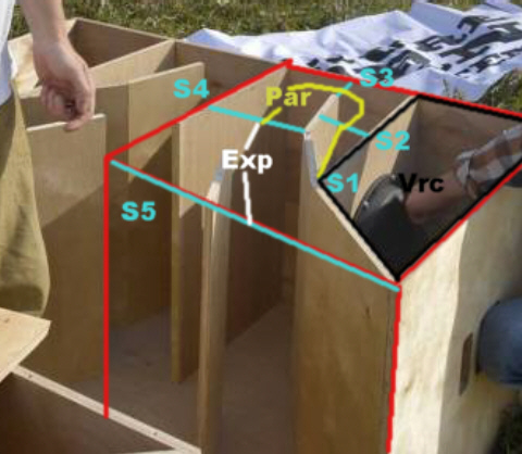

Hi! We've recently made a 2-folded horn box for 15". The idea was to use it in a range about 100-200Hz to add punch effect. (We've already had 18" FH sub and 2-way tops.)
Unfortunately I didn't know about Hornresp before building. So now I'd like to test our box and have some questions. To be clear, here is the box:
So, I guess in Hornresp I should use OD-type, how to add 2-section?
current state, is it ok?:
It's definitely not ok.
First, your t/s parameters are wrong. 73 grams MMD for a 15 inch driver seems low but it might be right. The most troubling part is CMS - the value you have would mean VAS is well over 100000 liters - this is most unlikely and Hornresp won't even calculate the value of VAS because it's out of range.
Second, S1 (the beginning of the flare) seems to come to a point so it should be 1 sq cm. As for the other dimensions I have no idea if they are right, there's no way to judge from a picture.
Third, you should be using 2 drivers in the sim. Then consider all the mirror imaged path length as a single path (times 2 on the paths cross sectional areas that are mirrored) and then where they converge at the mouth just use the measured cross sectional area.
Fourth, all the segments should be PAR, not CON. Not sure why you used PAR for the first segment and CON for all the rest.
Fifth, it's hard to tell, but it looks like you have too many flare discontinuites to accurately sim with Hornresp's four segments. You can fudge it or you can use TL.app or Akabak to get a more accurate sim.

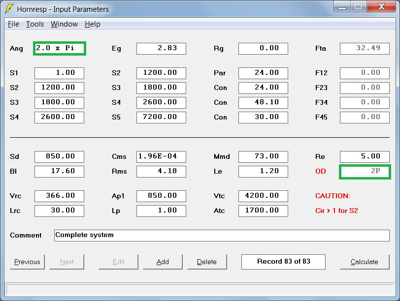

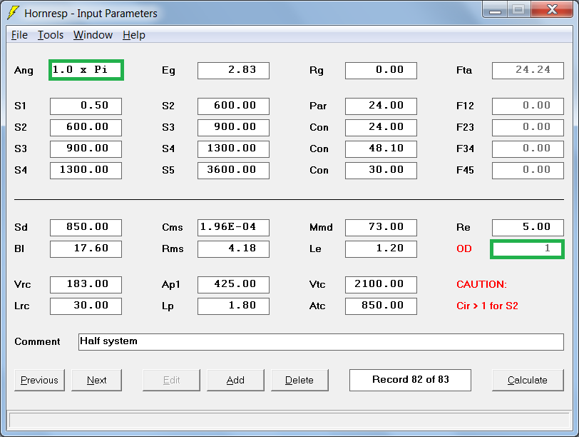

Hi zoomenok,
Another way you can get a start at simulating your box is to cut it in half, use only one driver, etc.. Are you sure your Vrc in 183L/6.5ft^3, looks a little smaller? Take a look @ the the annotated version of you picture for suggestions on area locations/flare. Use the manufacturer's T/S parameters, or get accurate measurements of your drivers at hand.
The attached two systems are equivalent, and the simulated power response results will be the same. If the complete system radiates into half space (2 Pi solid angle) then the half system needs to radiate into quarter space (1 Pi solid angle). If the half system has a single driver then the complete system needs to have two drivers connected in parallel (not series).
Otherwise the systems will not be equivalent, and the simulation results will not be the same.

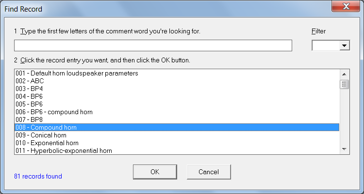

Hi java4ever,
It's not going to happen 🙂.
Press the End key to move to the last record. Press the Home key to move to the first record. Press the Page Up, Page Down or Enter key to move from one record to another. The Find tool can also be used to quickly locate a record.
