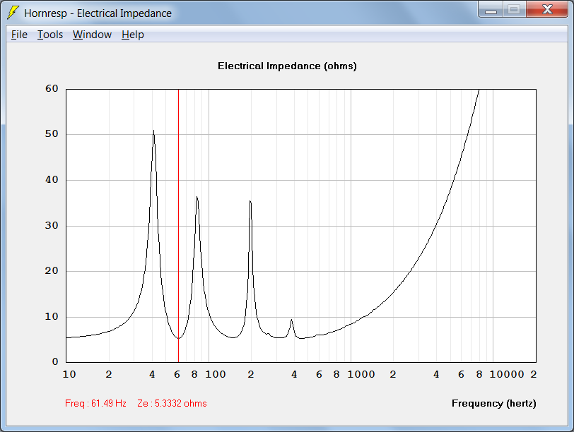

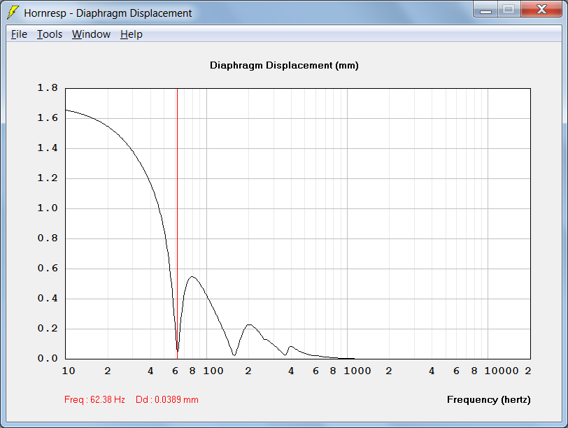

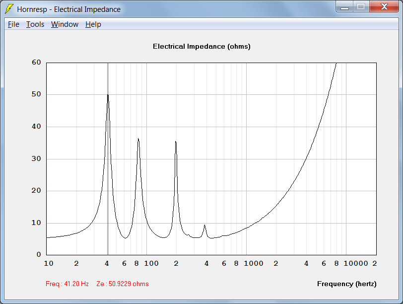

Hi Everyone,
Before I go any further and just so that I understand exactly what is required, given the attached impedance and displacement charts, can we reach a consensus on what is considered to be the 'lowest resonance frequency' of the sample system?
It would seem from recent posts that we have three options to choose from:
1. First impedance peak - 41.20 hertz.
2. First impedance minimum after the first peak - 61.49 hertz.
3. First displacement dip - 62.38 hertz.
(The frequency of first impedance minimum after the first peak is usually very close to the frequency of the first displacement dip).
What is the 'lowest resonance frequency' of this system?

Definitely not #1. Resonances happen between impedance peaks. Excursion is already way out of control at the lowest impedance peak so there's no point at all in marking the lowest impedance peak.
#2 might be more technically correct than #3 but it hardly makes any difference, it's less than 1 hz apart. if there's a question of which is easier to implement I'd go for the easier option between #2 and #3.
Definitely #3 - it is the only one which is directly acoustically related to the whole SPL output.
Theoretically, it's the mean between the two peaks IIRC, but don't know how HR calculates the peaks in #2 and dip in #3, which would theoretically be at the same frequency, so no clue why there's a slight offset. Regardless, I use #3 as it's plenty close enough.
Agreed.
