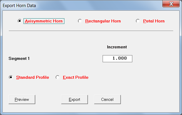

Hi Hajo,
If all you want to do is to calculate the "construction" dimensions of a given Le Cléac'h horn, then Hornresp can do this for you without the need for a copy of Jean-Michel's spreadsheet. Simply select File > Export > Horn Data from the Schematic Diagram window.

Hi Mark,
For axisymmetric Le Cléac'h horns, the Hornresp "Exact Profile" option exactly matches the theoretical ideal. The "Standard Profile" option gives an identical result to Jean-Michel's 2007 spreadsheet (which is a close approximation to the perfect profile, but not precisely the same).
See the following post for further details.
http://www.diyaudio.com/forums/multi-way/140190-jean-michel-lecleach-horns-114.html#post2619419
Kind regards,
David
