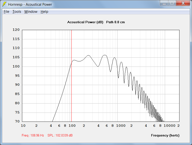

I have been looking through my text books as well.
Most of the comments up to date are correct.
But.
I'm not sure that every possible enclosure that can be modeled in Hornresp behaves in the same manner.
Closed and vented boxes are a no brainer.
Horns pretty easy.
Open baffle are again the peak in the electrical impedance.
Band pass Fb ( not the correct nomenclature for a band pass) will be similar to a vented box.
Compound horn should have a defined low frequency peak in impedance.
Something just is still making me search.
I think this is correct. Just not absolutely positive.

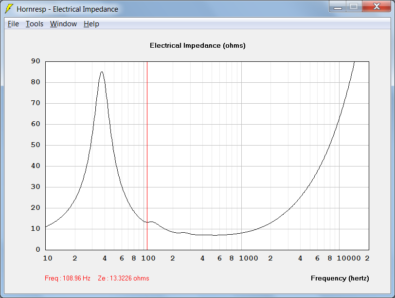

Resonance Frequency
Hi Everyone,
Thanks for your feedback.
My original plan was to test for the option #2 condition, but also to identify those cases in which the option #1 test should be applied instead. In light of your comments I will continue along those lines. The algorithm I intend using is relatively simple and fast, but seems to be remarkably resilient. It appears to give valid results for all the system configurations I have tested so far.
Incidentally, the reason I settled on testing electrical impedance is because in the more marginal cases it is easier to identify the resonance dip in the impedance curve than in the diaphragm displacement curve, as illustrated in the attached example. The algorithm can detect the slight resonance "dip" at 108.96 hertz in the impedance curve, but there is no such dip to be identified anywhere in the displacement curve. Also, the effect of the voice coil inductance can be masked when testing using the impedance curve, making it easier to identify resonance frequencies in the more "difficult" systems. In such cases, the displacement curve does not give any indication as to the position of the resonance frequency.
By definition, the resonance frequency is the frequency at which the imaginary or reactive part of the input impedance becomes zero. It is interesting to note that for some loudspeaker systems the frequency of interest is at an impedance maximum (similar to a parallel RLC resonant circuit) and for other systems it is at an impedance minimum (similar to a series RLC resonant circuit). In each case however, the reactive component of impedance at the frequency of interest is zero, consistent with the definition of resonance frequency.
In Hornresp I will refer to the "principal resonance frequency" rather than to the "lowest resonance frequency". Given the circumstances, I believe that it is a more accurate description.
Kind regards,
David

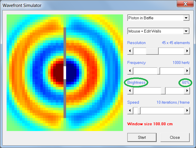

Hornresp Update 3960-160201
Hi Everyone,
CHANGE 1
Some minor changes have been made to the recently enhanced Wavefront Simulator.
In the previous release the "Brightness" slider was renamed as the "Level" slider. The slider caption has now been changed back to "Brightness", with the brightness value being given as a percentage. On reflection I decided that "Brightness" was a more meaningful description than "Level". See Attachment 1.
Previously it was possible to select "Add Baffle" when using the Custom Design option. This is no longer the case, since it was not applicable anyway.
Some other minor cosmetic refinements have also been made.

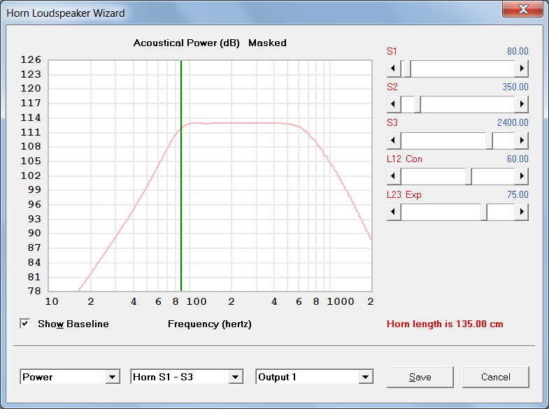

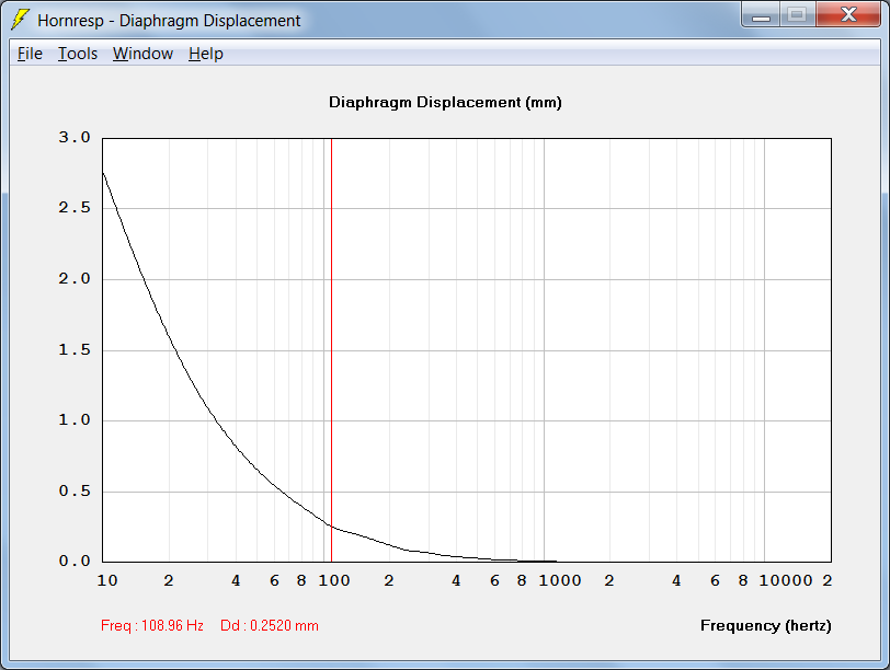

Requested by Brian in Post #5931.
A marker (vertical green line) indicating the principal resonance frequency can now be added to the Loudspeaker Wizard Power chart by double-clicking anywhere on the chart. The marker can be removed by pressing the Esc key. See Attachment 2.

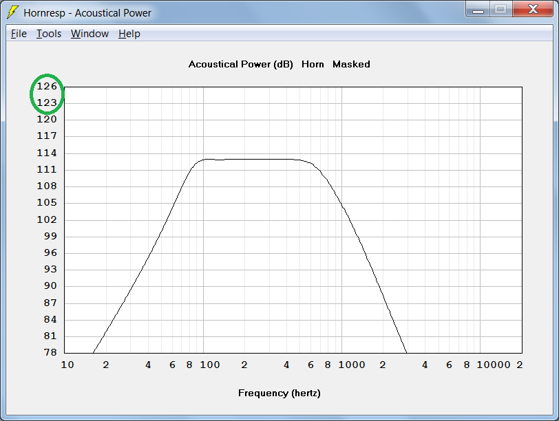

CHANGE 3
The SPL scale on all Power charts can now be changed from the default 5 dB increments to either 3 dB or 6 dB increments by double-clicking anywhere on the chart Y-axis vertical scale. See Attachment 3.

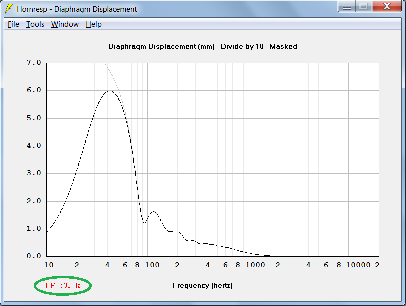

Requested by just a guy in Post #5954.

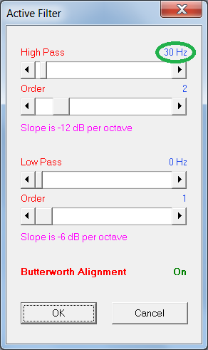

A high pass, low pass or band pass active filter can now be specified prior to calculating the main results. Select the Tools > Filter menu option from the Input Parameters window. The filter is not applicable when Eg is set to zero, or when Maximum SPL has been calculated. See Attachments 4 and 5.
Kind regards,
David
