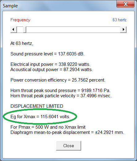

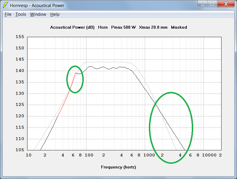

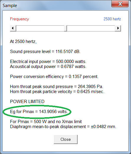

Hi Josh and Dan,
I have had a look at what would be required to implement the requested feature. The work that would have to be done to fully integrate the functionality would be considerable, and for that reason I am reluctant to take it on - particularly as the enhanced tool would really only be needed when wanting to directly compare the results of two different records.
It is of course already possible to observe the effects of voltage limiting for individual records. Using a copy of the Hornresp default record as an example, the process is as follows:
1. Set Eg to the amplifier maximum voltage (assume 100 volts).
2. Calculate the standard power response.
3. Calculate the Maximum SPL response (assume Pmax = 500 W and Xmax = 20 mm).
3. Press F4 to compare results.
Where the red or black trace is higher than the grey trace, the grey trace is the voltage-limited response.
Attachment 1 shows the compared results.
Attachment 2 shows the voltage at 63Hz (115.6 volts).
Attachment 3 shows the voltage at 2500Hz (143.9 volts).
The voltage at any frequency can be checked by moving the Sample tool slider. For the given example, the system will be voltage-limited at those frequencies where the sample voltage shown exceeds 100 volts.
In summary then, as you would have guessed by now - it's not going to happen 🙂.

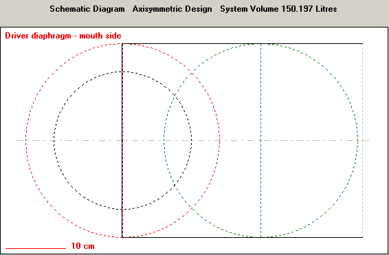

Not always Easy !
@ David McBean
Some people find it difficult transferring what the Schematic Diagram shows for some designs, into an actual real world drawing to be able to even contemplate building ! Sadly, i/m not afraid to admit i'm one of those. Even though i've been successfully designing/building Lots of enclosures over Many years, using R.Small's papers before we had comps & soft.
Here's just one example. How would you accurately actually draw this out in 3D on 2D on paper and/or screen ?
@ David McBean

@ David McBeanHow would you accurately actually draw this out in 3D on 2D on paper and/or screen ?
It's not a practical physical design - just because it can be drawn in the form shown, doesn't necessarily mean that it can be built.

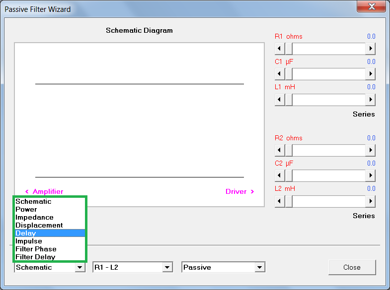

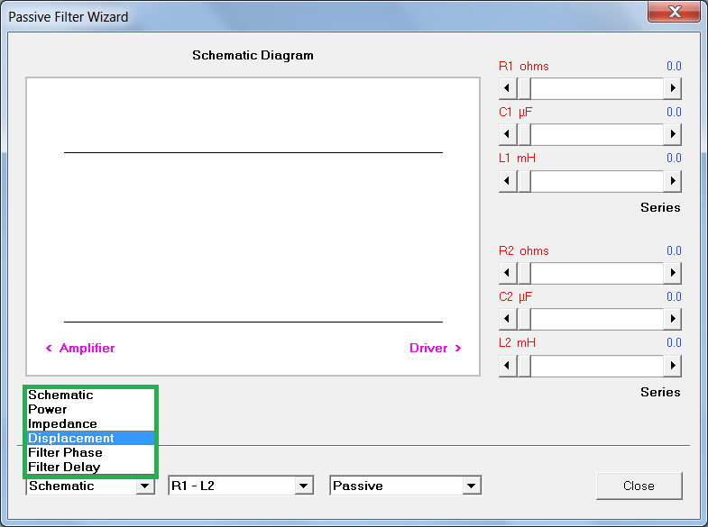

Hornresp Update 3970-160322
Hi Everyone,
In the last release a change was made to the Filter Wizard tool which prevented group delay or impulse response results from being calculated when either the Passive or Le Cléac'h filter option was selected, and Rg was non-zero (see Attachment 1). This restriction was imposed because the model used to calculate phase contained a small simplification which caused results to become slightly inaccurate when large values of Rg were specified.
Additional coding has now been added to eliminate the simplification in the model. The phase-dependent group delay and impulse response results remain accurate for all values of Rg and the recently-imposed limitation has been removed so that group delay, group delay per period and impulse response are now calculated under all conditions (see Attachment 2).
Numerous other changes have also been made to further "tidy up" the operation of the Filter Wizard tool.
Kind regards,
David
Hi Everyone,
Kind regards,
David

Hi Sabbelbacke,
Not a problem, glad you like it 🙂.
It was bugging me that the group delay and impulse response results couldn't be included under certain conditions - I had to do something about it!
Kaizen - continuous improvement 🙂.
