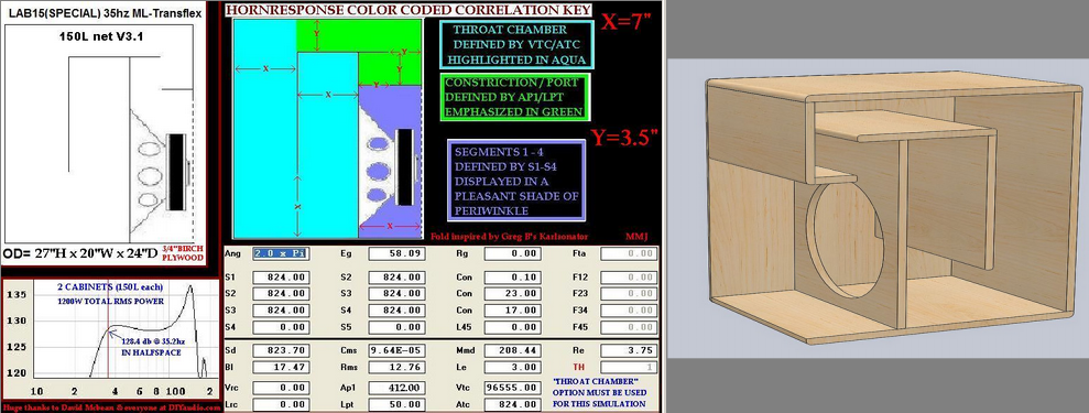

Please see the design in Post # 168 etc here http://www.diyaudio.com/forums/subw...subwoofer-4ohm-special-run-cheap-ebay-17.html & the HR file that you posted in # 174
The post linked below appears to give further details of the design in question:
http://www.diyaudio.com/forums/subw...ld-series-tuned-6th-order-56.html#post4039252
The drawing you kindly did in Post # 6136, looks nothing like in the above thread ?
That's because it is just the standard classic example of an object that can be drawn, but not physically built 🙂.
https://en.wikipedia.org/wiki/Impossible_trident
So i hope you can now understand how difficult it is sometimes to translate a sim into an actual build, with HR. If we could have a, what you Actually see is what you'll Actually get, that make a HUGE difference, to me and Lots of others too. Have a think about it & veave your magic
Hornresp has no idea what physical configuration the user has in mind when a system is simulated. The schematic diagram currently provided accurately reflects the inputs, and that is all that can be done. As the current case has highlighted though, it does help to know what the actual input values are, when trying to interpret some of the more envelope-stretching "escoteric" designs that creative diyAudio fanatics like 'Matthew Morgan J' and 'Patrick Bateman' keep coming up with 🙂.
Kind regards,
David

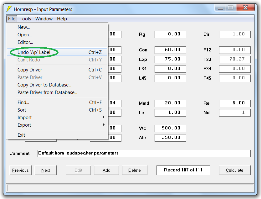

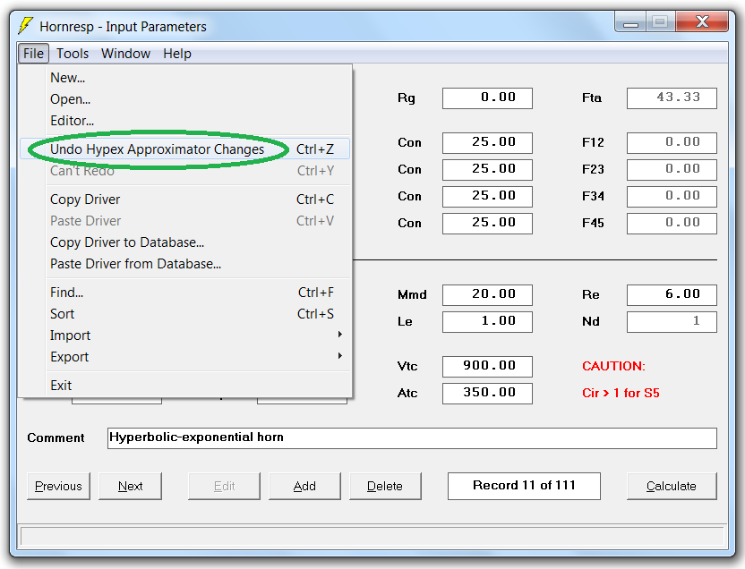

Hornresp Update 3970-160326
Hi Everyone,
The code controlling the Undo and Redo menu commands was not updated to take into account the Hypex Approximator when the tool was recently added. This oversight has now been corrected.
A number of other Undo / Redo "loose ends" have also been tidied up. For example, double-clicking of the Fr / Tal, Ap / Lpt and Ap1 / Lp labels was not being registered. This has now been fixed.
Kind regards,
David

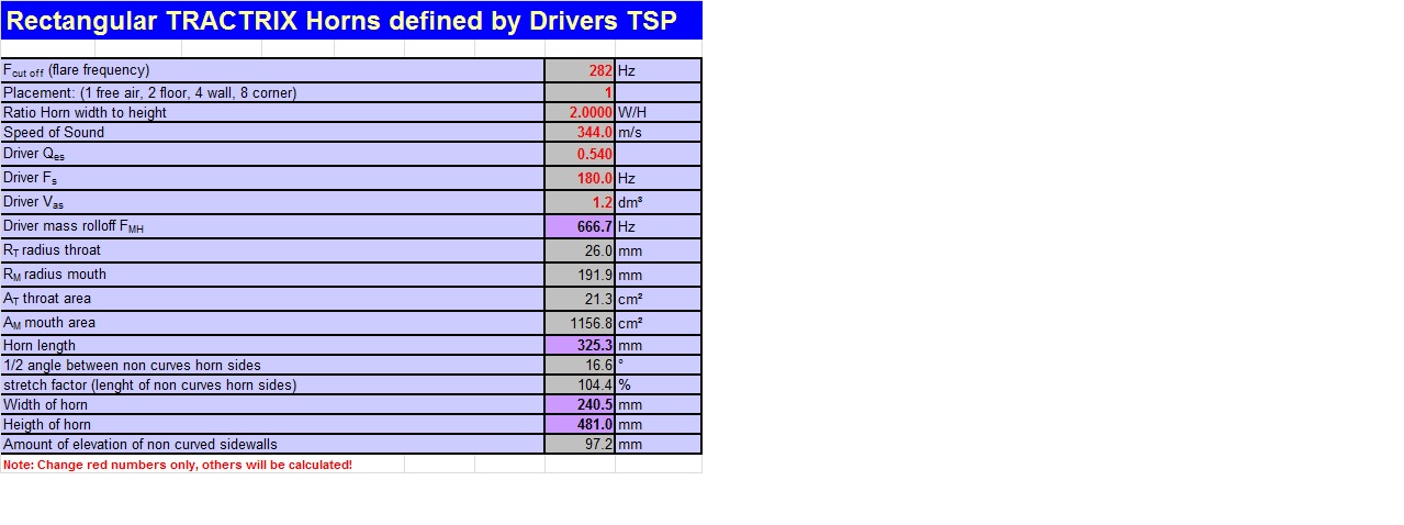

I'm designing my first horn along the lines of Bruce Edgar's 300Hz Tractrix and I'm getting confused along the way in how to use Hornresp.
I have selected a 5" cone driver: Faital pro M5N12-80, and I'm using Volvotreter's spreadsheet "Tractrix_v1.4b.xls". My understanding is the Excel spreadsheet is used to generate some inputs to Hornresp:
Thank you!!

- On the "Rect. Horns by Driver TSP" tab I enter 282Hz as flare cutoff frequency since I'd like to use the horn from 400Hz. Aspect ratio of 2:1, and Thiele-Smalll parameters of the driver. See attached. I get a throat area of 21.3cm2 and mouth area of 1157cm2.

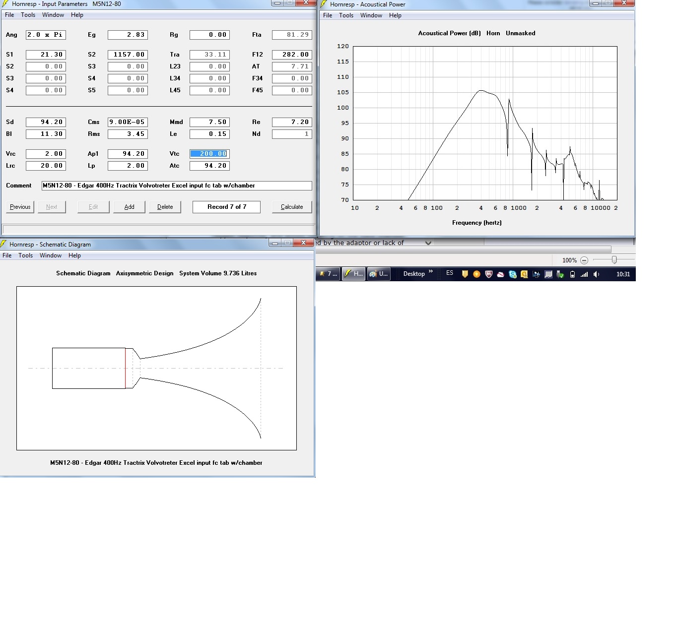

- On Hornresp I input:
- 2xPi angle
- M5N12-80 parameters
- Tractrix type, S1: 21.3cm2, S2: 1157cm2, F12: 282Hz, and let it calculate L12 to be 33.1cm (slightly longer than the spreadsheet's 32.5cm).
- Rear sealed chamber: 2 liters and 20cm long (guesstimate), with 4cm lining.
- Vtc I estimated in 200cm3 with the Hornresp utility, since I don't have the driver with me. And assumed Atc=Sd.
- Since Atc is 94.2cm2 and S1 is 21.3cm2 I asume I need a throat adaptor. Correct?
- If I don't use an adaptor the response is smooth. But it might be an artifact of a model that cannot be implemented in practice?
- If I use a 2cm adaptor going from Atc to S1, Hornresp shows a ragged response, and shows no lining on the back chamber. Not sure if the noise is introduced by the adaptor or lack of lining? I'm not finding a way to keep the sealed back chamber lined and also model an adaptor.
Thank you!!

Mark,
Thank you for the quick reply. Your measurements are significantly different from the Faital published data. I guess my best path forward is to use your measured data until I get the drivers and measure the ones I get. What do you recommend I use to measure drivers?
The Hornresp approach you suggested is yielding starnge results. The power response looks great, but the dimensions look unrealistic I think:
- S1: 3.8cm2 vs. Sd of 94cm2.
- Vtc of 3cm3...my estimation of the volume of air between cone and front is 200cm3. How could I get to 3cm3 having an Sd of 94cm2?
- Volume of rear chamber of 0.06 liters...

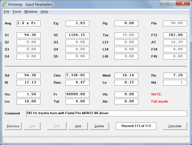

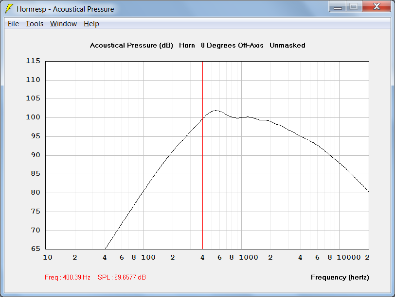

Hi LewinskiH01,
A possible design to get you started.
Assumptions:
Tractrix horn cutoff frequency:
Fc = 282 Hz
Driver parameters (from attached specification sheet):
Sd = 94.30 cm2
Re = 7.20 ohms
fs = 180 Hz
Vas = 0.93 litres
Qes = 0.59
Qms = 2.70
Le = 0.15 mH
Kind regards,
David

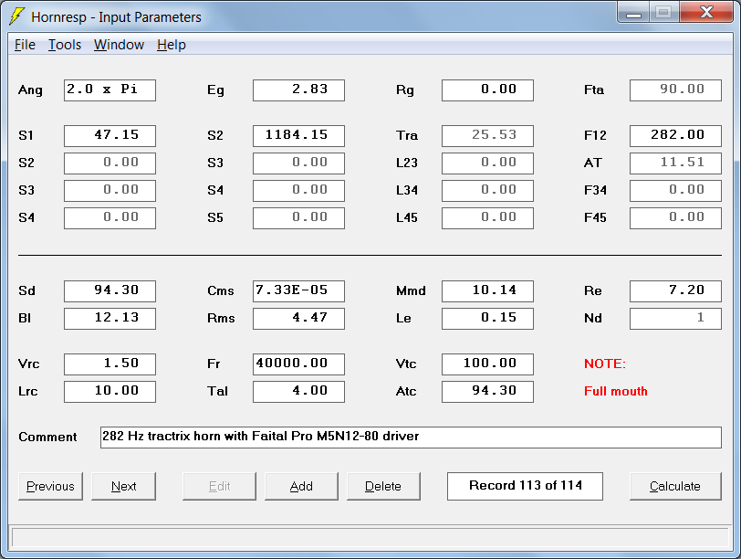

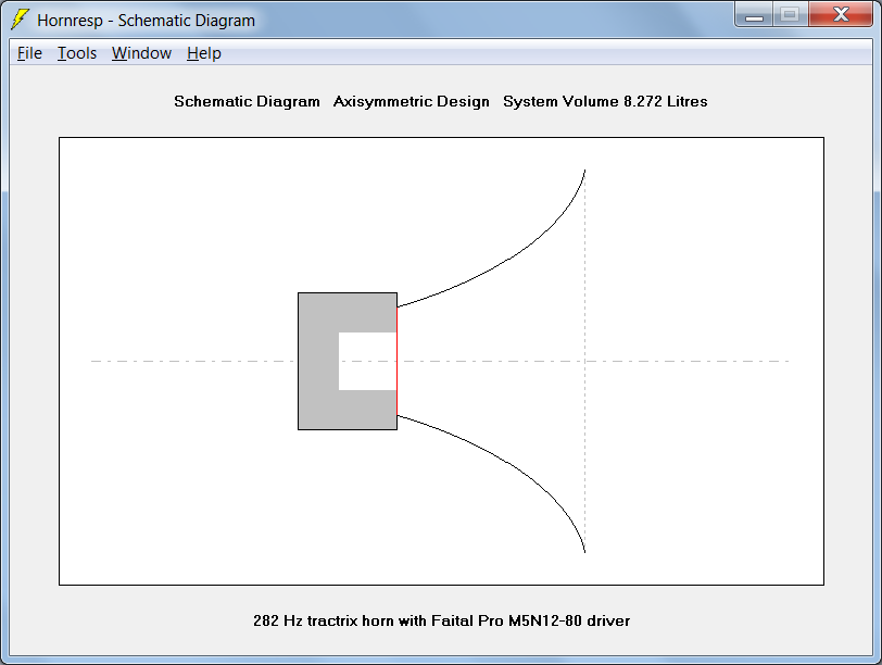

I should have clarified that efficiency was not a consideration.
Higher efficiency would require a throat area smaller than the driver Sd, necessitating a throat chamber.
Something like the attached design, for example.

Which midrange cone would you recommend for this? JBL CMCDs aren't available here, unfortunately.
Would sealing the basquet of the M5N12 get me into trouble in terms of thermal behaviour?
Thank you David.
My tweeters are 104dB/W, so that would be the ideal sensitivity for these. I modeled the horn you posted (the one with S1=47.15cm2) and sensitivity looks good from 380 to 1400Hz (@103dB/W). At what compression ratio would you estimate I will start to need a phase plug?
Over at another thread a guy who's knowledgeable about horns hinted Hornresp will be accurate at the lower end, but might underestimate sensitivity drop at the higher end - meaning past 2000 Hz in my case. Would you agree with that? The sim is showing 100dB/W at 2500Hz.
BTW, my system is fully computer based with digital signal processing available, so eq is available. Of course I would rather trim as little as possible.
