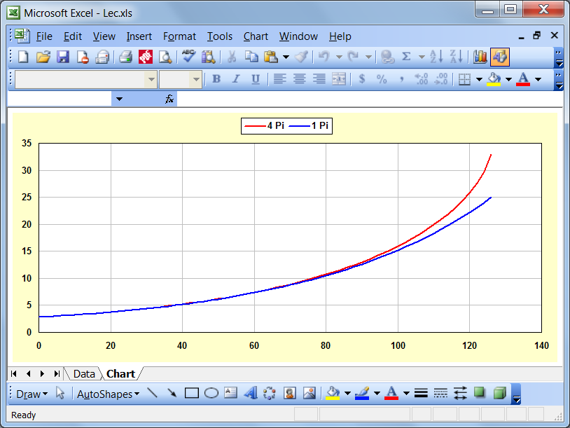

Hi AllenB,
Hopefully any discrepancies produced will not be significant in the frequency range of interest. Note that specifying a full-size Le Cléac'h horn in 4 Pi space then scaling down to 1/4 size, does not give the same profile as specifying a Le Cléac'h horn in 1 Pi space with a 1/4 size throat but similar length to the 4 Pi horn. To illustrate:
100Hz Le Cléac'h horn with T = 0.7 for operation in 4 Pi space:
S1 = 100.00
S2 = 16900.72
L12 = 126.85
Areas divided by 4 for operation in 1 Pi space:
S1/4 = 25.00
S2/4 = 4225.18
100 Hz Le Cléac'h horn with T = 0.7 for operation in 1 Pi space:
S1 = 25.00
S2 = 1961.95
L12 = 126.01
In the first case, S2/4 = 4225.18, quite different to S2 = 1961.95 in the second case.
The attached chart shows the difference in profiles.
Kind regards,
David

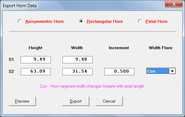

I have a question regarding a result I am getting when simulating a folded bass bin for a Kappa Pro 12a.
When simulating the same design in 2Pi the roll-off starts way later than simulating in 1Pi conditions. Why is that? I get that the bass should be boosted under such conditions and in relation, the lower mids would be attenuated... But here it just seems like the roll-off starts earlier, with only minimal extension of bass output if any. Where is my failure in understanding?
Export Rectangular Horn Utility

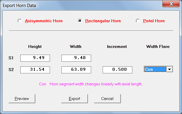

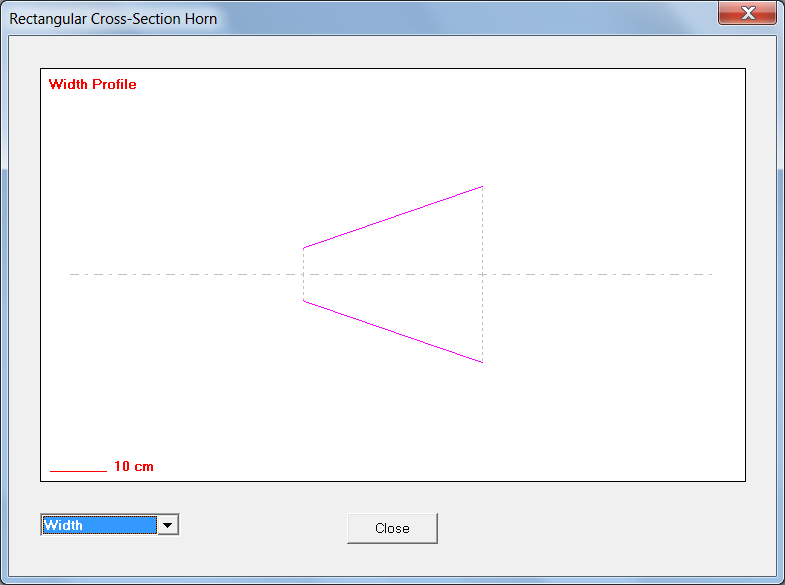

I'm evaluating a rectangular horn. Are these the correct steps?
- After simulating on Hornresp I decided on a Tractrix profile with Fc=215Hz, S1=90cm2, S2=1990cm2. This of course assumes an axis-symmetrical shape.
- I'm choosing a width:height ratio of 2:1. Hence a 631mm x 315mm rectangular mouth will basically equate S2.
- Then I go to Export Horn Data>Rectangular Horn>set the height & width for S1 (square) and S2 (per the above). But I can't set the width flare to be Tractrix...What should I choose to get an outcome as close as posible to the simulation done on 1)? And how far off should I expect the actual results to be from the simulation?
- Upon exporting, I get a txt file with 7 columns. Some are self-explanatory, but what are these:
- Length: this is the axial length measured from the throat.
- Side length: what is it? It's not the axial length...
- Top length: likewise...what is this?

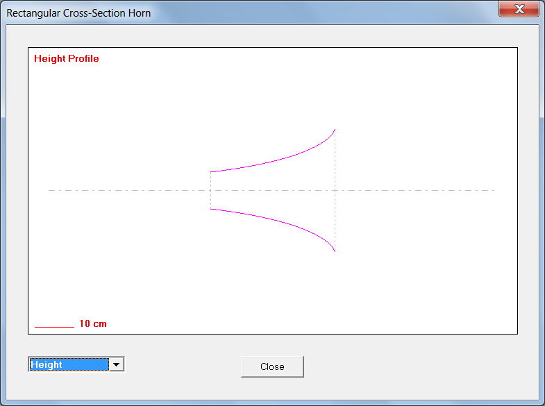

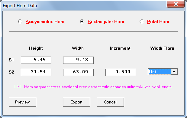

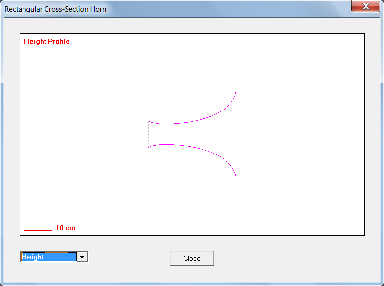

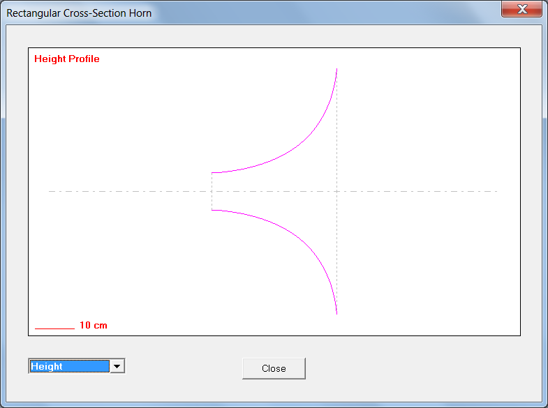

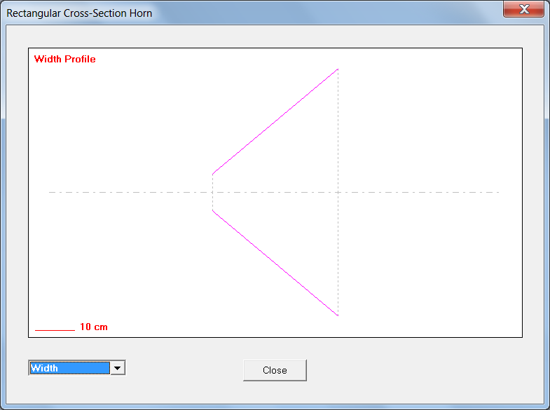

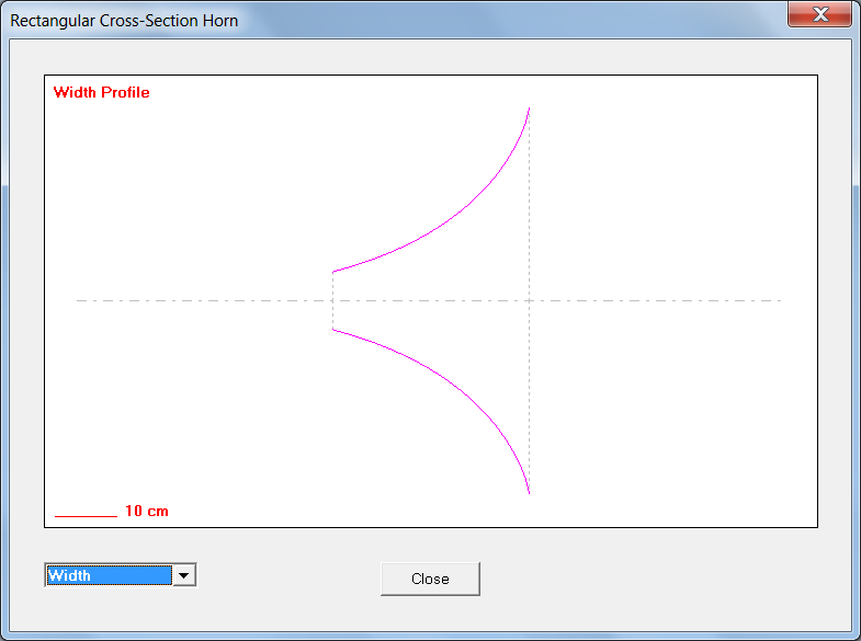

Hi LewinskiH01,
It won't make much difference to the power response which Width Flare setting is used, because the cross-sectional area expansion rates remain unchanged. Choose the option that you prefer, bearing in mind that the Con flare can be used to influence directivity characteristics.
Attachments 1 to 3 use the Uni Width Flare setting.
Attachments 4 to 6 use the Con Width Flare setting.
Attachments 7 to 9 use the Con Width Flare setting but with the S2 Height and Width dimensions reversed.
The Exp Width Flare setting can be used instead, if desired.
The power response results should not be that much different.
Side Len is length along the curved side panel. To make a side panel out of flexible plywood for example, take a flat plywood sheet and plot the Height/2 values against the Side Len values to get the required profile for the side panel (the Height/2 values need to be plotted above and below the central axis line). When bent to the correct curve shape, the side panel will fit perfectly.
Top Len is the length along the curved top panel, which is the same as the bottom panel. To make a top panel out of flexible plywood, take a flat plywood sheet and plot the Width/2 values against the Top Len values to get the required profile for the top panel (the Width/2 values need to be plotted above and below the central axis line). When bent to the correct curve shape, the top panel will fit perfectly.
Kind regards,

Hi LewinskiH01,
When I said that it won't make much difference to the power response, by power response I mean the acoustical power response (as distinct from the acoustical pressure response, which will depend upon the directivity characteristics of the rectangular horn).
That has to be your decision, not mine 🙂.
I am not familiar with Bruce's rectangular tractrix horn design, but yes - the constructed horn should be rotated through 90 degrees so that the conical width profile shown in Attachment 8 becomes the height profile of the horn when installed.
Kind regards,
