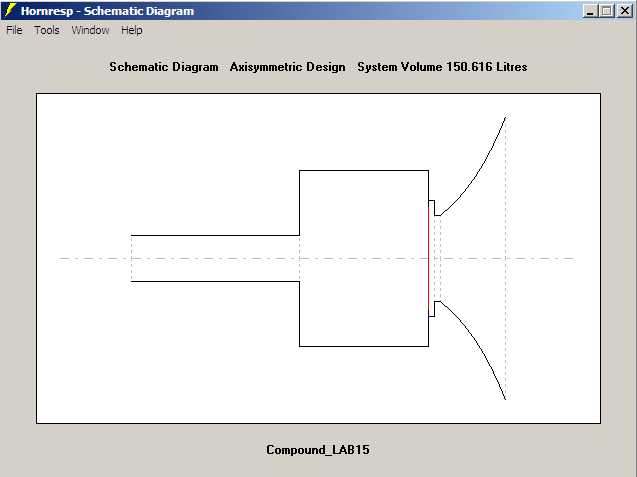

David I have been able to use some of the new features.
I like it!
I like it a lot!
Have a bit of a question in setting up a compound horn.
Bill Geiger has presented a interesting mass loaded tapped horn that I have been able to model correctly once.
Then my computer crashed and I have not been able to do it again.
Stupidity on my part.
The compound horn requires quite a large compression chamber to be modeled correctly.

Hi Mark,
I'll attach what I would consider a typical CH simulation. How did you get the tapped horn feature (front-to-back foldback) of whgeiger's design into a Hornresp compound horn?
P.S.: I added whgeiger's design pdf.

Hi Mark,
So, what is the question? 🙂.
Why do you call it a "mass loaded" tapped horn?
The simulation model developed by Oliver and linked in the post below is probably as close as you are going to get to Bill's design, using Hornresp.
http://www.diyaudio.com/forums/subw...binet-16-hz-organ-speaker-35.html#post4443937
Bill's suggested "reentrant" tapped horn design should not be modelled as a compound horn. A standard Bose Acoustic Wave Cannon type design on the other hand, should be.

did Bose change the design of the wave cannon? I recall it used to be a tube with two open ends and a driver.
Bose vs. Reflex AWC's
The Bose AWC design still remains as you describe. My implementation (RAWC) is closer to a tapped horn to get to a shorter physical length for the same acoustical length and to get the combined output coming out a single end. WHG
