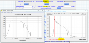

Yes, you are simulating sending 500W to the speaker.
I would expect that to result in high pressures, everywhere.
Obviously, however the estimate is 30-40dB larger than expected 😱
I think there is a small error somewhere in the code 😀
When I look at the soundpressure at the horn mouth it returns a very large number 😀

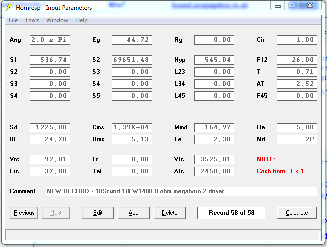

Hi Twellmann,
An excellent pickup, many thanks!
The horn mouth sound pressure is shown as being higher than the throat pressure, so there is obviously something wrong somewhere 🙂.
I will investigate, and let you know what I find. It may take a day or so. The error only applies to hyperbolic-exponential horns.
Kind regards,
David

Hi Twellmann,
Just letting you know that it's probably going to take considerably longer than "a day or so" 🙂.
The horn mouth sound pressure and particle velocity results for hyperbolic-exponential horns are not correct, but at the moment, I have no idea why. (The throat mouth pressure and particle velocity results are correct).
