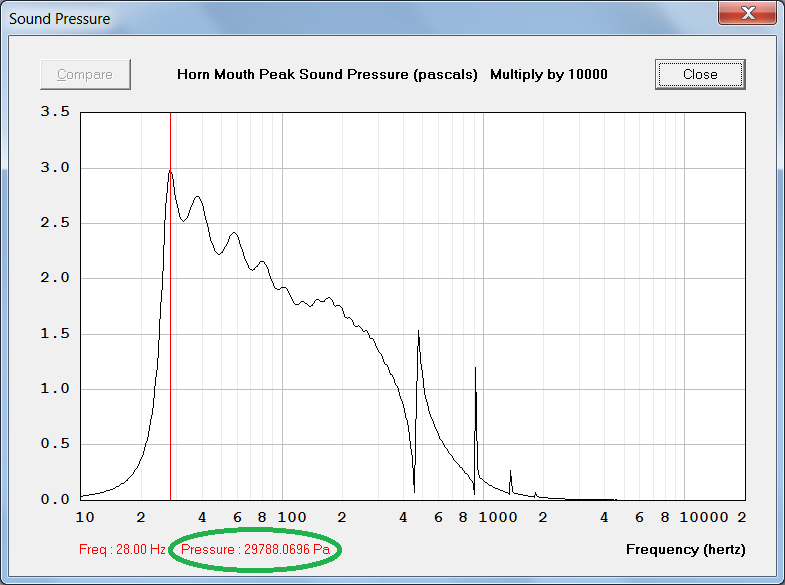

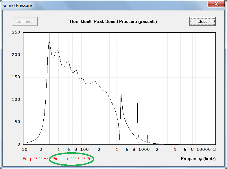

Hi Everyone,
The error detailed in Post #5734 has now been fixed. My thanks to Twellmann for reporting the problem.
For the test example given in Post #5734, the horn mouth peak sound pressure at 28 Hz has changed from 29788.0696 Pa to 229.5493 Pa.

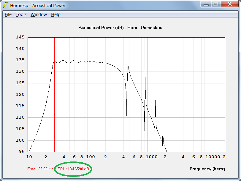

Sanity check:
Mouth peak pressure = 229.5493 Pa
Mouth rms or effective pressure = 229.5493 / Sqrt(2) = 162.3159 Pa
Mouth sound pressure level = 20 * Log10(162.3159 / (2 * 10 ^-5)) = 138.1866 dB
Half space SPL at distance of 1 metre = 134.6590 dB

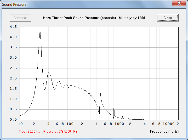

What is the comparable throat pressure?
Hi Andrew,
Throat peak pressure = 3797.3884 Pa
Throat rms or effective pressure = 3797.3884 / Sqrt(2) = 2685.1591 Pa
Throat sound pressure level = 20 * Log10(2685.1591 / (2 * 10 ^-5)) = 162.5588 dB
Kind regards,
David

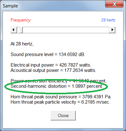

Hi Andrew,
Not when it's pressure due to sound 🙂. An effective pressure of 3.7 kPa is equivalent to an SPL of 165 dB.
It depends on the amount of distortion you are prepared to tolerate. The Hornresp Sample tool will give you the percentage second-harmonic distortion for single-segment horns.
