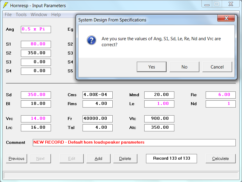

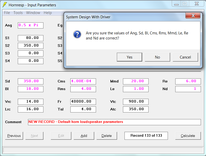

What is the difference when using:
System Design>with driver
System Design> from specifications
Hi chrapladm,
The 'System Design With Driver' tool automatically designs an "optimum performance" hyperbolic-exponential horn system given Ang, Sd, Bl, Cms, Rms, Mmd, Le, Re and Nd as inputs.
The 'System Design From Specifications' tool automatically designs an "optimum performance" hyperbolic-exponential horn system given Ang, S1, Sd, Le, Re, Nd and Vrc as inputs.

One further clarification.
David.
So this tool in it's two forms uses the driver data default. Or the user entered new driver data. It does not generate a data set for a driver.
David.
David.
When you use the system design from specs it automatically generates new values for CMS, MMD, BL and RMS (as well as some of the horn parameters), so yes, it absolutely is generating a data set for the driver. In fact this is the whole point of the system driver from specs tool, to generate the optimum driver and horn from a few inputs. The user inputs for SD, RE, LE and ND remain unchanged so those have to be correct but it generates new data for all other aspects of the driver. It takes 2 seconds to verify this.

Hi Mark,
The System Design tools use the parameters highlighted in pink as inputs. That's why Hornresp asks if those values are correct 🙂.
The values of all other parameters are outputs, calculated by the tools.
