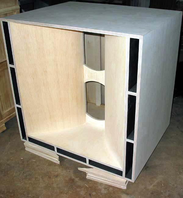

Hi David,
I see the compound horn as a specialty case, e.g.: the front horn, rear bass reflex, and I don't think they need a width slider function? I'll attach a picture of an example.
But, maybe somebody would use CH for a 1/4 wave simulation? I know I have used them for BP6, and then a width function might be interesting, as it would affect both volumes, and both ports. I have also miss-used it for H-frame dipoles.

Hi BP1Fanatic,
I wish. 🙂 This pictures came from artec-france.com. I don't know if you can still find these Onkens there? There are similar enclosures from all the great old companies, like Altec, etc..

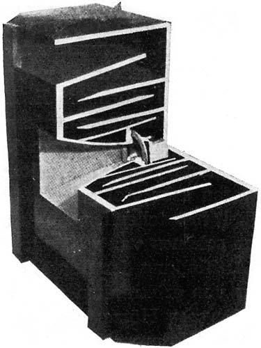

Attached is a photo of a compound horn loudspeaker developed by Olson and Massa in the mid 1930's. The single diaphragm is coupled to two horns - a straight-axis high-frequency horn (specified in Hornresp using S5, S6 and L56) and a folded low-frequency horn.

Hi David,
That will be a nice and worthwhile addition to Hornresp. Also, nice compound horn example.

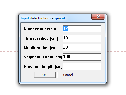

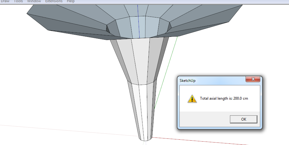

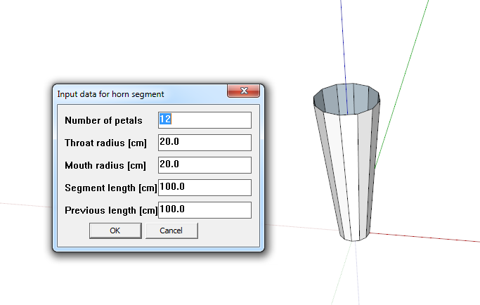

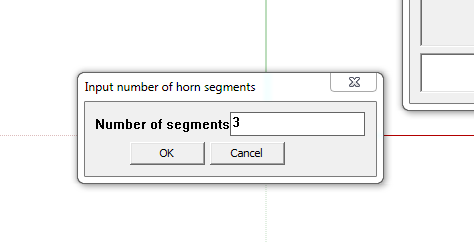

I have made a small plugin for Sketchup, where you can create a basic drawing of a multi segment conical petal horn.
When you have exported your design to a .csv file then the numbers can be plugged into the plugin.
In the first window you type in the number of conical segments, default is three. Then you type in the data for each segment. It will use the values from the previous step, so the mouth radius of the previous step is now the throat radius in the next.
There are no obvious limitations to the number of segments or petals other than what Sketchup can handle, so with enough patience you can make that wildly curved horn 😀

@ David McBean
Re post 5667
That mid 1930's Olson and Massa horn was way ahead of it's time !
I don't what it sounded like, but to achieve what they did Without a computer/software & the test equipment available since then, is remarkable 🙂
Thanx for posting 😉
Re post 5667
Thanx for posting 😉

Hi Zero D,
I suspect that it would have sounded surprisingly good. Harry Olson and Frank Massa really knew what they were doing, even though they only had slide rules and manual tabulating machines to help with crunching the numbers.
