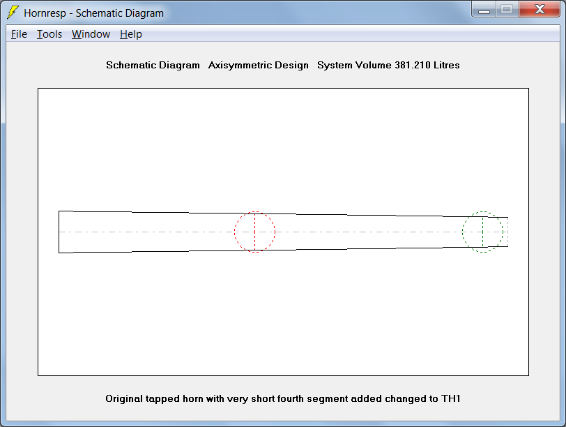

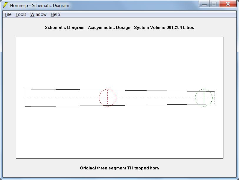

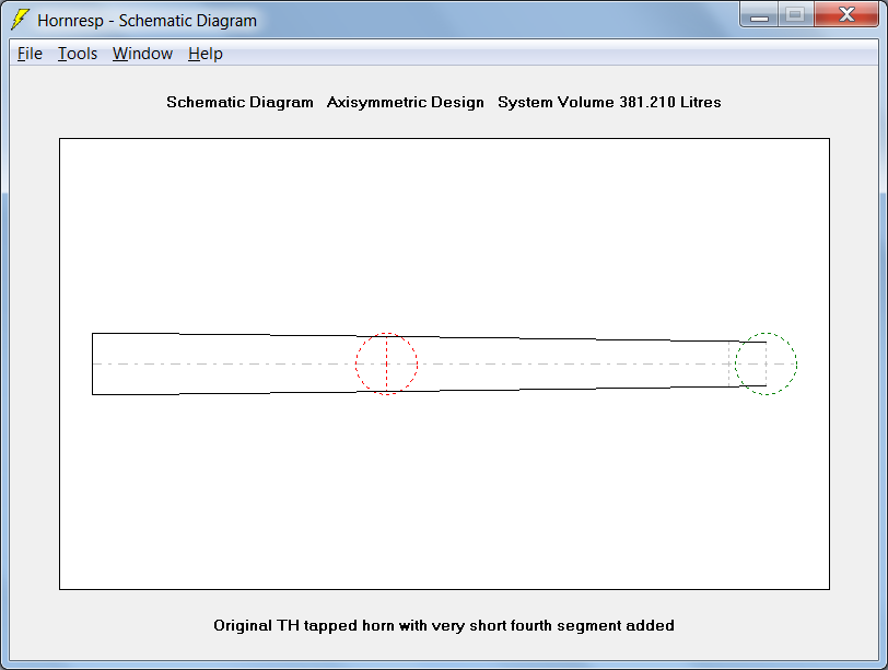

Then I tried to add a very short 4th segment setting S5=S4, flare same as segment 3, and L45 (now Par) to 0.01. The result just looks wrong, and it is not the same result I get when adding just 0.01 to L34 (which basically does not change the simulation result at all). I would have expected that setting S5=S4 and L45=0.01 would give a similar result. Maybe a bug?
Adding a fourth segment to a TH tapped horn shifts the second entry point from S3 to S4, which is why the result you are getting is so different. If you change the four segment system from TH to TH1 the S4 entry point will move back from S4 to S3, and the result will be virtually identical to the original one, as expected. If you check the schematic diagrams for the different cases, the differences will be immediately obvious. Attachments 2 (original) and 4 (TH1) are effectively the same, whereas Attachment 3 (4 segment TH) is quite different.
From the Tapped Horn section of the Help file:
"Driver entry points are at S2 and S3 for a three segment TH horn, S2 and S4 for a four segment TH horn, and S2 and S3 for a four segment TH1 horn."

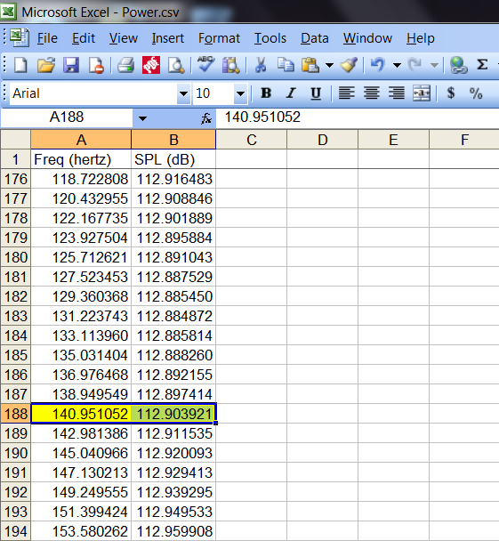

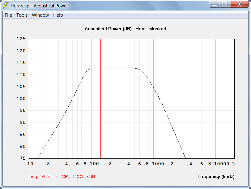

The number of frequency data points between 10Hz and 20000Hz is fixed at 533 so that:
1. The frequencies at points 1, 162, 323 and 484 are exactly 10Hz, 100Hz, 1000Hz and 10000Hz respectively. I do like things to be neat 🙂.
2. For the default 100% magnification display setting of 96 pixels per inch, and with the chart size used in Hornresp, there is a frequency data point at each pixel position, meaning that maximum frequency resolution is obtained.
The frequencies actually used can be seen by exporting the chart data, or by clicking the mouse on a chart (the frequencies are the same for the same data point in the list or on the screen, allowing for rounding).
The width of a Loudspeaker or Filter Wizard chart is the exactly the same as the distance from 10Hz to 2000Hz or from 100Hz to 20000Hz on the main chart, so that the frequency and pixel points match identically in all charts.
As you can see, the magic number of 533 data points in Hornresp is no arbitrary choice 🙂.
