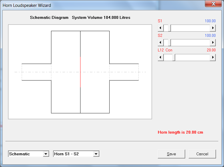

Forgive me if there's an obvious reason for not implementing it, but with the recent addition of a series tuned BP6 wizard would it not make sense to also include a parallel tuned BP6 wizard?
Hi zettairyouiki,
A wizard was not developed specifically for parallel-tuned 6th order bandpass enclosures because the configuration can already be simulated using the standard Loudspeaker Wizard.

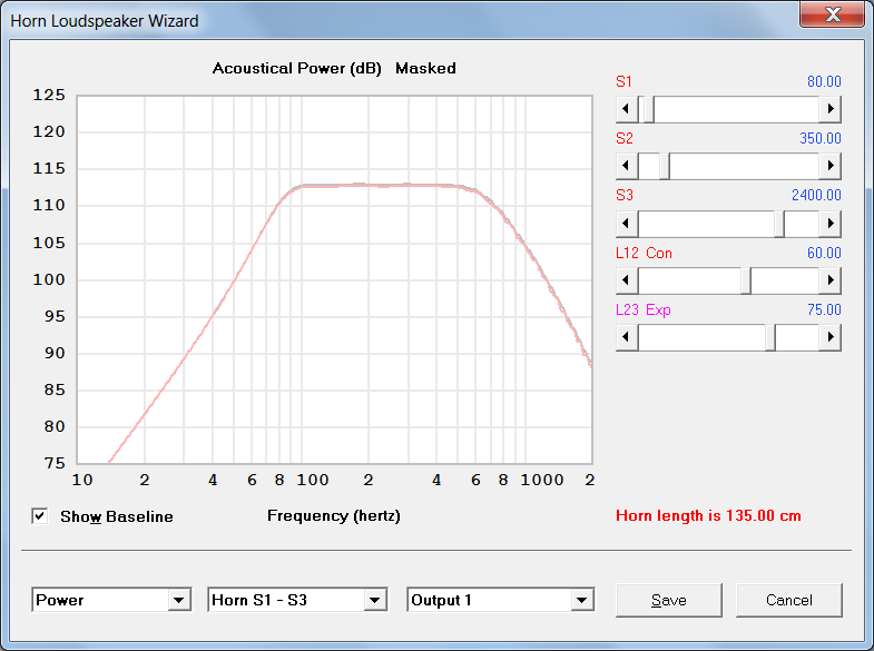

Also, i wonder if it's possible to account for us having a grille covering a mouth/face etc ?
As Mark says, at bass frequencies the effect of a fabric grille will be minimal. This can be readily shown by including a thin layer of suitably absorbent material at the horn mouth.
