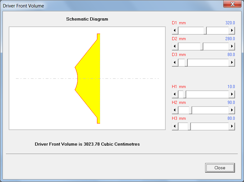

I've got a suggestion for a minor improvement.
HornResp currently has a "Driver Front Volume" feature which can be used to calculate, well, the volume in front of the driver.
Would it be possible to also include the calculated CSA through the center of the driver's cone as well? That would be useful for chaps like me who are looking at ways of including "cone compensation" in our builds, like the example attached.
Hi Brian,
Just to clarify, when you say the calculated CSA through the centre of the driver's cone, do you mean the cross-sectional area as highlighted in yellow in the attachment? If not, could you please provide further information.
Kind regards,
David
Yup, that's it exactly. I think just an extra line in that provides the CSA at that point should be enough.

Hi David. cone correction = cone compensation = accounting for the volume of air trapped in the driver's cone. I'll have to stick to using only one of those terms in the future to avoid confusion 🙂.
I'd say you're correct on all three for the most part. On 3, the constriction can be emulated as you suggested if the TH is laid out accordingly, but I'm not sure that approach would work for how the restriction at S2 is implemented in a design like the TH115.
On the CSA thing, my thinking at the time was that providing an idea of the CSA through the center of the driver's cone would give an idea of how much the CSA @ S2 would have to be reduced to compensate, but maybe I should just look at the issue in terms of volumes rather than CSA.
Hi Brian,
I can certainly provide the CSA information if it would be of any value to you, but if the aim of the exercise is to make the effective total both-way cross-sectional area at the offset horn entry point equal to that of the driver diaphragm, then perhaps a simpler approach would be to set S2 = Sd / 2. That should be close enough for all practical purposes.
Please let me know if you would still like the CSA information to be provided.

Thanks David. I don't think it will be required at this point, as it seems for bass-horn use all that's necessary is to ensure that the front-side cone volume is accounted for in the sim, which is easily done via increasing Vtc accordingly. My little test suggests that this is good for sims up to 300 Hz for a TH based on a 12" driver, way higher than such a TH would normally be used.
http://www.diyaudio.com/forums/subwoofers/276742-cone-compensation-test-case-5.html#post4381569

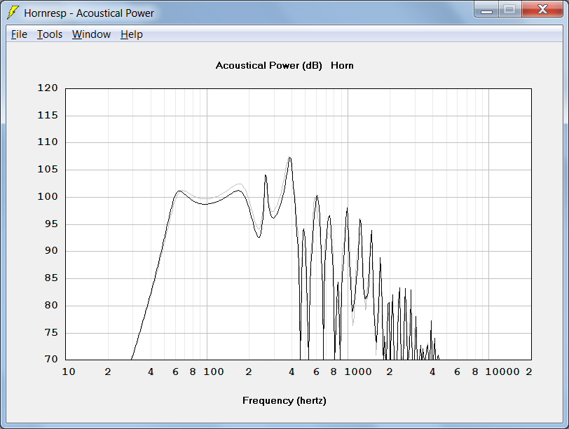

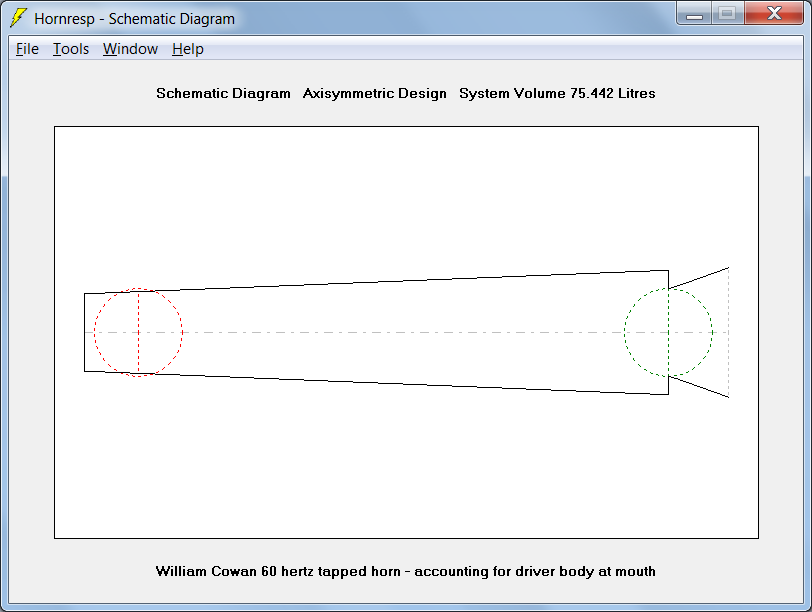

Now, about accounting for the volume displaced by the driver's body sitting in the mouth of a TH.... 🙂.
Hi Brian,
Excellent, I was hoping you would say that - it saves me some work 🙂.
Provided that the airway is not unduly obstructed, the impact on the overall result should not be great. Out of interest, I tried halving the cross-sectional area at the mouth entry point on a standard reference design, to account for the presence of the driver body.
Attachment 1 shows the standard design.
Attachment 2 shows the modified design, with area at the mouth entry point reduced to account for the driver body.
Attachment 3 shows the response of the standard design (grey trace) compared to the response of the modified design (black trace).
The effect on the response would be more significant if the orientation of the driver was reversed - that is, if the body of the driver intruded at the throat end rather than at the mouth end of the tapped horn.
Kind regards,
