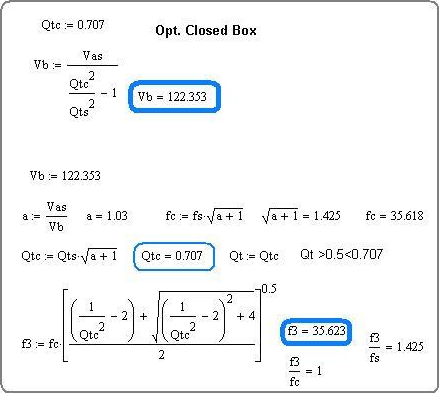

One thing I have noticed is that Qtc is often expressed as Qts * Sqrt(a + 1) where a = Vas / Vb. Note that this formula for Qtc is an approximation only - the value of Qtc so calculated should be considered as indicative only, and not used for system design purposes. Hornresp does not use this formula.

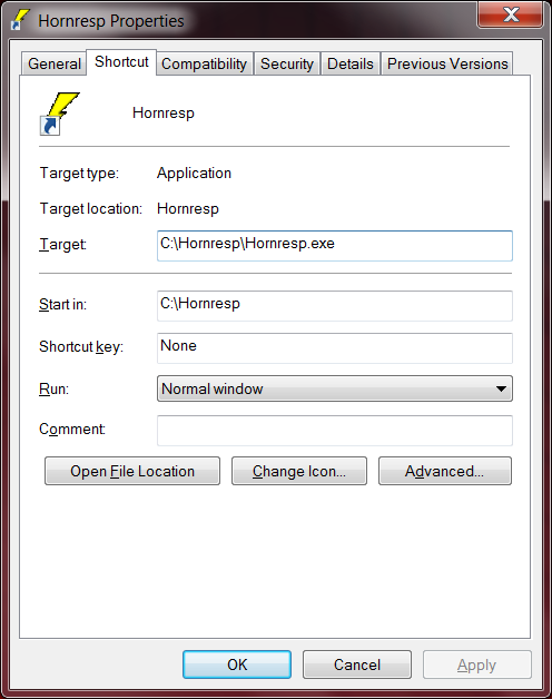

Hi leadcoma,
Many thanks for this feedback - very strange indeed!
Q1. Does the Hornresp folder under C:\Users\me\Appdata\Local\VirtualStore\Program Files (x86) contain any files?
Q2. Does the Hornresp folder under C:\Hornresp contain the files Hornresp.exe, Hornresp.hlp, Msvbvm60.dll and Readme.txt?
Q3. Does the Hornresp folder under C:\Hornresp have four sub-folders named Data, Drivers, Export and Import?
Q4. When you look at the Properties of the shortcut, what paths are shown in the Target: and Start in: text boxes?
Thanks again, and kind regards,

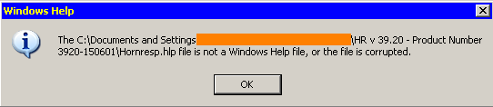

I can open the HF in HR with no issues. But if i double click on the HF in the HR folder, windows doesn't recognise it ? No big deal, just a heads up. XP/SP2.
Also, the HF can't be enlarged, on my comp anyway, but if i copy the HF & change the extension to .txt instead of .hlp it can. This can only be displayed as a .txt file like this, if i manually double click on it from the HR folder, or if it's placed anywhere else for that matter.
Again, those things aren't mega important, or urgent !

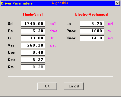

Accessing/changing the T/S parameters quickly.
I discovered this by accident today ! Click on Sd & up pops an editable dialogue box. Some of you might not be aware of it, but you will be now ;)

Hi David,
Q1: Many folders/files from different programs
Q2: Yes
Q3: No
Q4: The path is C:\Hornresp in both text boxes
cheers

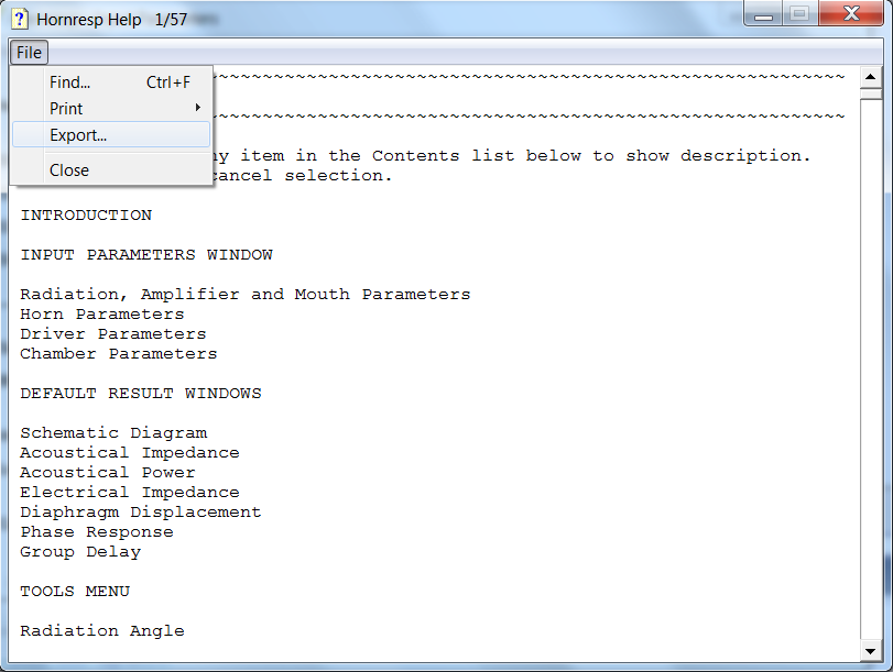

It is intended that the Help file be opened from within Hornresp, either by using the Help menu or by pressing the F1 function key.
Once opened, the Help file can be saved as a stand-alone text file by selecting the File > Export menu command, as shown in the attachment. The contents of the exported text file can then be viewed using Notepad, Word, or similar, and enlarged / edited as you wish.
If for some reason you want to directly read the contents of the actual Hornresp.hlp file itself, then right-click on the filename in Windows Explorer, select the 'Open with...' option from the pop-up menu, and specify the application that you wish to use to open the file (usually Notepad or Word).
I discovered this by accident today ! Click on Sd & up pops an editable dialogue box.)
Just to clarify - you have to double-click on the Sd text box in edit mode.
It's documented in the Calculate Parameter section under the TOOLS MENU heading in the Help file :).
