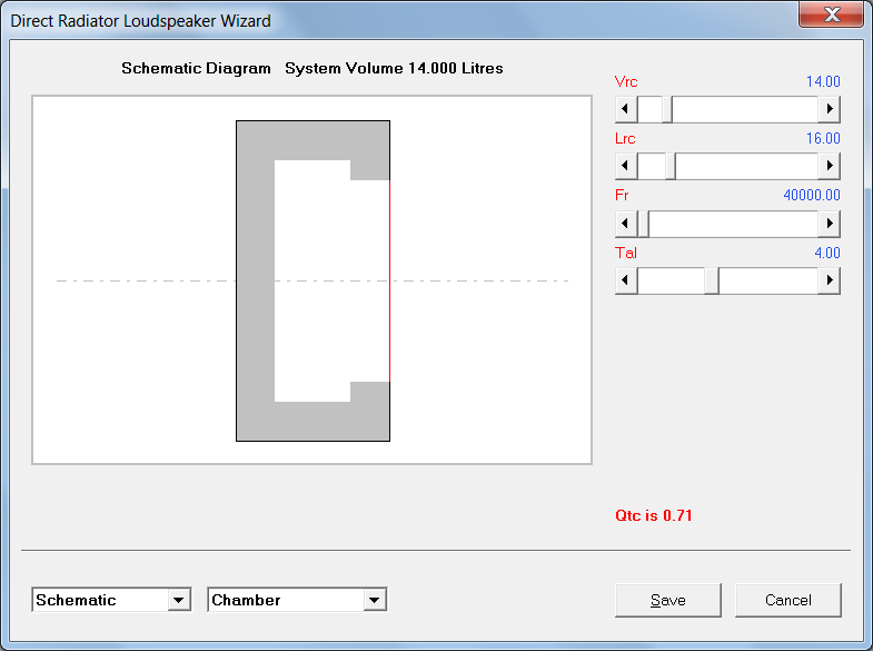

Going back to the direct radiator. About the only thing I need to duck into something like Unibox for these days is to check the box Q for a sealed rear chamber/direct radiator. Could you possibly pop that up somewhere in the Loudspeaker Wizard, perhaps on the gray area of the Power/Chamber screen in the wizard?
By "box Q", do you mean the value of parameter Qtc?

Yes, I meant the Qtc
Thanks for the confirmation. How would you use the Qtc information if it was provided? Isn't it just a matter of selecting a suitable driver and then adjusting the Vrc slider to achieve the best possible response?

How would I use Qtc? For a horn, it probably is indeed as simple as adjusting Vrc for best response. For a sealed direct radiator, common belief is that system Q is important and affects the sound as its indicative of damping. Too high a Q is obvious in the peaking. Too low a Q may not be so obvious. For me there is a comfort factor in knowing that the Qtc is in the range of .57 to .7 even if I'm going to equalize to a different response shape later. I do indeed adjust Vrc for best response or to fit my constraints but then I determine Qtc as a cross check. If its outside the target range, I will re-consider what I've done.
Thanks for the information on how you use Qtc. Any value calculated by Hornresp would not take into account absorption or leakage losses, would this still be okay? If so, then I can try to include something in the next release.

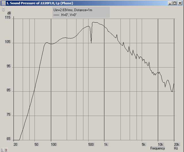

Hi David,

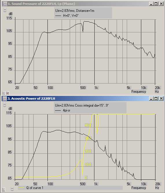

I just exported a Hornresp simulation into AkAbak, and the SPL curves look somewhat different. Is this just because of the way they are displayed?
I'll attach the simulations and the screen prints, hope you'll have a moment to take a look at this. ( To upload to diyaudio I had to change the extension of the AkAbak file 2220FLH_aks.txt, change back to 2220FLH.aks to use.)

Hi Oliver,
If you do it as an ND/BR you can choose horn output and then look at on axis response.

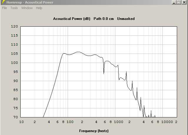

Hi Oliver,
If you calculate power response rather than pressure response in AkAbak, the results should be effectively identical to those generated by Hornresp using the "resonances unmasked" option. Unfortunately I cannot confirm this for myself as I can no longer run AkAbak :).

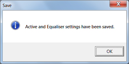

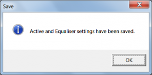

Hi Jack,
Q1. Do you have a Microsoft Windows Operating System?
Q2. Do you get the attached message when you press F9 to save the Equaliser settings?
Kind regards,
David

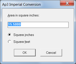

The F6 Imperial Conversion tool now also works with BP6, BP8 and ABC records.
My thanks to Dan for jogging my memory with his Post #5520.

The value of total quality factor Qtc is now shown when the Chamber input parameters option is selected in the Loudspeaker Wizard and a direct radiator closed-box system has been specified.
Jack's request in Post #5541 refers.
