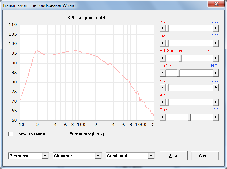

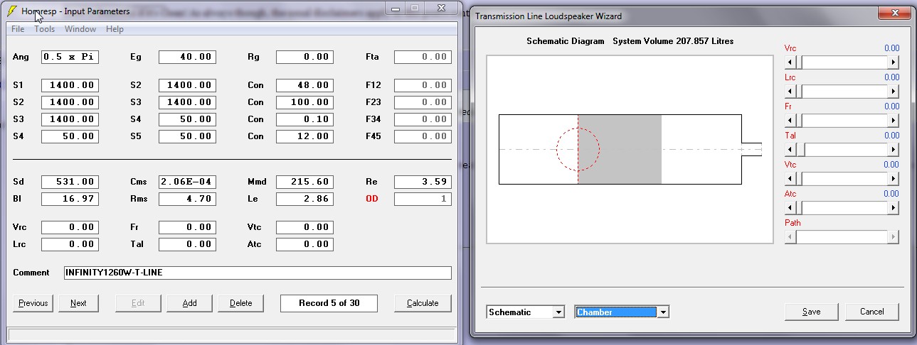

Only what is that gray around the speaker? seems damping but I have not put that in hornresp and I don,t get it away.
Hi Kees,
Are you sure that there is no absorbent filling in the second segment of your design? It seems that you would need Fr1 ~ 300 mks rayls/m and Tal1 ~ 50% to get the response you are showing. See attached screenprint.
Would it be possible to export a copy of the Hornresp record and post the *.txt file? Thanks.
Kind regards,
David
Yes I think also, I get it not cleared, I did set it on zero but still it exists, I miss something, but David can clear this in a glitch..
Let me see your sim, how it looks with you?
my sim don,t look bad, nice low and efficienty.
OK, learned how to add damping……….. I’m guessing you only set the ‘segment 1’ to zero, so double click on it to move it to ‘segment 2’ to set it at zero. There’s a ‘segment 3 & 4’ available also available to ‘stuff’.

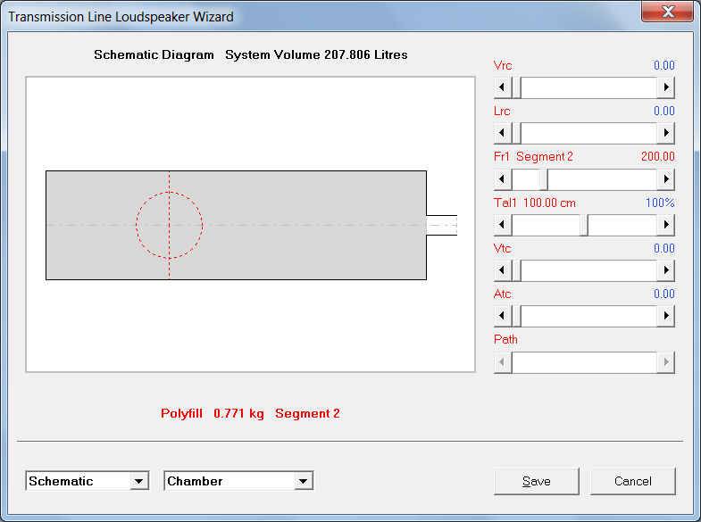

WRT your sim, I suggest setting ‘segment 1 & 2’ @ 200 and increasing [S4], [S5] to at least 100 cm^2 and increasing [L45] up to 16 cm.
I’ve no clue what a [Fr1] = 200 equates to WRT how much polyfil/whatever is required though.
GM
Hi GM,
Select the Schematic and Chamber options. The total weight of Polyfill is shown beneath the schematic diagram. Double-click on the red Polyfill message to show the weight in the currently selected segment.
It's all in the Loudspeaker Wizard section of the Help file 🙂.
Kind regards,
David
Unfortunately you cannot open the help when you are inside Loudspeaker Wizard. If you open the help before the wizard, you still cannot scroll the help file. So these questions end up here 😀
Hi Kees,
Kind regards,
David
Hi David
Ik have all 0.00 and I see also no sections where it is, if I right it have to be the second section who I can not found. But maybe I am sleepy, and see not well now, busy with vriend in hospital, I do take care of good friend,s in this case a woman.
And as always the simplest things are the most complicated.

I did try a ML-TL with the infinity woofer who is not yet used.
I can get if I have believe hornresp that is a nice sub, looks only port is quite small, (noice). box is bigger then normal.
regards
I have found how to remove the stuffing, just type F9 and you see all the hidden stuff.
