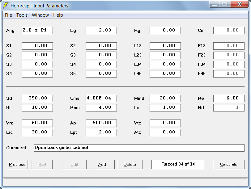

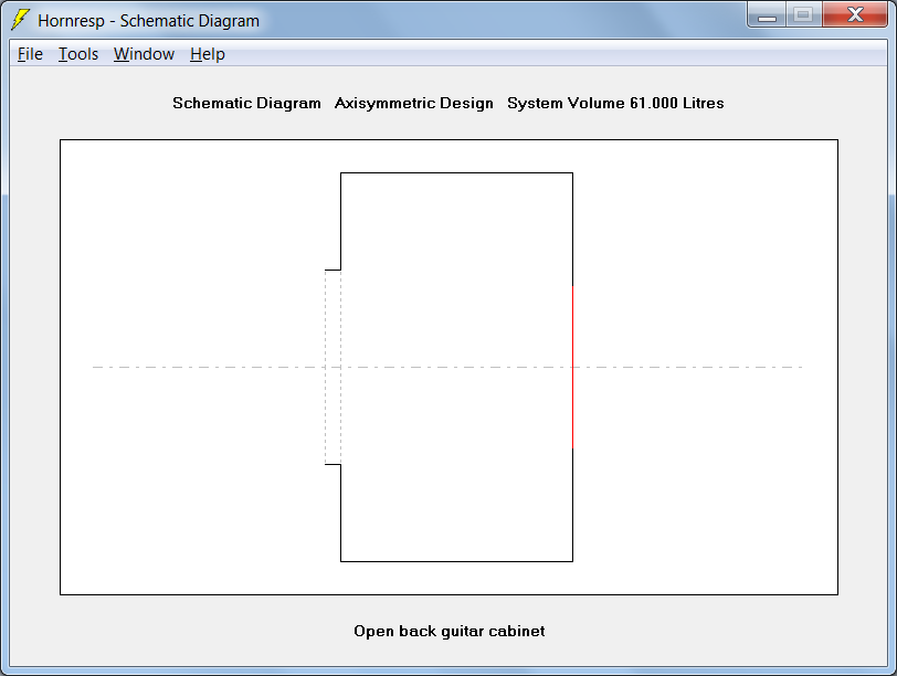

I have a huge pile of older speakers I might try to repurpose in open-back guitar type cabinets. It is possible in Hornresp to simulate the effect of that type of enclosure? Thanks.
Hi DHAA,
See attached screenprints. Lpt is the thickness of the rear panel.
Kind regards,
David

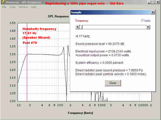

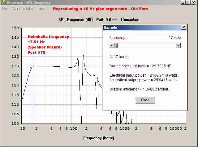

Just had something happening I don't understand, I opened Hornresp and entered a simulation, then hit Calculate, Tools-Combinded Response, Tools-Sample-typed 17 in the slider bar and hit enter, and ended up with an incorrect SPl in the Sample window, and the sample wndow is bigger than normal.
Once I realized the error I started over, opened Hornresp and went through the same sequence...now the result is correct, and I cannot make this one repeat.
Any thoughts?

Firstly, you get top marks for taking a screenprint of the problem - it helps immensely!
For some reason, the first sample result applies to the default SPL response chart even though the combined response chart is shown. So far, I have not been able to track down the cause - it may take a while, particularly if we can't replicate the problem and establish the precise sequence of events leading to the incorrect sample results.
Thanks for reporting the problem.

I think I might have finally found the cause of the problem - it was an exceedingly tricky one to track down!
Is there any chance that you could have done the following?
1. Calculate default SPL response.
2. Calculate combined response.
3. Open loudspeaker wizard.
4. Select Response and Default options.
5. Cancel loudspeaker wizard.
6. Sample SPL response chart.
If so, then the problem is easily fixed 🙂.
