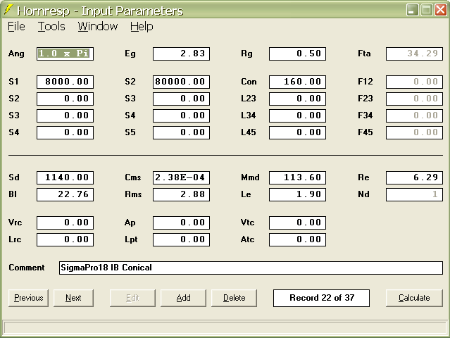

The sketch is just a preliminary idea. Not yet a certain goal. But I'd love to know its potential.
If the time allowed, please thow in the following numbers:
20-80Hz, 500 liter, and the driver's parameters as below:
SigmaPro18_zps56235b6d.png~original
Thanks a lot :D

Using a pair of Beyma 18 inch G550's mounted asymmetrically (push-pull) in a 6 in wide x 21 in tall x 18 in deep slot with 3 cubic foot chambers on the back of each driver, and each chamber connected to the slot with a 3.5 in wide x 21 in tall x 15 in long (one 90 deg bend) vent leading to the common slot, and a 8 in deep x 12 in wide front horn connected to the 6 in wide slot, we get the following response into 2 pi at xmax of 9 mm. The magnet of one of the drivers will hang into the cone cavity of the other driver by 0.5 inch. It has a peak following the bandpass similar to a TH. The overall dimensions are 24 in wide x 21 in tall x 28 in deep.
Response with with 27 Hz HPF but no LPF at 2.83 volts showing -3dB point at 31 Hz and 100 dB sensitivity:
Response with both HPF and 110 Hz LPF applied at xmax (9 mm):
Cone displacement at xmax drive of 44 volts:
Velocities in vents and slot:
Impedance:
As this is the Hornresp thread, this is OT, so I will follow up any more on a new thread in Subwoofer forum.
Edit: CLS, Just saw your post for 20-80 Hz and 500 liters. This design is only 230 liters so there is room to go deeper but will have to modify to use your drivers. Can you get me T/S params in terms of Qes, Qms, Re, Le, Vas, Bl, Mms, etc? then I don't have to convert the style Hornresp uses.
