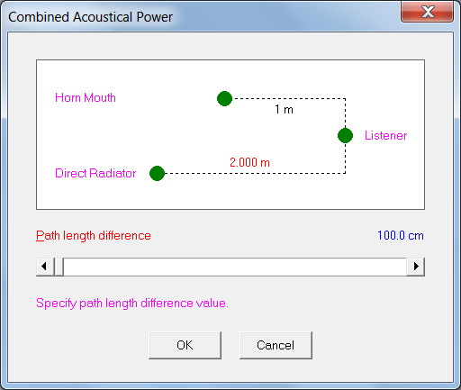

Yes, the confusion only set in after reading the text in the example (it made me change my mind).
Post #4477: "...revert back to the original text-based input form..."
Please, stay with the graphic description - as long as we know, that the bold green dots are the locations of Direct Radiator/Port Outlet/Listener, and the red line indicates the difference - it is much clearer than the text-based input form.
Post #4477: "If you ignore the text description (which perhaps I should remove from the Help file to avoid any ongoing confusion, because it also just applies to a direct radiator in a vented-box enclosure) does viewing the original schematic in isolation make sense - that is, is it clear that the direct radiator is further away from the listener than is the port outlet, and that the offset difference is 20 cm?"

And the Decision is...
Hi Oliver, Andrew and Zero D,
Thanks for your valuable feedback. I have taken careful note of all your comments, and have ultimately decided to go with the "second alternative" schematic layout proposal, as shown in the attachment. Although the path length difference is not specifically indicated in the diagram, it is nevertheless the simplest and "cleanest" overall representation, and hopefully there is no ambiguity as to how it should be interpreted.
I am using centimetres as the unit for path length difference and metres as the unit for the overall path length because they seem to me to be the most appropriate for the ranges of values likely to be encountered in each case. I trust that this will not confuse too many people.
The text description will be retained in the Help file on the understanding that it applies to a bass-reflex system.
The above changes will be made in the next release.

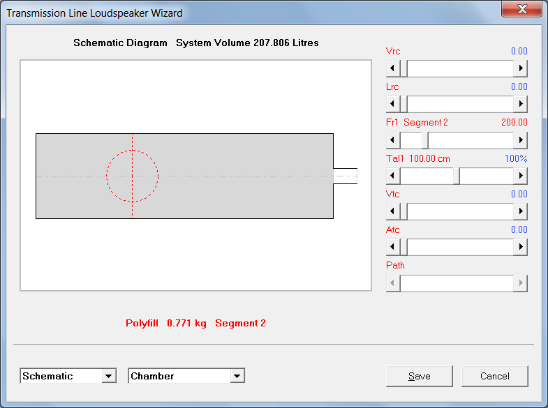

Hi David
I time ago I was busy with a tapped horn and try to solve the cone correction, a lot of people dit try, and and even number of people has not exact solution with damage the woofer, this afcourse in the PA bussiness not for home.
I post some pictures where I have use the vtc and atc, I did measure the cone surface with rise, it give a lower number then with hornresp driver volume calculation sho did 2181 cc and with rise i get 1330 cc.
I have include the baffle, make atc such thet it is like the baffle thickness 1.8 cm and vtc is speaker + baffle cutout.
Now I can make the S1 and S2 smaller so that respons is good, and see that now I have included cone corrections without the possible cone damage and there is no obstruction in the horn throat.
Did I do this the right way? I did see that respons did better then without that correction.
Now I can do this also in the mouth, include there the driver magnet displacement.
On last photo you see that it has quite a high sensitivity, 105 dB 1 watt fire from corner, a little coil do smoothe things out..

Hi Kees,
As indicated in Post #4134, I suspect that there is not much to be gained by trying to include cone correction in your tapped horn simulations. Just specify an appropriate throat chamber taking the driver front volume into account.

Hi david
I have include that, and indeed it do not much, I did use vtc, and make thoat chamber S1 some smaller with setting S2 to automatic.
The change on damage the cone is a lot more dangereus than the little gain I can possible have, some tapped horns with big woofers need more attention.
