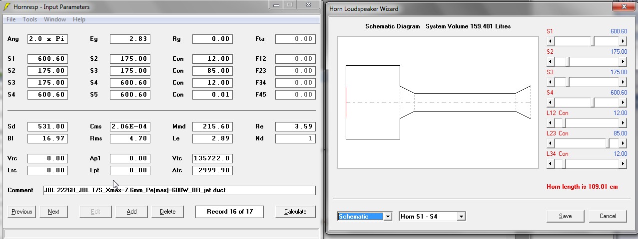

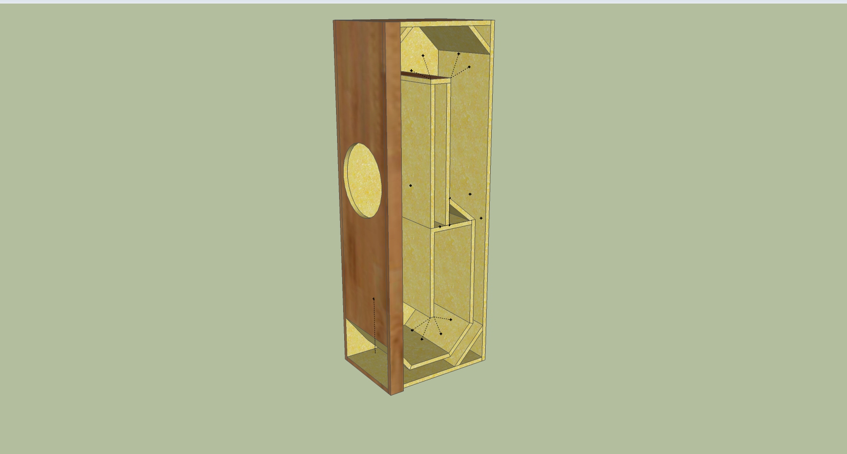

Ive did output hornresp to a box, a ML-TL now see how close this sim is from reality.
I have did double sim, one for box and port and one for a jet port who is now included in first box to reduce noise.

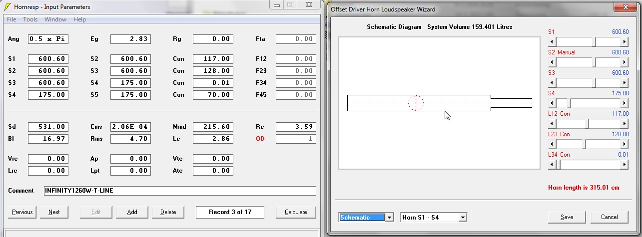

your inputs are very different from what I generally see. But I like the results from this very non-intuitive model.Ive did output hornresp to a box, a ML-TL now see how close this sim is from reality.
How did you arrive at all those dimensions, that give sub 20Hz response, from a line that is just 3m long?
Hi Andrew.
I do sim just with speaker wizard, it is a very nice start and so i come out where I try not to big, the low end is because of the port support I gess, it
is a mass loaded TL..
Alone the port is different, this is a separate simmed jet port, normally it is a straight port, for noise problems I did sim twice different boxes so I get port length of the jet port..
http://www.diyaudio.com/forums/subw...d-transmission-line-od-ml-tl-design-bj-2.html
I do not now what the long pipe does, but for low and not to small port it is needed.
Picture one I did use only vtc to get volume and so I can sim that port, see link why and how.

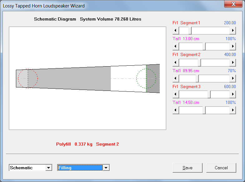

Hornresp Update 3470-140521
Hi Everyone,
CHANGE 1
Absorbent filling material was previously specified in the Loudspeaker Wizard by selecting the Chamber option and then pressing the F9 function key to show or hide the Fr1 and Tal1 slider controls. The required segment was then selected by double-clicking the Fr1 slider.
Filling material is now specified by simply selecting the Filling option - see attachment. Changing a Fr1 or Tal1 slider value with the F5 function key pressed will still set all segments to the same Fr1 and Tal1 values.
CHANGE 2
Several minor bugs and operating anomalies in various parts of the program (none of which affected the accuracy of the results) have now been fixed.

Hi Everyone,
CHANGE 1
CHANGE 2
