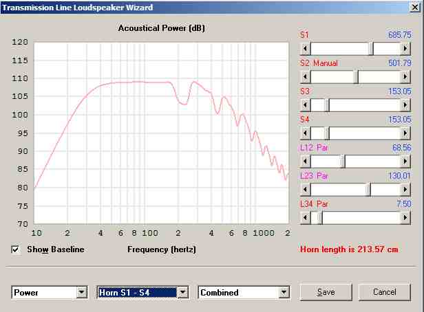

I just ran through a design for a corner subwoofer, and was again amazed at how easy it has become to arrive at a workable first simulation.

Yes, the combination of Loudspeaker Wizard and Filter Wizard has proven to be great.

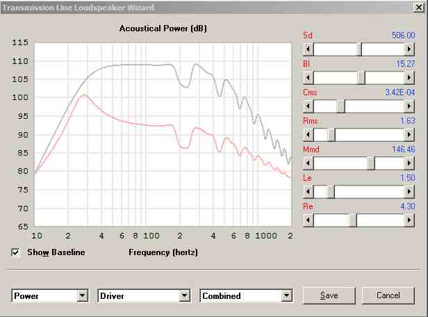

When I switch in the Loudspeaker Wizard / Power the center selection window to Driver, I get an incorrect acoustical power display. Seems to be the only window where this happens.

Excellent - many thanks for this.
The bug has been fixed in the latest release - Version 34.80.

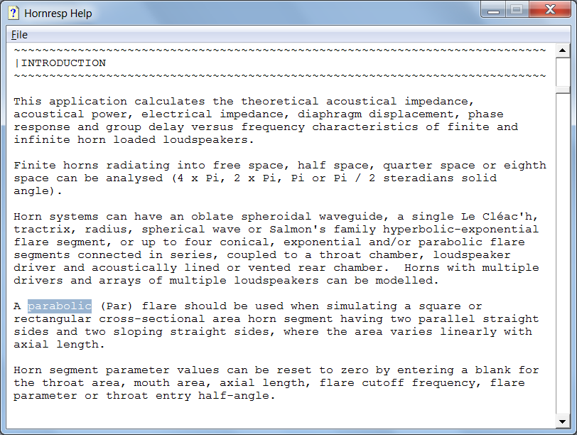

Hornresp Update 3480-140607
Hi Everyone,
CHANGE 1
The following information has been added to the Introduction section of the Help file:
"A parabolic (Par) flare should be used when simulating a square or rectangular cross-sectional area horn segment having two parallel straight sides and two sloping straight sides, where the area varies linearly with axial length."
CHANGE 2

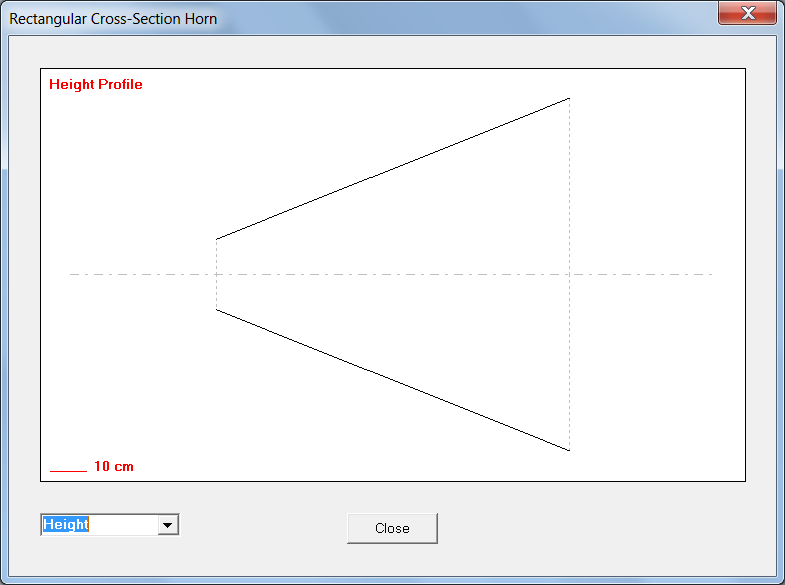

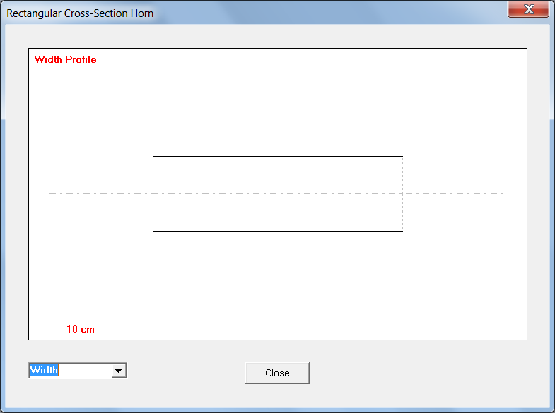

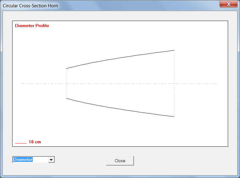

A Preview button has been added to the Export Horn Data tool. This allows the horn width, height and diameter profiles to be checked prior to data being exported. The diameter profile is the same as the main schematic diagram axisymmetric profile. Also, an explanatory note is now shown (in pink) whenever a Con, Exp or Uni width flare option is selected.
The above changes hopefully address the issues raised in the following thread:
http://www.diyaudio.com/forums/subwoofers/256920-par-vs-con-hornresp.html
The bug reported by Oliver in Post #4546 has also been fixed.

I was quite surprised that I hadn't noticed the driver bug myself at some stage during testing - it had been in the Loudspeaker Wizard from the very beginning, and its effect on the results was rather obvious 🙂.
Personally, I am finding the new Preview feature to be very handy. It enables the horn data to be "sanity checked" prior to exporting, rather than having to export the data first, and then plot in Excel or similar to check.
