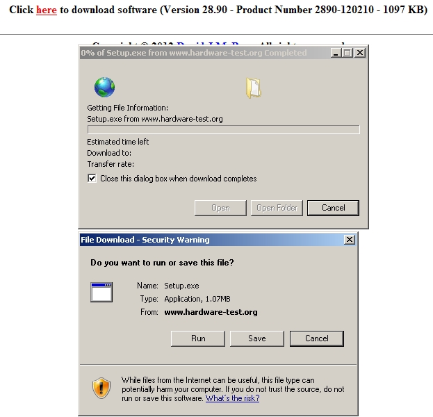

Thank you for your quick reply to my question about where I can get Hornresp.
Tried to download it, but got a warning on my screen that "it could harm my computer". What did I do wrong?
You have not done anything wrong. You can download and install Hornresp with confidence!😉
You can always check the files with your virus scanner before installing.

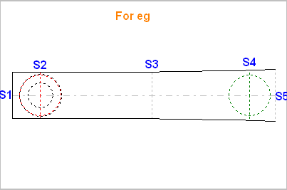

@ David McBean
Hi & thanks for continually improving HR 🙂
I'ld like to suggest a couple of things that, i for one would LOVE to see included.
First of all, being able to see labels for, at least S1 - S5 that followed Instantly with the ongoing design changes, would make it Immediately apparent which sliders were about to correspond with which dimension, & then did in real time.
Also it would be useful to be able to view the Baseline Schematic for comparison. It's great that we can view the Baseline graphs for various parameters, but not unfortunately the Schematic. This could be a toggle on/off as present, & in a different colour to differentiate.
TIA
Hi Zero D,
While I understand the reasons for your suggestions, they would require a lot of work to implement - more than I can justify for the benefit to be gained.
Sorry, its not going to happen 🙂.
Kind regards,
David

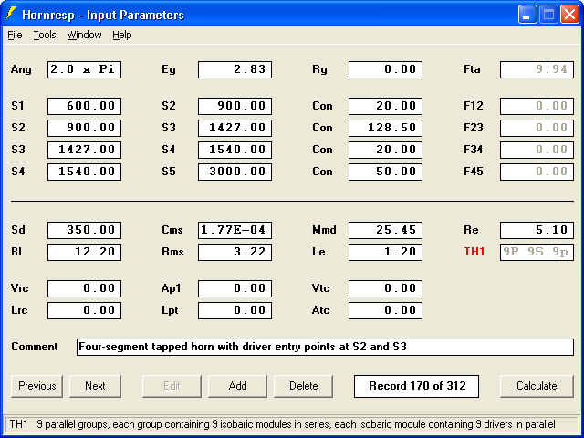

Hi Oliver,
I have come up with a way of permitting up to nine drivers to be specified in a series or parallel isobaric module (even though it is highly unlikely that more than two would ever be needed), while also allowing for multiple isobaric modules to be specified, as you have requested.
The new input parameters window will appear as shown below. The lower case 'p' in '9P 9S 9p' is intentional - it enables Hornresp to identify the configuration of the isobaric module (in this case, 9 drivers connected in parallel).
Because of the amount of work involved, it will take me some time to implement the necessary changes.
Kind regards,
David
@ David McBean
That's a pity 🙁 At least having the Baseline Schematic for comparison would be VERY useful Indeed.
I understand you're busy though, so if you aren't able to do it, or them now, hopefully you will consider doing so at some point, if it's possible that is 🙂

Post #2587
Hi David,
Thank you for keeping on beating on this one. I don't quite get the designation yet, but I'm sure I'll figure it out.
Hi David,

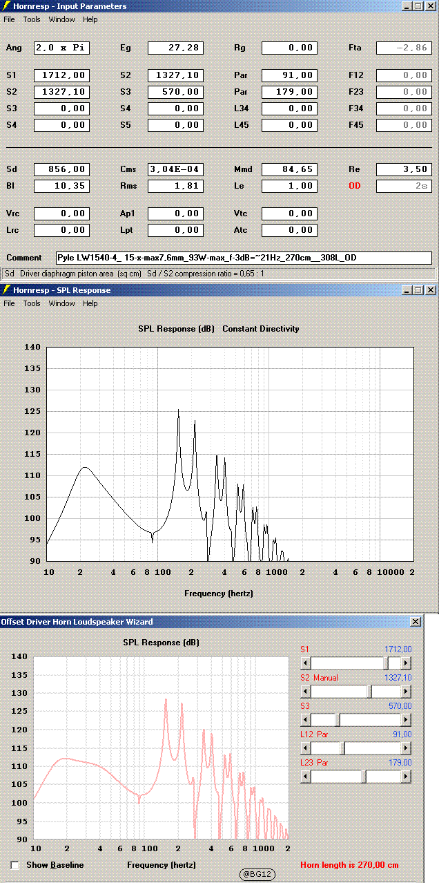

Hi David,
Thank you for the new isobaric configuration features in V 29.00.
When I loaded yesterday's simulation of a single series isobaric OD-TL using two clam-shell Pyle drivers and hit the calculation button the HR program showed a correct picture of the SPL response for the terminus output but when returning to the input screen and when choosing 'Tools'---> 'Loudspeaker Wizard' I got a quite different FR response.
Could it be that the wizard is not updated with the 'iso' info. from the main screen?
b🙂

I just tried the new iso configuration feature as well. Results appear correct for the "calculated SPL response view" but the changes do not appear to have been applied for the wizard. Crossing fingers that David has a chance to fix this soon 🙂

Hi bjorno and mdocod,
Many thanks for reporting the bug in the Loudspeaker Wizard - I simply forgot to change the code 🙂.
The problem will be corrected in an update to be released tomorrow.
Kind regards,
David
Kind regards,
David
