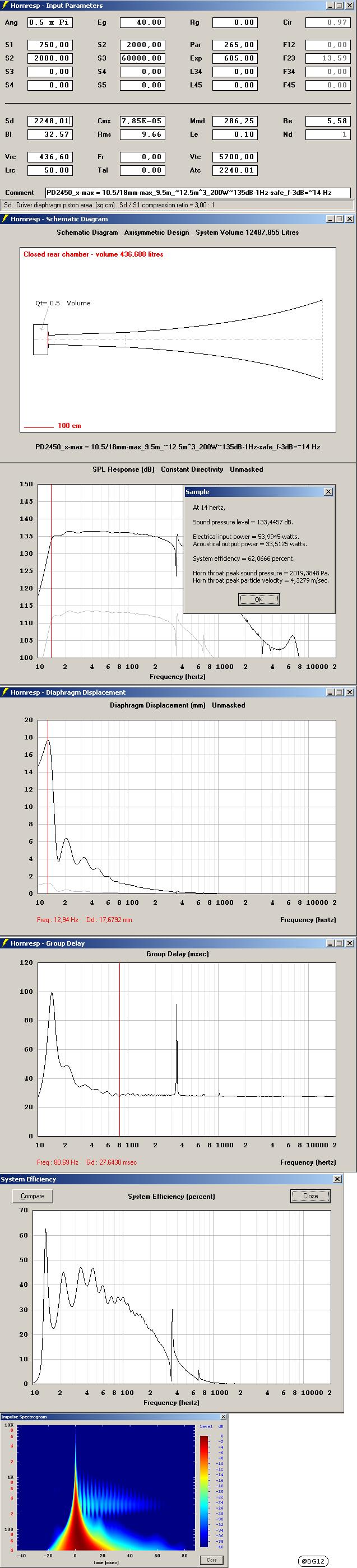

The PD2450 sims well there and is no1 runner for me currently. Need 20Hz to 110Hz

I never designed a large sub horn with an aspect ratio larger than 4:1 so for Your 5:1 design: I hand over this question to whom this is an easy question to answer.

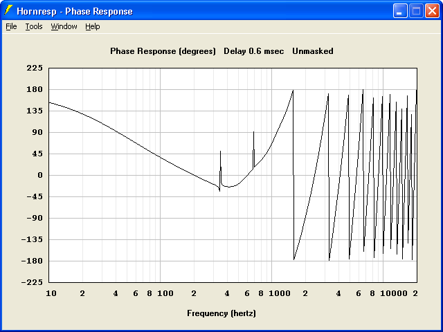

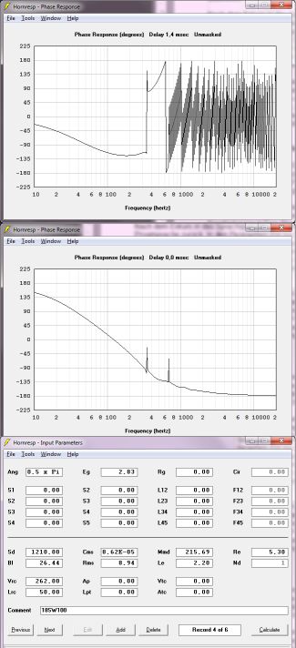

In the attached image you can see two phase plots. The only parameter difference between both is the box volume, in one pic its 262l in the other 261l. Should this happen?
Hi Mathias,
Thanks for the feedback.
The following formula is used in the Hornresp phase un-wrapping algorithm. It was kindly provided by Jean-Michel Le Cléac'h.
PUNW(N) = PHASE(N) + Pi * Round((2.0144 * PUNW(N - 1) - 1.0144 * PUNW(N - 2) - PHASE(N)) / Pi)
On some occasions, particularly when resonances are unmasked, the formula can produce undesired results. This is the case for the examples you have quoted, resulting in a significant difference in the offset delay correction applied to the displayed phase (0.0 msec versus 1.4 msec).
I am not aware of the theoretical basis of the above phase un-wrapping formula - specifically, I don’t know how the multiplying factors 2.0144 and 1.0144 are arrived at.
If 2.0144 is changed to 2.016 however, then the anomaly you have identified can be eliminated, but this may possibly just shift the problem somewhere else.
Using your two examples to illustrate how the phase un-wrapping formula can break down under certain conditions:
EXAMPLE 1 - Vrc = 261 litres
N = 249
Freq = 347.0345 hertz
PHASE(N) = -0.4271 radians
PUNW(N - 1) = -5.0184 radians
PUNW(N - 2) = -4.8949 radians
PUNW(N) = -6.7103 radians
EXAMPLE 2 - Vrc = 262 litres
N = 249
PHASE(N) = -0.4387 radians
PUNW(N - 1) = -5.0181 radians
PUNW(N - 2) = -4.8946 radians
PUNW(N) = -3.5803 radians
Notice how that at 347 hertz the PHASE(N), PUNW(N -1) and PUNW(N - 2) values are quite similar for the two examples quoted (as expected), but that the resulting PUNW(N) unwrapped phase values are quite different. This ultimately means that the corrected phase chart results will also be quite different, as you have observed.
If Jean-Michel happens to read this post, he may care to comment further on the theory behind the phase un-wrapping technique, and if there is anything that can possibly be done to improve it.
Kind regards,
David

Hi Jean-Michel,
Many thanks for your comments, they have helped me to better understand how your phase unwrapping method works.
Just to clarify - Hornresp is currently using -12dB bandwidth limits as included in your latest code, rather than -6dB limits. As a consequence, the upper and lower frequencies are actually the same for the two examples quoted by Mathias.
Imag1 = 100 and Imag2 = 297 in each example (F1 = 41.20 Hz and F2 = 689.46 Hz).
The calculated mean group delay values are not the same because the two examples have different calculated unwrapped phases at the limiting frequencies. As indicated above, the limiting frequencies themselves are the same for each example (F1 = 41.20 Hz and F2 = 689.46 Hz).
Many thanks Jean-Michel.
I tried unwrapping the phase using the following simple technique. It seems to work reasonably well, but in some instances gives different results to those generated by your more sophisticated method.
Offset = 0
For N = 1 To Nfreq
If PHASE(N) - PHASE(N - 1) > Pi Then Offset = Offset + 2 * Pi
PUNW(N) = PHASE(N) - Offset
Next N
