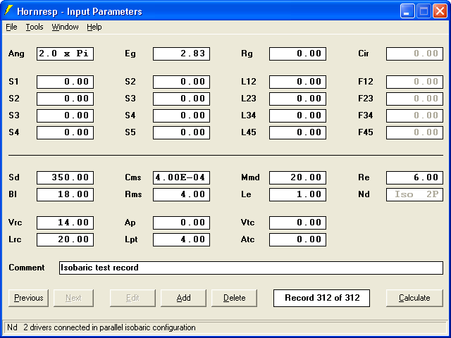

Hi David,
I'll attach a screen print of some notes in a spreadsheet. Using these values seems to work well enough. Please, let me know if you find any big mistakes.
Hi Oliver,
I found no mistakes..but maybe a very small one(I too do sometimes😱) unless you forgot to nullify your Fluke (8060A?) when measure the Re of the drivers using the 200 Ohm scale, of course.

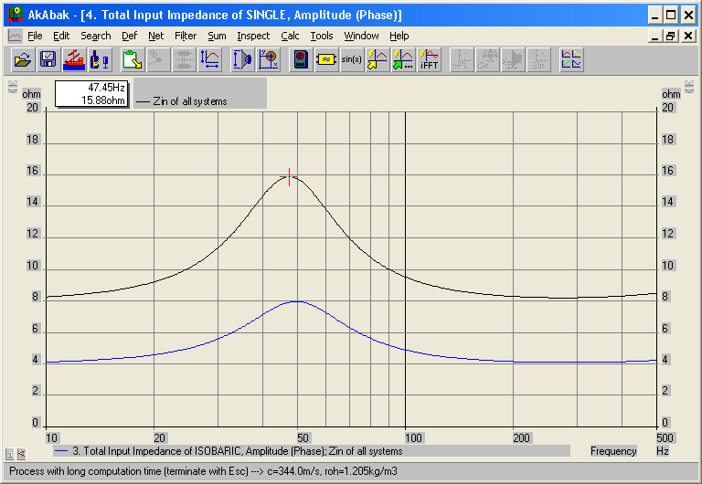

Hi Oliver,
Many thanks for the information - I had suspected that you were probably using this method, but I wanted to be sure. It has been documented in a number of places, and is presumably based on the isobaric model originally described by Marshall Leach in his book "Introduction to Electroacoustics and Audio Amplifier Design". Unfortunately, as far as I can see, he got it wrong, and everyone else has just propagated the error 🙂.
I simply cannot see how fs can stay the same...
fs = 1 / (2 * Pi * (Mms * Cms ) ^ 0.5)
where Mms = Mmd + airload
For an isobaric pair, Cms = Cms / 2 and Mmd = Mmd * 2. For fs to remain the same, the airload mass would also have to double. This does not happen - the airload mass is increased slightly due to the inclusion of the cavity between the two diaphragms, but that is all.
The fs for an isobaric pair will therefore be higher than that for a single driver.
To illustrate, assuming that Cms = 0.0004 metres per newton, Mmd = 0.04 kilogram, front and back airload mass = 0.01 kilogram and isobaric cavity airload mass = 0.001 kilogram, then:
Single driver fs = 1 / ( 2 * Pi * ((0.04 + 0.01) * 0.0004) ^ 0.5) = 35.59 hertz
Isobaric pair fs = 1 / ( 2 * Pi * ((0.08 + 0.01 + 0.001 ) * 0.0002) ^ 0.5) = 37.31 hertz
The fs shift can be readily see in AkAbak using the complete isobaric model - see attached comparison.
Because fs changes, so too will Qes and Qms.
If anyone can see a flaw in my reasoning, could they please let me know.

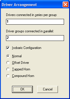

Using the technique I described earlier for Hornresp should lead to more accurate predictions than those obtained with your current method. To make things easier for users, I will probably now add an isobaric configuration option to the Driver Arrangement tool, as you have suggested 🙂.

Whoo Hoooo!Using the technique I described earlier for Hornresp should lead to more accurate predictions than those obtained with your current method. To make things easier for users, I will probably now add an isobaric configuration option to the Driver Arrangement tool, as you have suggested 🙂.

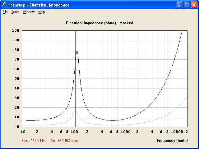

Do the formulas used for multiple speakers in Hornresp also predict a lower FS and a rising QTS?
Hi Art,
Yes. The attached screenprint shows the predicted system fs for four speakers connected in parallel (gray trace), compared to the fs for a single speaker (black trace). Because fs is lower, the system Qts will be higher.
