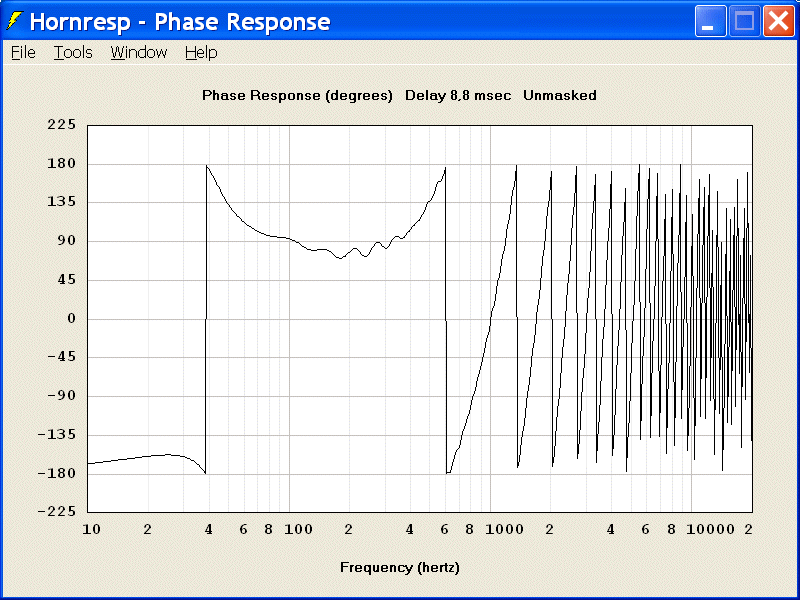

Still the problem of the inverted phase on the phase graph ... (wrap around + and -180° and not around 0°).
Though the calculated impulse response has the correct polarity (could be only a problem with which phase is diplayed: uncrorected or corrected...).

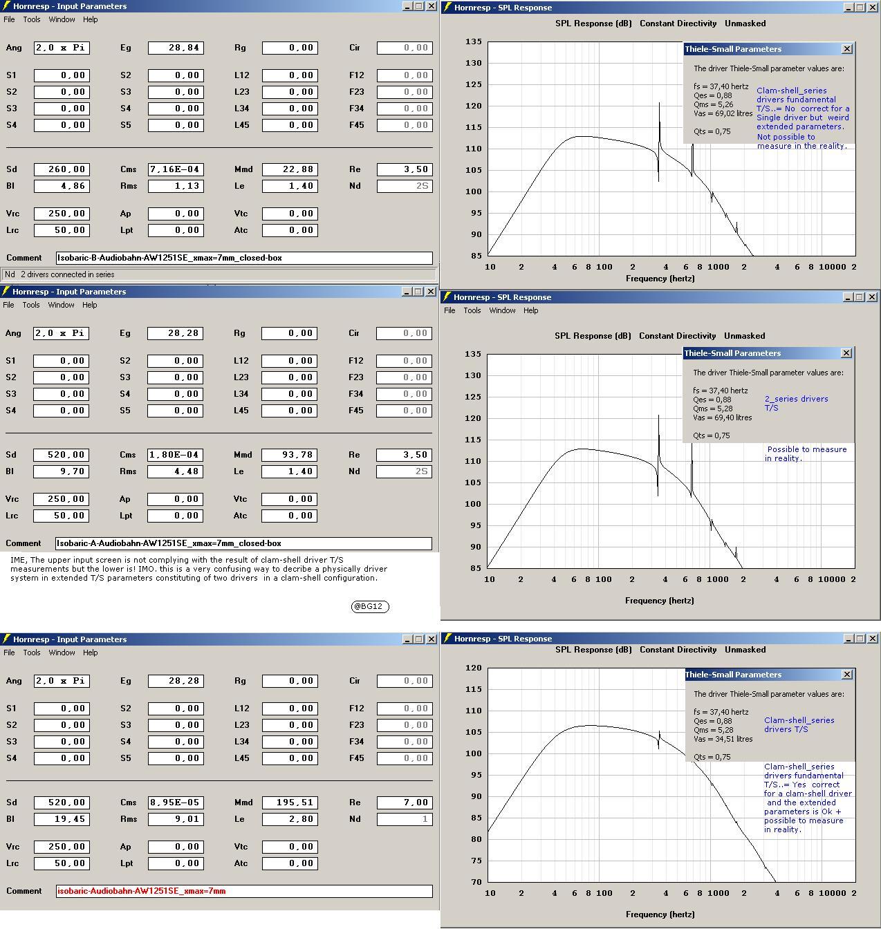

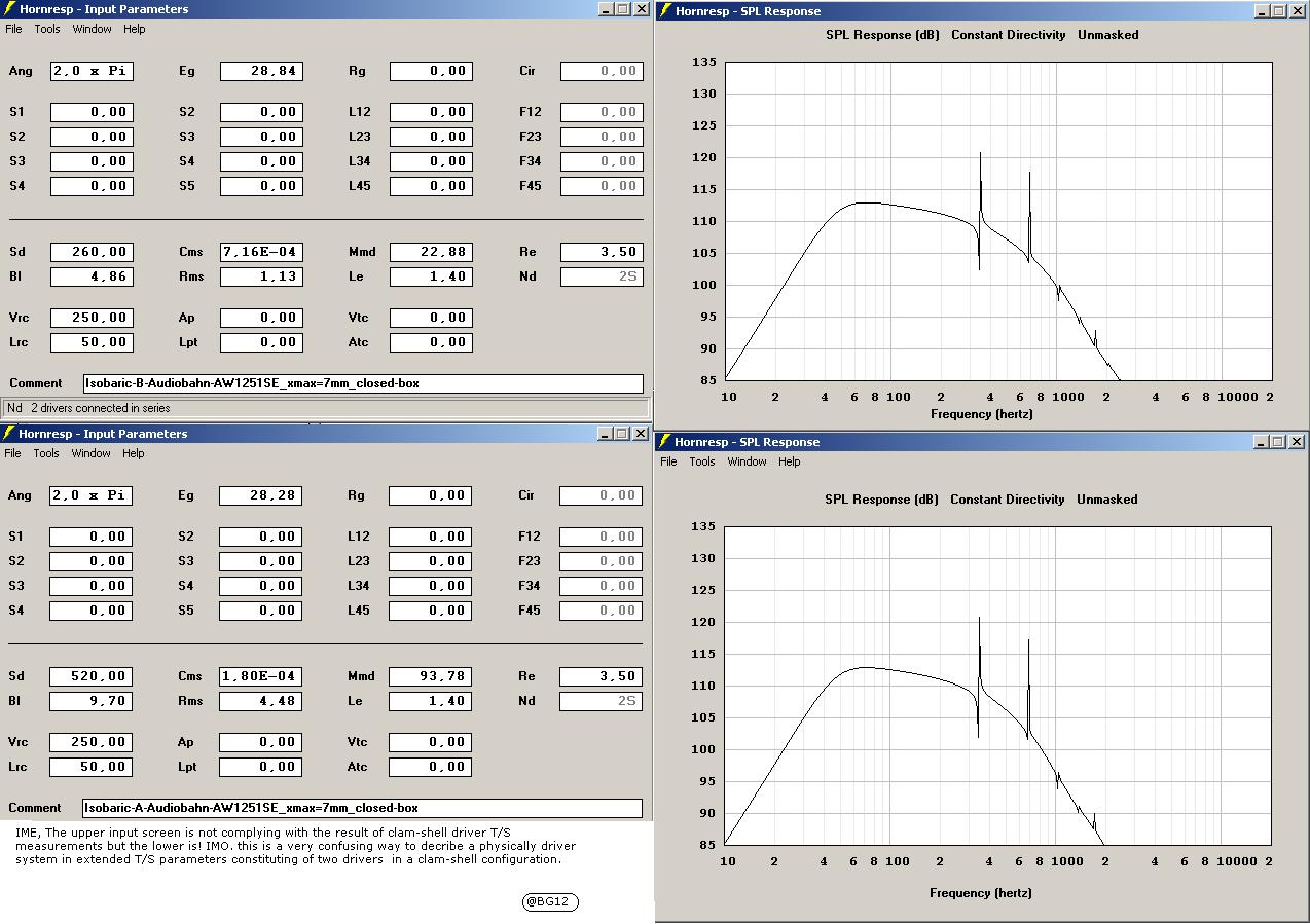

Hi David,..I just had to ask. Thanks for the explanation and the example, one question though: when setting the Sd in your example to 0.5*Sd do I leave all the other parameters as they were with a single driver?
Hi Oliver,
They will change too in a IMO weird way as BL Rms and Mmd will be UN-recognizable if doing a real world measurement.
b 🙂

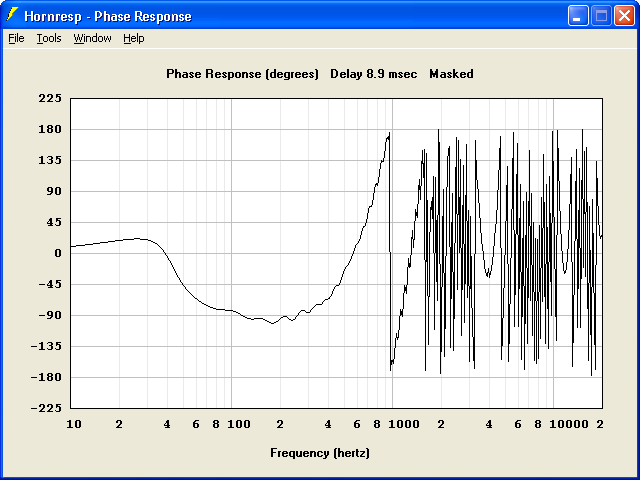

Seems OK to me too.
Thanks Jean-Michel.
I have no idea why my reply to mimura was posted twice, 28 minutes apart 🙂.
I get the phase response shown below - isn't this correct?
It seems to be wrapped around 0 degrees okay.
Kind regards,
David

Hello David,
Your phase graph is correct.
Here is the one I obtained with the new version of Hornresp downloaded few minutes ago.
Attached is the Hornresp record mimura.txt I used.
Best regards from Paris, France
Jean-Michel Le Cléac'h
Hi Jean-Michel,
The reason for the difference in our results is that you are using the 'unmasked resonances' option and I am using the 'masked resonances' option.
I am not sure why this should have such an effect on the phase wrapping process - I need to investigate further 🙂.
Kind regards,
David

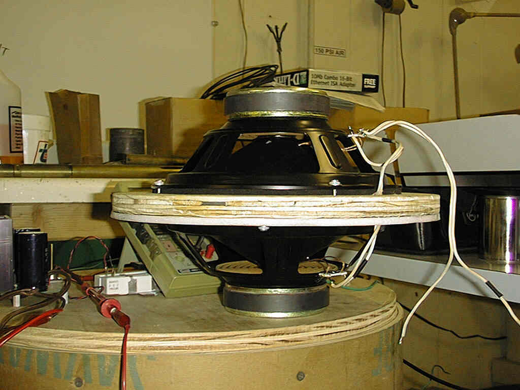

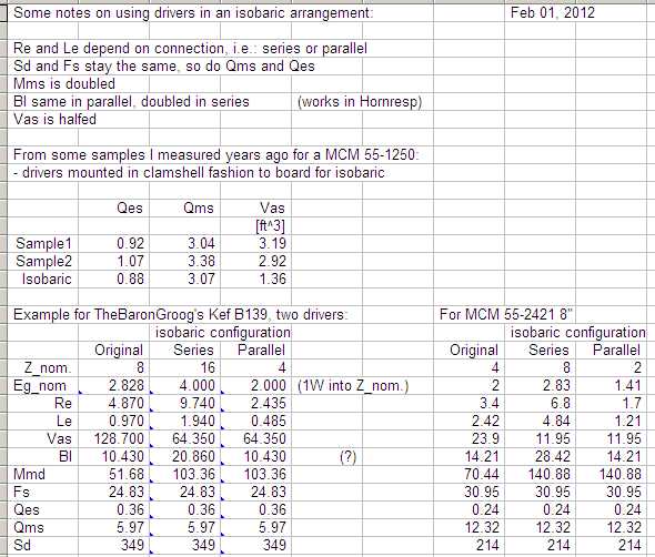

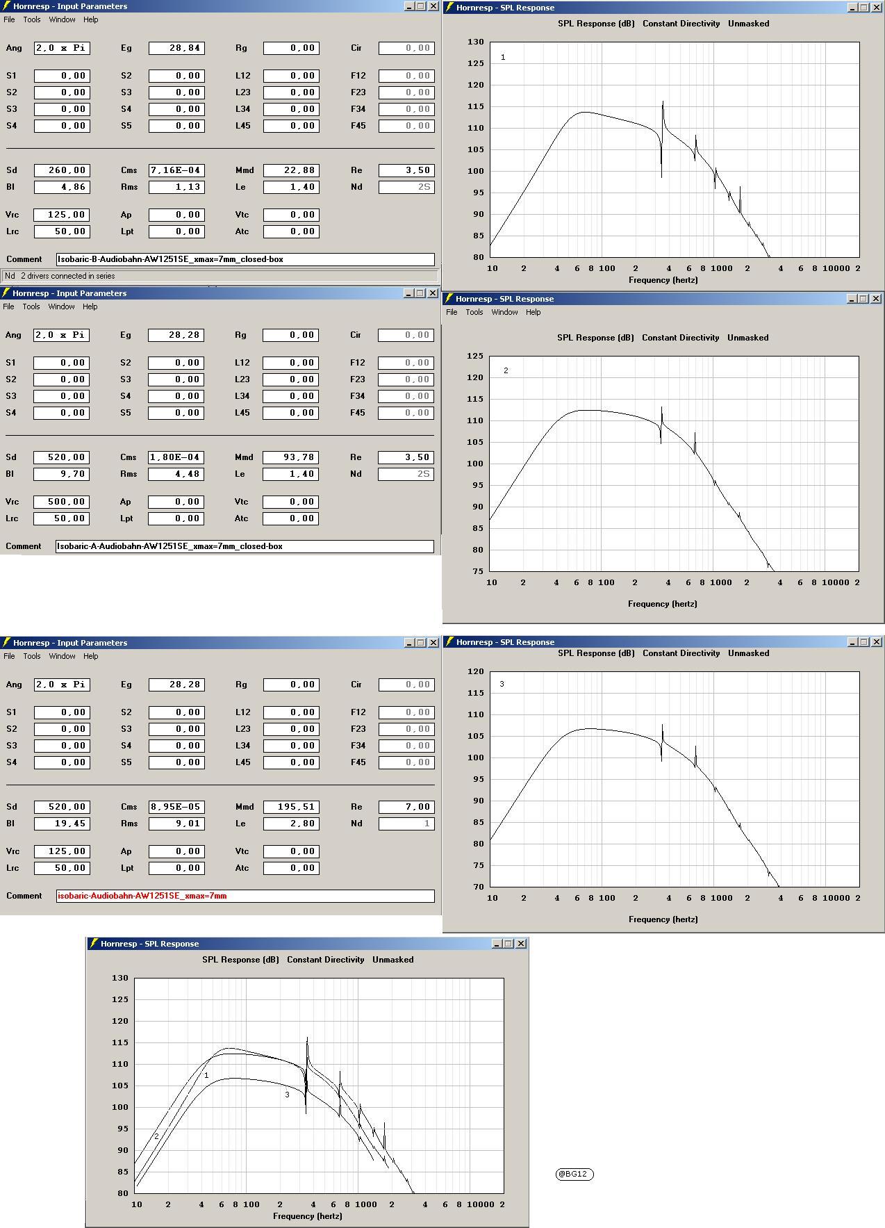

Post #2554 - Isobaric Driver Configuration
Hi David,
I'll attach a screen print of some notes in a spreadsheet. Using these values seems to work well enough. Please, let me know if you find any big mistakes.
Hi bjorno,
I am not sure how to interpret the results you have posted 🙂.
To establish a starting point reference - what are the theoretical parameter values for a single Audiobahn AW1251SE driver?
Thanks.
Kind regards,
David

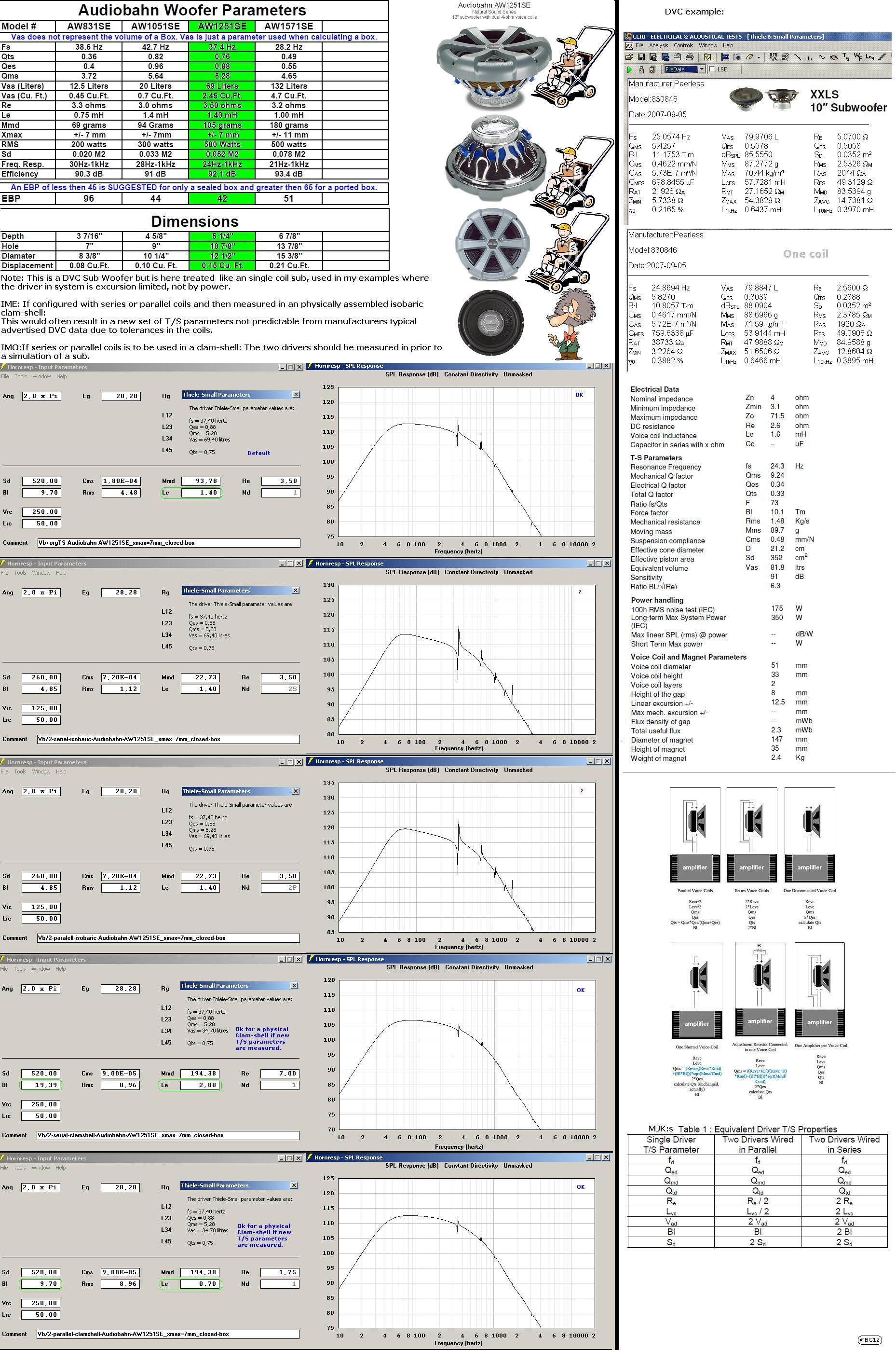

Hi David,
A starting point reference is single coil DVC TS parameters that can be found here: The submitted picture
b🙂
