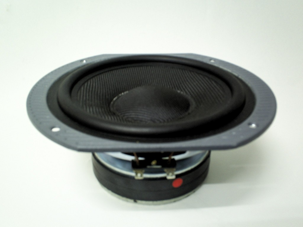

I got decent results with ML-8P150 MID-BASS8"PROFESIONAL (Bl = 13,58 Tm) and also with![]()

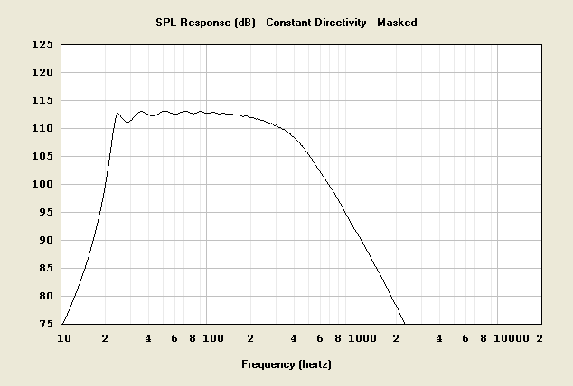

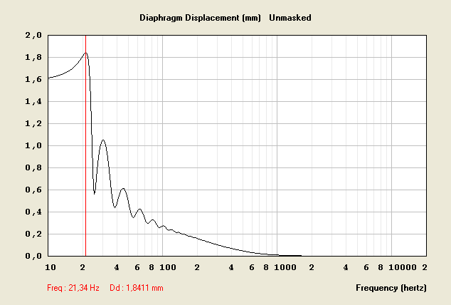

I made my math.
An educated guess (see below) tells me I'd got divorce 🙄 if I pretend more than 70 fon in my house. 70 fon at 25 Hz implies SPL < 90 dB (see fons.gif).

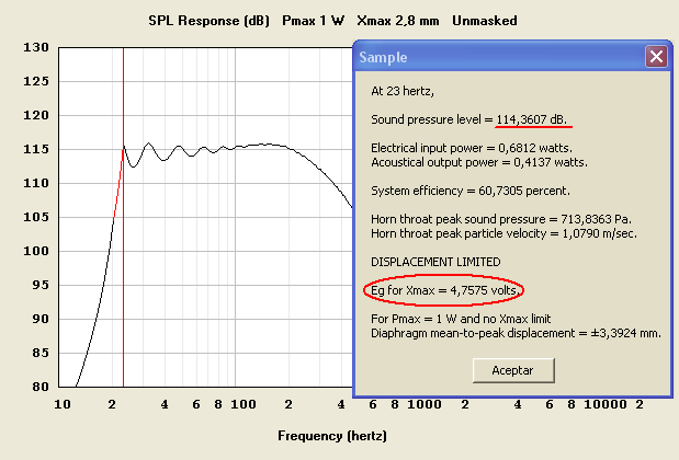

I'm getting more than 110 dB (SPL.png) with Xmax = 1,84 mm (diplacement.png)
Simulating with option SPL maximun @ P=1W =constant frecuency limit is 23Hz (see displacement @ SPL Maximum.png). Go beyond driver limits implies to feed Eg = 4,7575 V to get 114 dB of SPL, but 114 dB of SPL is close to the pain limit!!!.
So, it seems design is more robust than my ear and 54 dB more resistant than my marital status 🙂

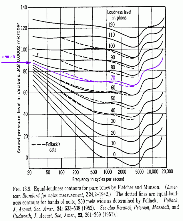

An educated guess on complaints.
From Beranek, Acustics, Fig 13.22 I adopt noise rating D (mild complaints) to E (strong compliants).
From Fig. 13.23 we see maximun SPL @ 20-75 Hz band for D rating is 74 dB and for E is SPL = 77 dB i.e. 50..60 fon. I adopt loudeness = 70 fon

Note that at 100 to 110dB that the phon to spl are nearly equal and nearly constant over the whole audio range from 20Hz to 1000Hz.
If you can achieve a peak 110dB SPL target, then that same target applies to all frequencies <=1kHz.
That 110dB target would allow average listening levels of 80dB to 100dB depending on music type and not clip any signals <110dB
For most well recorded music an average level of 90dB is very loud.
I often listen at average levels around 70dB.

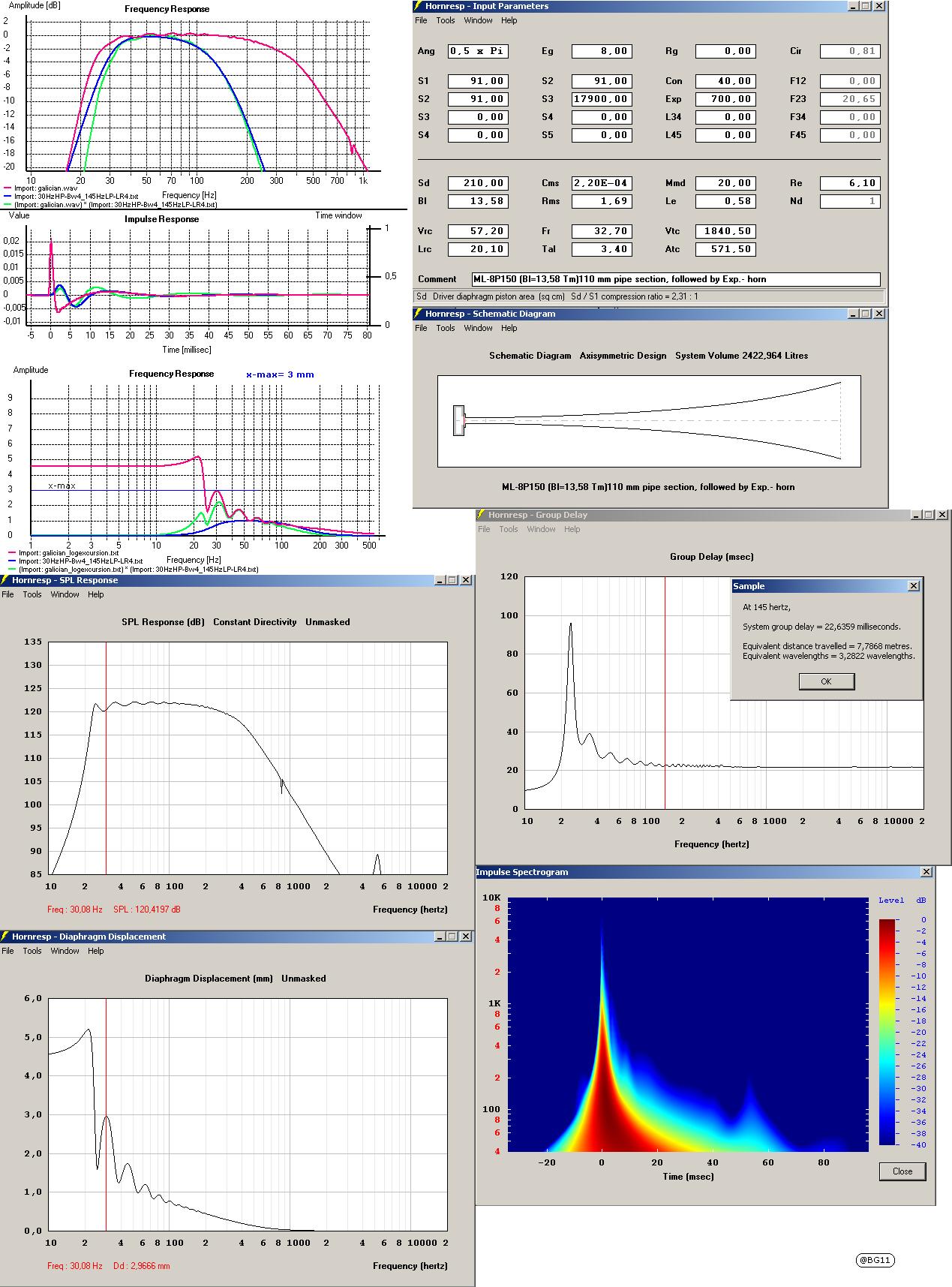

Here's a picture in order to explore your design: I think using adequate (max rec. BW) filters and a ~20 mS signal-delay line is necessary to make your design peak in performance:

Hi, Bjorno
Yes about BP filters. What did you mean with "max rec."?.
I'm absolutely ignorant about delay issue, do you mean I'd lag bass channel 20 ms respect to medium and high frecuency bands?.
Spectrogram: thinking about what information spectrogram gives us my conclusion was: acustic energy at 100Hz decays 25dB 20ms after electrical power input stops. Higher frecuencies damp much before and lower ones doesn´t matter because our ear is not so sensitive. On the other hand I believe my room will have a reberveration time larger, so horn reverberation time wouldn't be an issue.
What do you think?. I have not experience in audio so your warnings and feedbacks are welcome.

Hi amjulio,
First: When your numbers are put into HR it returns a promising sub with good possible performance and that is IMO admirable 'per se'.
With max rec. BW I meant you should restrict the lower FR boundary to ~30 Hz for either of the suggested drivers, possibly even moved a bit lower, for what it's worth, that only if using the recommended Bw4 HPF.
In my simulation: For the upper FR boundary I recommend not to XO higher than 145 Hz for possible localization issues that surely will appear if passed and if using a LR2 filter at 80 Hz would be safe too.
250 Hz is then – 20 dB down when a LR4 or a LR2 filter is used. It is possible to XO as high as 180 Hz if using a brick-wall filter LP slope but then the sub should be centered between the Main Speakers but I do not recommend this approach.
The excess group delay for you sub-horn is ~20 mS that has to be taken into consideration if you want a smooth XO integration with your mains. The cure here is to signal delay your Mains correspondingly otherwise you will hear bass/mid-bass not in sync with the higher registers.
As I can see there are no issues when looking at the wavelet spectrogram, it's almost flawless or a textbook case for a perfect IR.
You're right your room IR (best illustrated in a ETC graph) should dominate by totally masking the sub's IR and adding more than10 times of room amplitude response decay. No worries here..
Concerning the sub-horn dB SPL capability, I find your design capable enough with an IMO healthy SPL margin I wouldn't exceed for esthetically reasons, especially if listening to the kind of ' acoustic' music i prefer.
