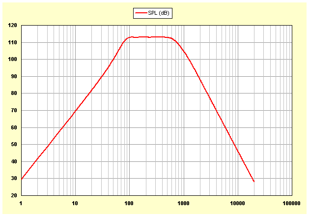

Frequencies below 10 hertz can of course be individually sampled, and the results manually added to the exported chart data for plotting in Excel or similar, if so desired.
To illustrate, the attached chart shows the default record constant directivity SPL response (with chamber resonances masked) plotted down to 1 hertz.

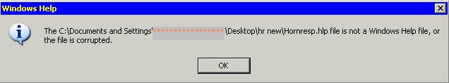

Unfortunately for some reason on trying to run it, i get this error?
Hi Zero D,
Simply select 'Hornresp Help' from the 'Help' menu or press the F1 function key, as for the previous version. Don't attempt to open the Hornresp.hlp file yourself.
As indicated in the Readme.txt file, Hornresp.exe and Hornresp.hlp need to be placed in the same folder.

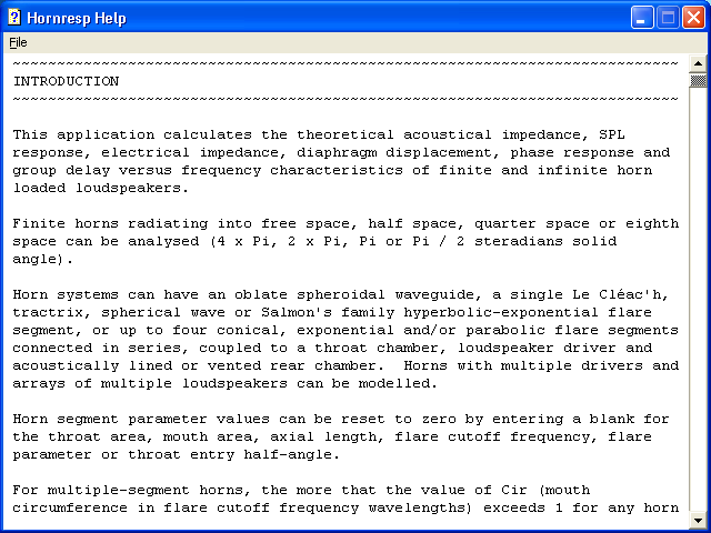

Hornresp Update
Hi Everyone,
A minor cosmetic change has been made to the new Help file. A one-character-wide margin has been added to the left, similar to the one already existing on the right. My thanks to Bjørn for the suggestion (via e-mail). It improves the appearance and readability of the text window quite nicely.

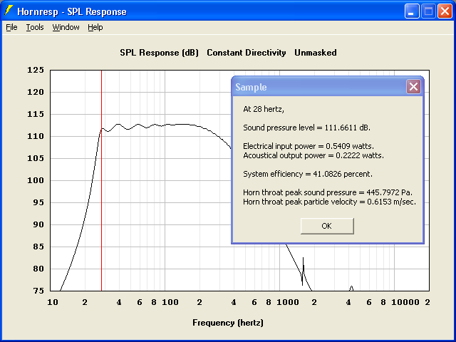

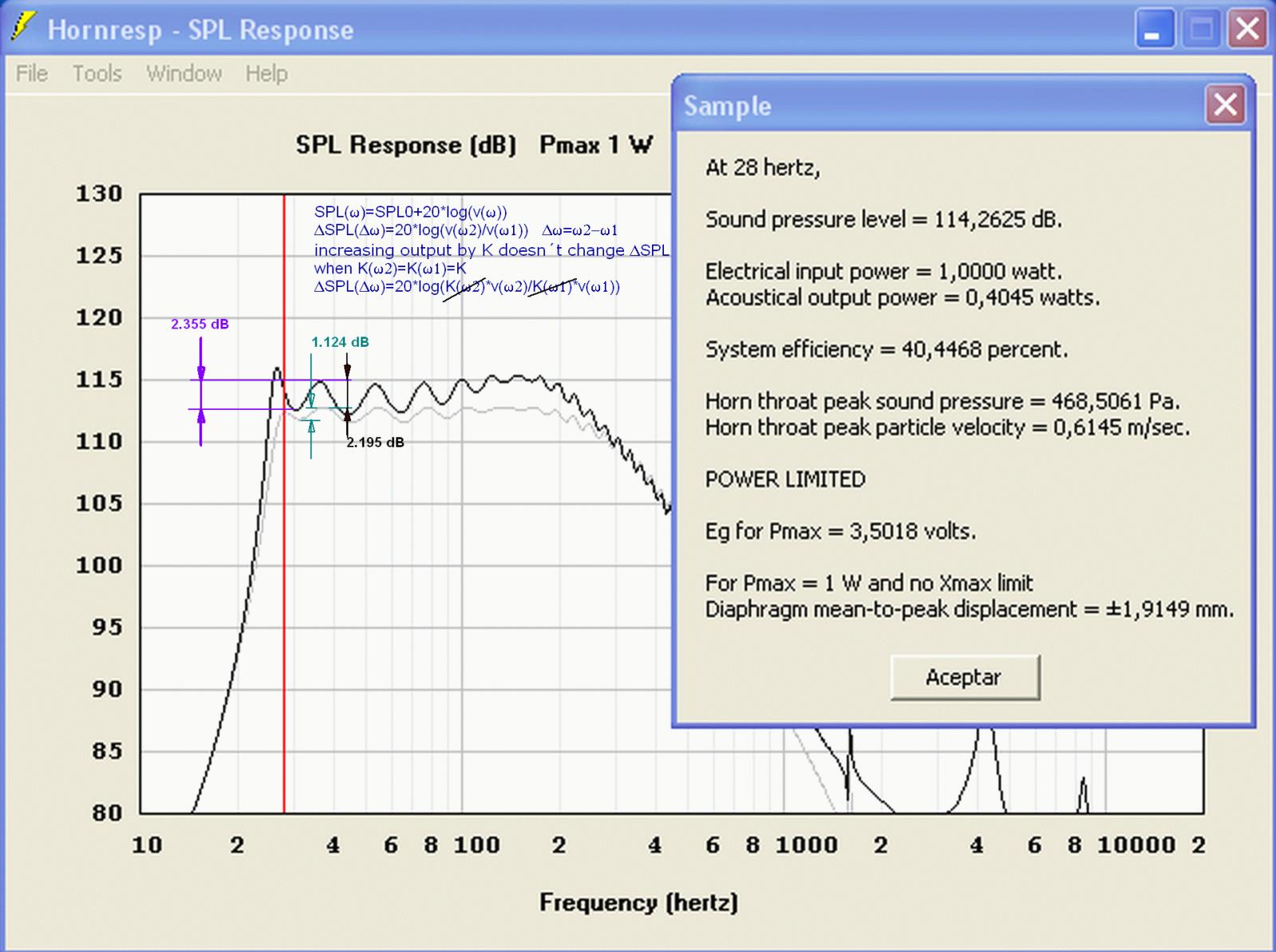

Hornresp artifact or bug?. Some misteries
Xmax= 3mm causes clipping
Hornresp 28.90 (2890-11218) script:
First mistery: frecuency ripple increases.
SPL and ripple increases when SPL Maximum is enabled. However there is no clipping because Xmax = 33 mm. Is this behaviour ok?
Second mistery: displacement increases
No clipping when Xmax = 33mm. Nevertheless displacement increases under SPL Maximum request. WHY?

Hi amjulio,
The SPL and ripple increase when the Maximum SPL tool is used because the acoustical output power is greater.
For the default SPL response at 28 hertz, the electrical input power is 0,5409 watts (Eg = 2,83 volts) and the acoustical output power is 0,2222 watts - see attached screenprint. For the Maximum SPL response at 28 hertz, the electrical input power is 1,0000 watt (Pmax = 1 watt) and the acoustical output power is 0,4108 watts. The system efficiencies in each case are the same (41,0826 percent).
For the same reason as above - the displacement increases when the Maximum SPL tool is used because the electrical input power is greater.
It is important to remember that the default SPL response uses a constant voltage source, whereas the Maximum SPL response (when not displacement limited) uses a constant power source - the results, as you have observed, can be quite different for the two cases.

Hi, David
ripple shouldn´t increase when output power is increased:
I wonder if your last remark explain ripple increment. I think it does because constant output power implies not costant output voltage.It is important to remember that the default SPL response uses a constant voltage source, whereas the Maximum SPL response (when not displacement limited) uses a constant power source - the results, as you have observed, can be quite different for the two cases.
Kind regards,
David
What is SPL Maximun for?. Because normal power amplifiers have constant voltage outputs. So the normal output of Hornresp models better reality I think. Am I wrong?
