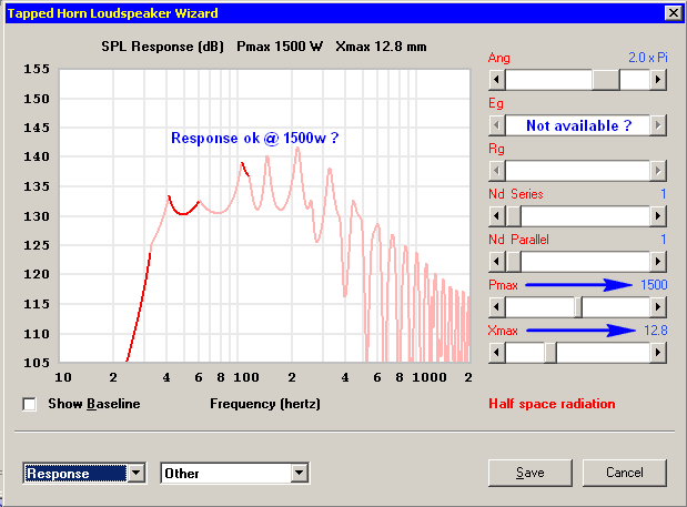

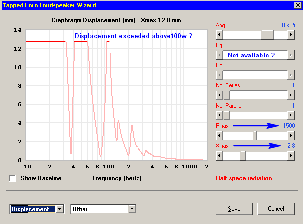

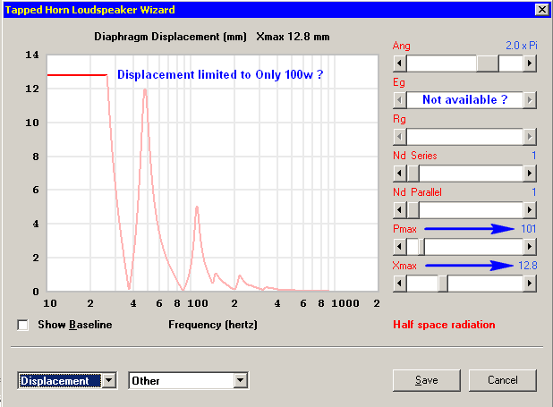

Hi, Re this thread http://www.diyaudio.com/forums/subwoofers/200196-my-first-th-design.html & tb46's TH design he kindly did for me fane_001.txt
I'm hoping you can shed some light on my trying to establish why i "appear" to see conflicting etc data !
For the 1500W tests i set the Input Parameter - Eg = 109 Volts
For the 100W tests i set the Input Parameter - Eg = 28.28 Volts
For some reason Eg isn't available on the slider ?
My main concern though is, why the design "seems" to be Extemely displacement limited. Considering this a 1500W driver with Xmax of 12.75mm !
TIA

Hi Zero D,
Setting Eg to 28.28 volts means that the power delivered to a pure 8 ohm resistive load will be 100 watts. Because the impedance of a nominal 8 ohm loudspeaker varies considerably across its operating frequency range, the actual input power will vary from the nominal 100 watt value, as the frequency changes.
When the Pmax slider is set to 100 watts the input power is maintained at a constant value across the frequency range, independent of changes in speaker impedance. This means that the value of Eg actually changes to keep the power constant. In this case only the input power is of interest, so the Eg slider is automatically disabled when the Pmax slider is activated.
To summarise the above, in the first case a constant voltage source of 28.28 volts is used, whereas in the second case a constant power source of 100 watts is used. This is why the results are different.
Hornresp assumes linear behaviour at all input voltage levels. No allowance is made for low frequency high power amplitude compression, which may be the actual case in practice.
Kind regards,
David

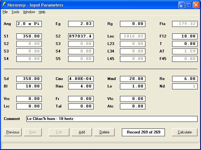

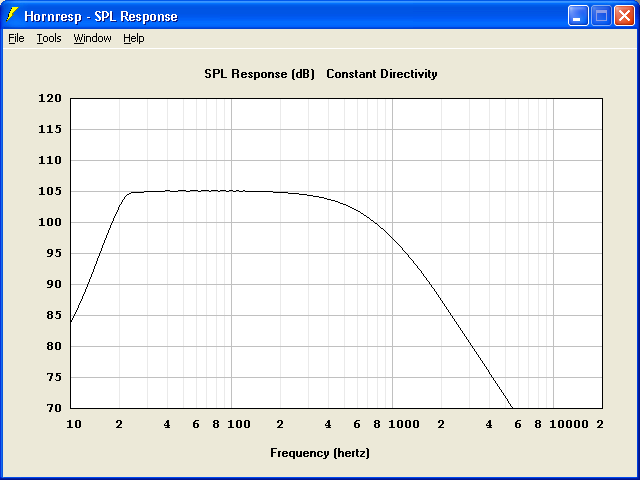

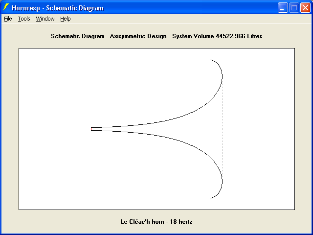

Hornresp Update
Hi Everyone,
The maximum permissible S2 value for a Le Cléac'h horn has been increased to 999999.9 sq cm. This means that a fully-formed 180 degree horn with a cutoff frequency down to 18 hertz can now be simulated (see attached screenprints). Even lower cutoff frequencies can be accommodated if the mouth angle is allowed to be less than 180 degrees - which is probably going to be the case regardless, given that a fully-formed 18Hz horn has a maximum diameter of 10.69 metres 🙂.
While it is still only possible to simulate horns with a maximum mouth angle of 180 degrees, extending the foldback of a practical horn beyond that limit is unlikely to make any audible difference to the radiated sound anyway. Construction data for a 360 degree axisymmetric Le Cléac'h horn can however be obtained if necessary by exporting the "exact profile" from the schematic diagram window.
My thanks to witasso for prompting the initial discussion on this matter, and to Jean-Michel and Mark for helping me to clarify my thinking, particularly in relation to Le Cléac'h horns.

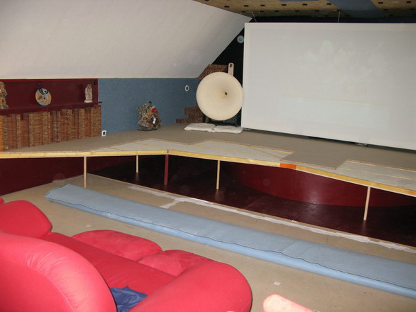

Hello, David,
Thank you a lot for that.
Here attached a picture of a Le Cléac'h bass horn ("stand" type) that my friend Didier is currently finishing to build.
(BTW, the white horn is a 200Hz Le Cléac'h horn)
Best regards from Paris, France
Jean-Michel Le Cléac'h
Hi Jean-Michel,
Thanks for posting the picture - an impressive system indeed.
Your "stand" type configuration is a very elegant way of minimising the overall visual impact of the bass horn.
Kind regards,
David

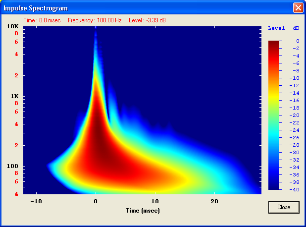

Hi Chucky,
So far so good - what happens though, when you calculate the results for default record number 1, and then select Tools > Impulse > Spectrogram from the SPL Response window? Do you get a fatal error, by any chance? The correct result should look like the attachment below.
Kind regards,
David

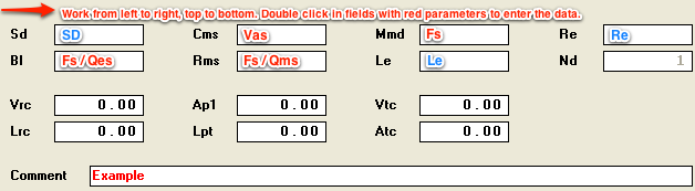

Thanks Neo.
Just to confirm I am reading the input page correctly.
I need
Sd, Vas, Fs, Re, Qes, Qms Le. 7parameters.
When I measure T/S I use added weight to derive Vas. Is that accurate enough?
I do not measure Le.
Any suggestions that give a good enough result for input to Hornresp?
