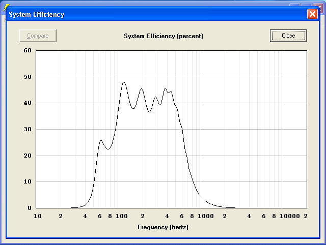

Hi David,
Sorry for the slow reply!
The problem occurs on system efficiency, particle velocity and sound pressure forms.
I've attached an image so you can see what it looks like!
Is the ratio in size difference between the main window and these windows displaying correctly on my system?
Best regards and many thanks for this superb bit of software!
Chucky

Hi Chucky,
Please install a previous version of hornresp and let us know if this is only happening in the current version. If you need a previous release to test with pm me your e-mail address.

Hi Chucky,
Thanks for the additional information. The size of the System Efficiency form relative to the main form should be as shown in the attachment. There is obviously something very strange going on here.
If you like, I can send you a test Hornresp file containing a few changes to see if the situation can be improved. The file would be sent as a zipped-up attachment and be about 390 KB in size.
Please e-mail me if you would like this to be done. My address is dmcbean@bigpond.com
